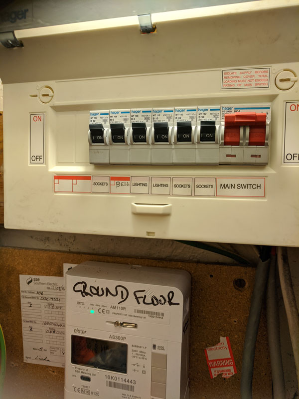

We have been having trouble with some of the sockets (apparent intermittent connection). This sometimes prevents appliances from working (intermittent power) and also appears to be causing issues with the ethernet powerline adapters we are using. I had an electrician take a look and he insisted there was only one faulty socket which he replaced and tested by plugging in some kind of tester. He didn't actually check ALL sockets in the flat. Anyway, the problem has persisted and I know we need to replace other sockets which I believe I can manage myself. However, I wanted to check if there are other issues.
I acquired a Kewtech Loopcheck 107 plug-in socket tester. This has identified sockets with an intermittent fault when you wiggle the plugged in tester. But it also shows other things for all sockets:
Loop test: amber (between 1.8 and 92 ohms)
RCD check: depressing this button for a few seconds should trip the RCD. Nothing happens, but them I discovered on checking the consumer unit that there does not appear to be an RCD (see photo).
Is this anything to be concerned about?
Yes,
The Loop test result should have a result of 1.8 Ohms or LOWER. 92 Ohms is dangerously high, especially as there is no RCD protecting the installation.
That is something else to be concerned with, (1) that there is no RCD and (2) that you were not aware there was no RCD until you tried to test it.
If he left you with the loop test reading greater than 1.8 Ohms then he is not a competent electrician.
There is no RCD in your consumer unit, so it cannot trip!
To consider if the loop test at the sockets is too high, you first need to determine what the earth loop measurement is at the incoming point. You can’t do that with one if those plug in toys.
I’m afraid you need an electrician on site ( not the same one) to sort this out. Of course, if your flat is rented then it’s the landlord’s responsibility.

Multiple sockets suggests problems with the wiring. Very unlikely for multiple sockets to all be defective at the same time, just replacing the sockets is unlikely to fix anything.
Unsafe, the maximum value for your socket circuits is 1.1 ohms.
RCDs have been required for socket outlets since 1991. They are a requirement for almost all circuits now.

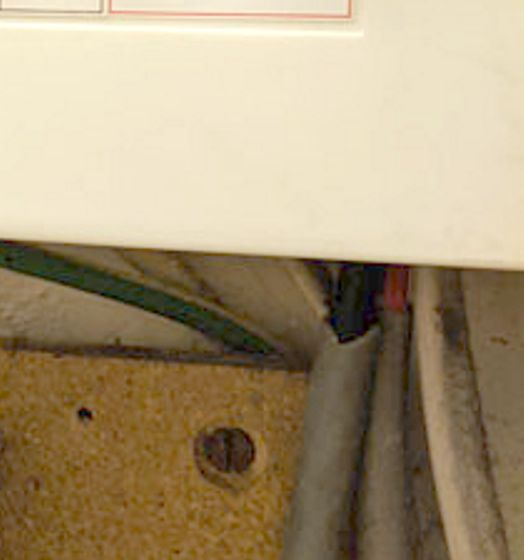

Inner red / black insulation of the supply tails should not be visible outside of the consumer unit:
Suggest you have someone inspect and test the whole installation, as there are multiple problems just from the limited information provided so far.
