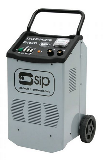

So 110 Ah / 3 amp = 35 hours, that's a long time. Even a charger like this 1699426359738.pngat over £250 still takes time to charge a battery, it may start charging at 42 amp but for such a short time, it only knocks the charge time down to around 24 hours and no one is likely to run a generator for that long.
So you need to find some one who will let you put the battery on charge for a couple of days at least to have any chance of getting it working again, more likely it will take a week or more, and the problem is only way to actually know if fully charged is with a hydrometer. Volt meters tell you very little once it has been allowed to get so sulphated. The longer the sulphur is left on the plate the harder it gets and the longer it takes to remove it.
As an auto electrician I would simply say the battery is useless and you need a new one. I could not afford the time trying to nurse it back into life, it may recover 75% of the time if it was good to start with, but so many were not that good in the first place, for an unknown history with a battery maybe 10% will recover, so not worth trying.

But with out trickle charging it to the fine end, how long should a charger like that take to charge up a 110amp/hr battery to something like 13V?

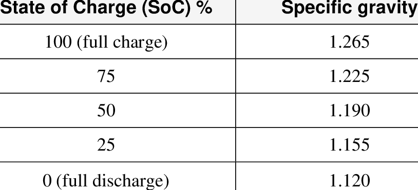

It measures the pacific gravity of the electrolyte which tells one how much acid is in it, 1.26 is normal around fully charged this does vary depending on how hot the country is but assuming measured when battery new and fully charged one then has an idea of how much charge is in the battery. As we started to get sealed batteries the use of the hydrometer reduced as you could not draw the acid into it, and we started to rely on volts instead. But where the sulphur has hardened on the plates over time voltage can give a false reading. It was common to have a chart 1699513654669.png which was used to show state of charge, and also by comparing cells one could see when an equalising charge was required, in the days of the dynamo over time some cell would become high and others low, so once every few months the battery would be over charged with a very low charge rate normally around 1.5 amp called the trickle charger to equalise the cells. But when the alternator arrived on the scene the battery was only really discharged when starting the car, and the need to put a car on trickle charge over night went away. Also the ability to top up the electrolyte also went, however with forklifts with traction batteries this is still done today.
The battery I have is not sealed, you can unscrew the inspection things and see the water inside
What do you do then buy a hydrometer stick it inside of each cell and it tells you haw much percentage of water there is to acid to tell you how much solfur is on the plates and hence how charged it is?
