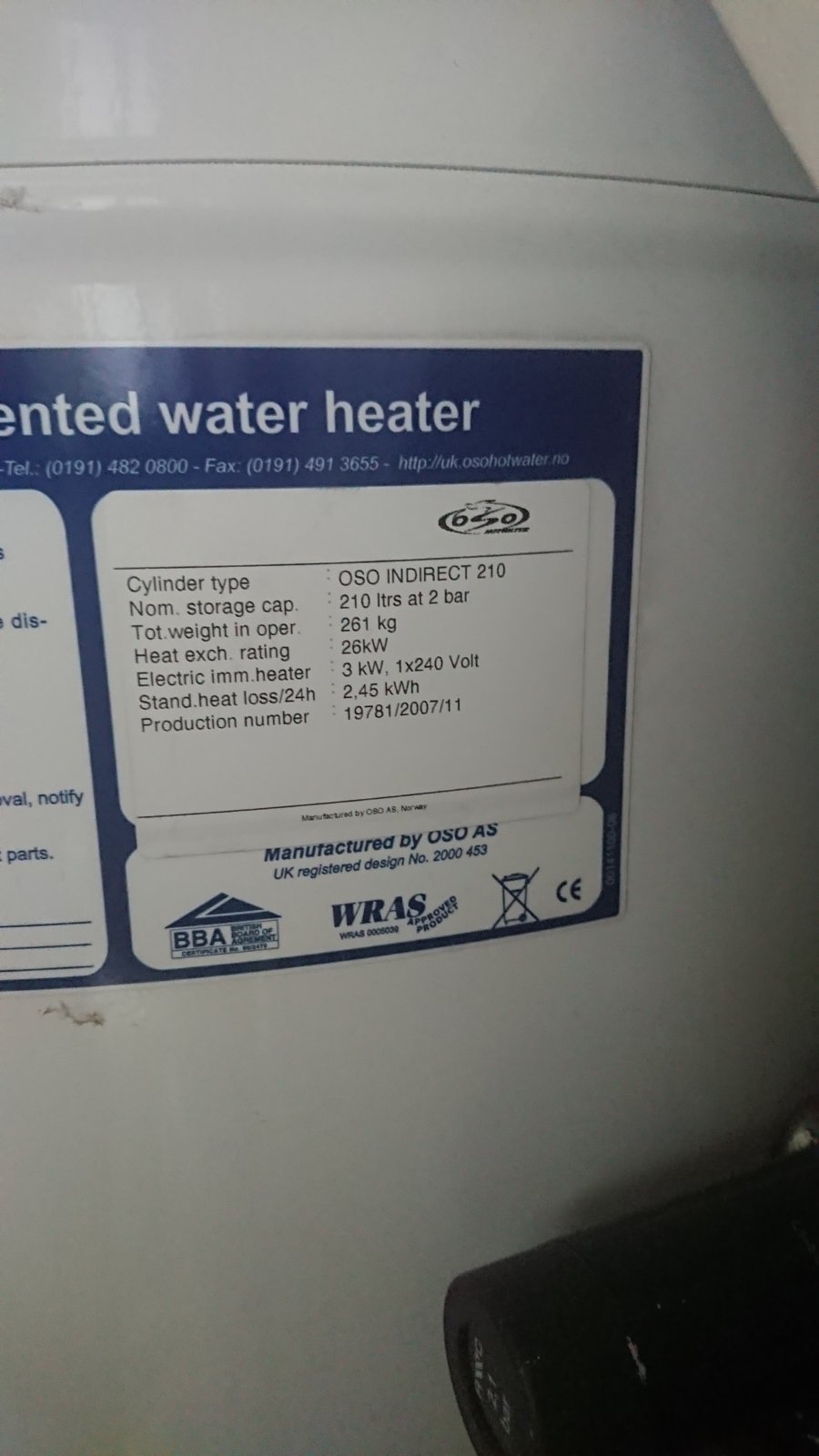

    We have 4.2 kW of panels plus a solaredge inverter and an OSO tank with an iBoost for hot water. We don't use the boiler in summer.
    I suggest getting a twin element tank. That way the solar will heat more water.

    Out of interest, which oso tank do you have

    Thanks for that, have a look at my post and could you please tell me if your controls are the same and how far from the cyl is the iboost.Oh, is it an iboost or iboost+
