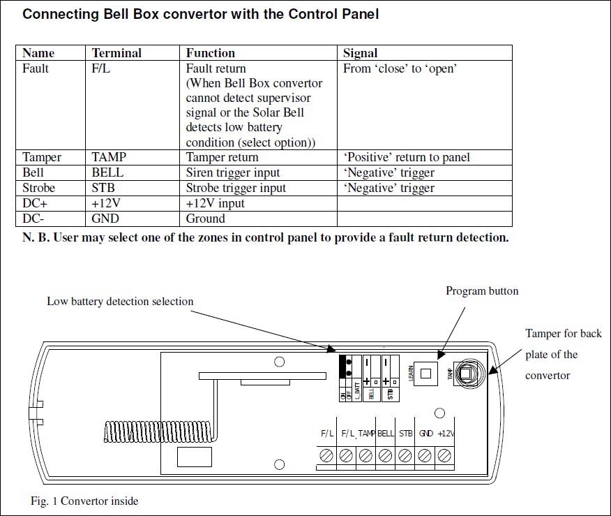

I am trying to install a solar powered bell box (Lynteck LY52-050-43) to my Accenta G4 control panel. Everything is pretty much straightforward except one function.
The bell box converter (the receiver you install next to the control panel) has (in addition to the standard terminals) fault return terminals.
According to the manual, these are used for low battery detection and bell box supervision signal. The manual advises to "select one of the zones in control panel to provide a fault return detection".
My worry is that by doing so, the system will (if armed at the time) go into alarm condition when e.g. a low battery event occurs. Am I mistaken?
Can someone please advise? Many thanks.

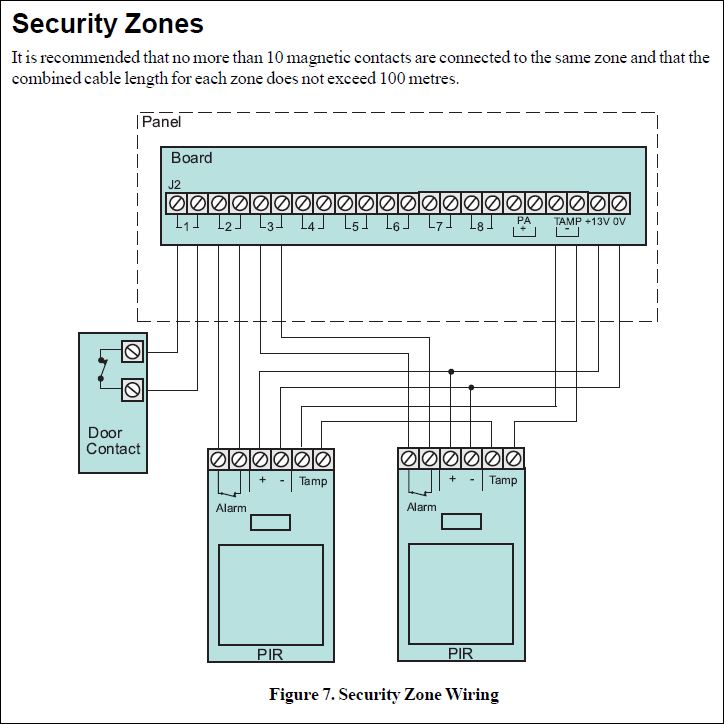

Screenshot of the bell box manual:

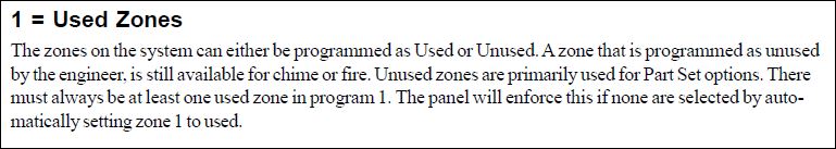

Screenshot of the control panel manual:
Yes .... if you need to use this function ( as the accenta is a bit basic on zone types) wire in a small buzzer via a relay ..
Just had another look at the installation manual - would setting the zone as 'unused' help in this scenario?

If I could still make use of the control panel zone set as unused (instead of wiring in a small buzzer as per your suggestion) to know if a supervision signal has not been received from the bell or the battery is low, that would be my preference.
If the zone is set as unused, would a low battery/supervision event only trigger the chime/low volume internal sounder? Or would this event still trigger a full alarm condition?
