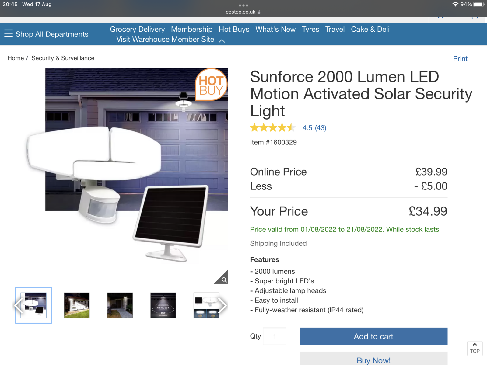

Mainly Chinese imports, some good some very bad , brand makes no difference .Look out for one with extended cable for separate solar panel as it makes it easier to place for sun collection when light is fixed in a shaded spot .Check out the battery spec , replaceable type easier to maintain .

I have installed a whole series of access lights, will not call them security lamps as the don't make anything more or less secure, and as @foxhole has said the one with the remote solar panel seems to have worked better than the rest.
But even that one seems to give up in winter, then start working again when summer comes.
