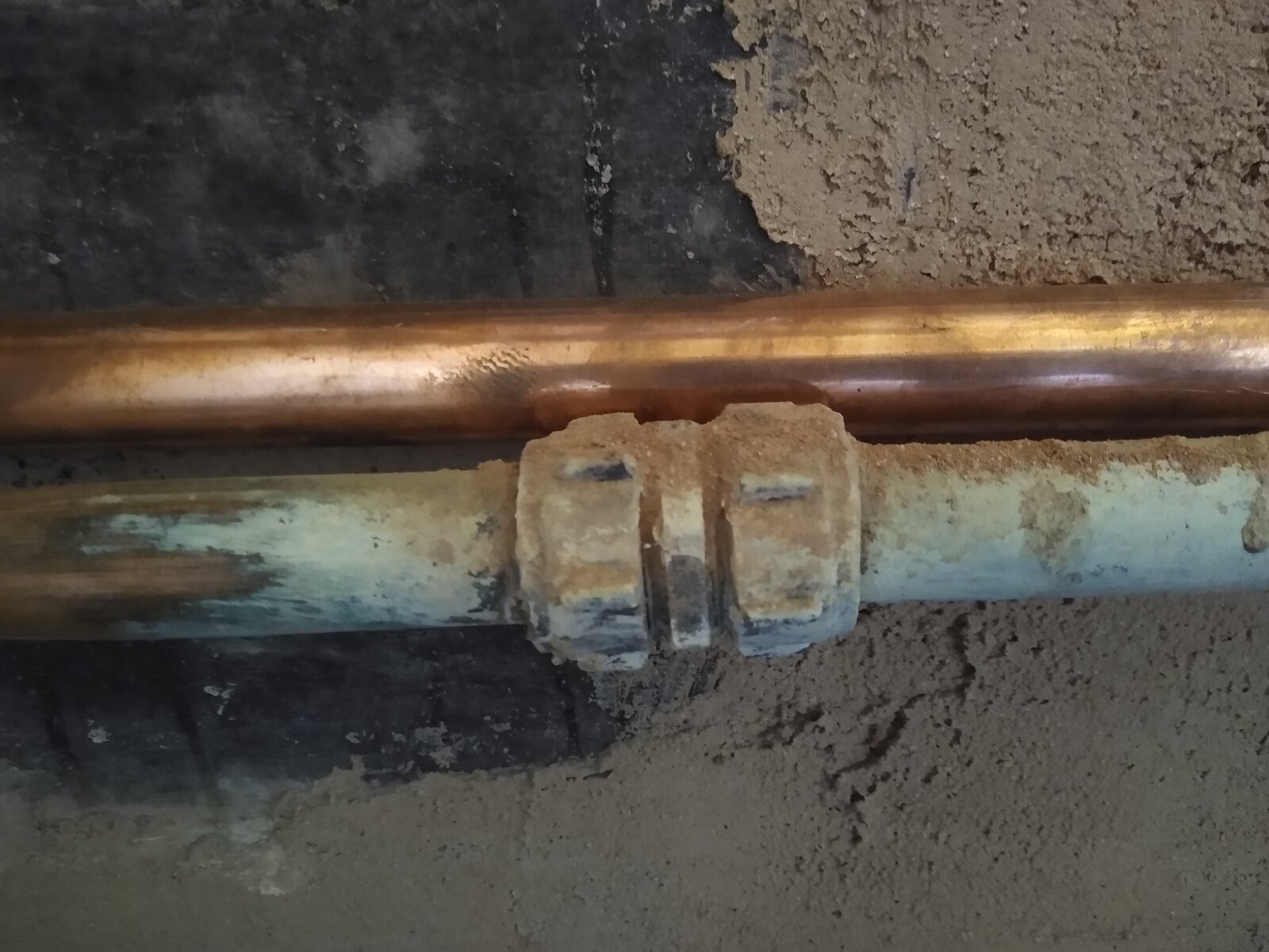

Starting to make sense now. Was wondering why a compression fitting was being used further along the pipe work.
Measured either side of the fitting, one side is 70mm and other is 66, so looks like compression will be the way to go. Unless there are other soldered options?
use compresion, once everything else is sorted you can shut off the supply and do whatever you want , I hate speedfit of any make , but that is me I am a pro and will not use them
