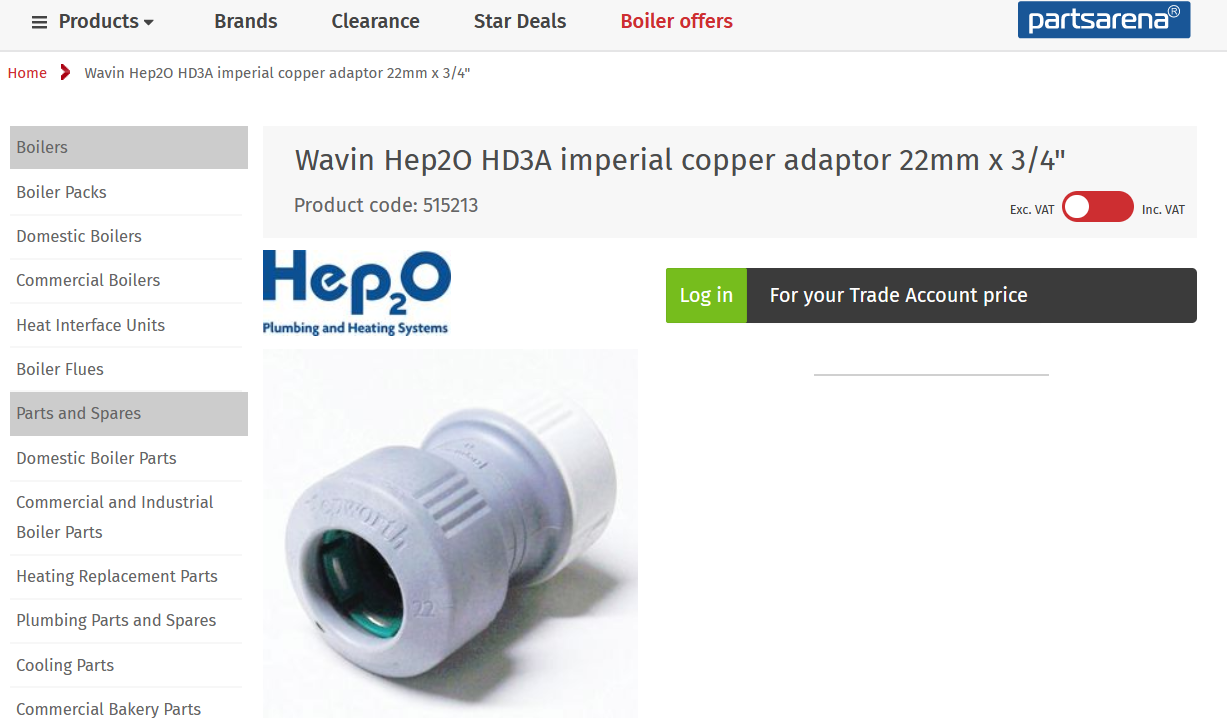

3. Sounds as if you could go the Speedfit route, and perhaps change to soldered when the utility company has got the main stop cock operational. Indeed, if you stick to a good brand like Speedfit or Hep2O, you could leave it.

I would Freeze it, but look at using a Compression fitting rather than Speedfit/Hep2O. Have a 3/4" Olive handy, then in the worst case scenario you can make the joint, as Oldbuffer has mentioned above, if it's 3/4" pipe, the JG/Hep fittings will be useless. You've then got a race against the clock before the ice plug melts.
I would also go for the freeze kit, but, be weary of using a freeze kit in this weather ;)
