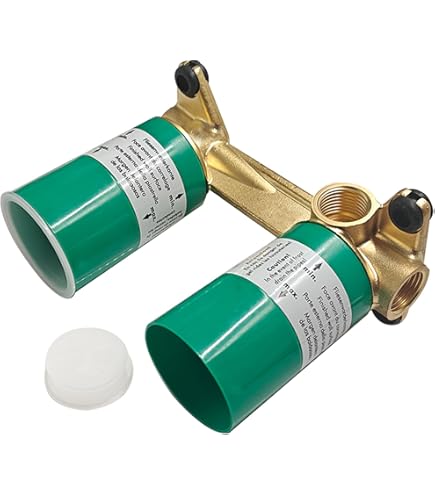

I need to solder a 15mm copper 90 degree bend about 11 to 12cm away from the fitting which contains some plastic materials too. I the soldering fire mat which has been great but for this particular solder I’m more concerned that because it’s relatively close to the fitting that the heat will travel to the housing and potentially mess up some plastics on it. Is there a way to keep that valve body that I don’t want to get hot to stay cool? One suggestion I read is to wrap a wet cloth around it. Not sure if this is the recommended way.

Photo below. I don’t believe the plastic green thing is removable. How wet should the rag be? Or just damp/moist?
If it's only 120mm away then it's touch and go. The rag would need to be soaking wet and that may protect the plastic but in turn it may stop the fitting from getting hot enough for the solder to take properly. I'd remove the whole thing before soldering if possible.
Now I see the picture, yes remove the whole thing.

I managed to solder it. Soaked a rag and wrapped it around. It did get slightly warm even under the rag but not super hot and the plastic seems to have survived
