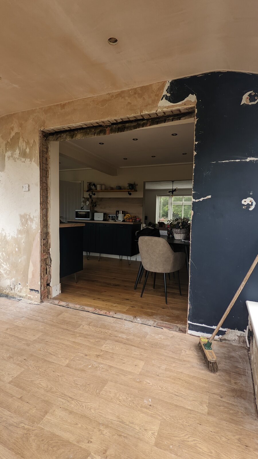

Hey all.
So new here and after some urgent advice.
The external door that was originally between the conservatory and the house did not have a proper frame and has had to be ripped out.
In doing so we have noticed there is no lintel but soldier bricks. Currently these aren't supported as we are awaiting the plasterer to square off the door opening.
My question is can we just fit a new wooden door frame in this opening or do we need a lintel?
Can I have this open for a couple of weeks or does it need supporting urgently?
We have indemnity insurance for this opening the conversatory and another opening as we have only been here 2 months. Is it worth raising?

You need this moving to Building. I've asked the mods to do it for you.
You will also need at least one other photo, further back to give some sort of idea what anyone is looking at.
I would advise exposing the soldier course further to see what is above and how it has been laid? Also, some more detail on the span and loadings would help to give you more accurate advice.
I wouldn't advise relying on a new timber frame to support the soldier course.

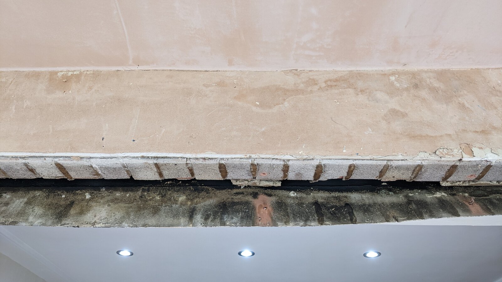

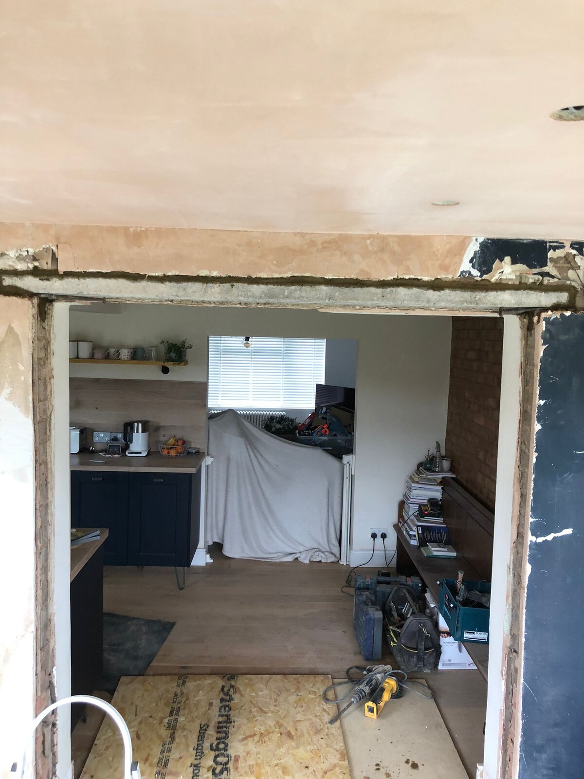

This is the opening and we just don't know what to do about it. The frame supporting it wasn't actually doing anything in the first place as we found out.
Need it sorting urgently to be honest and don't know where to begin.

Easy enough to fit a single leaf steel or concrete lintel in the outer skin. Are you proposing to do.it yourself or get someone in? In the meantime you could hire an acrow or a length of 4x2 timber wedged vertically under the centre of the opening to support it.

hey its only the outer skin of the cavity so not load bearing on the floorboards :)

is it worth just getting an rsj installed as we would rather just leave it all open plan?
Oops yes no problem then, only triangular weight of brickwork above it worry about, keep your hard hat on and try not to walk beneath it.

Got a concrete lintel going in on Saturday. Will it be ok till then?
Ha ha love sarcasm.
The worst that could happen is that a triangle of masonry from above will fall out.
But as you’re telling us the door frame wasn’t even supporting the masonry my guess is that it will be ok.
