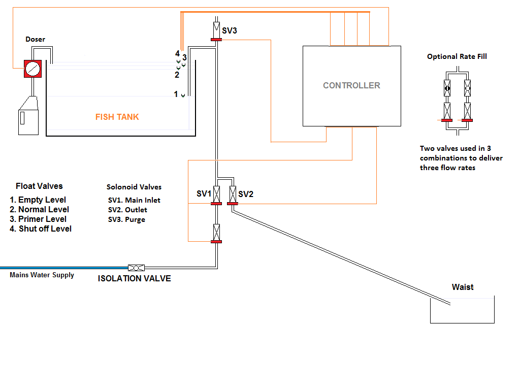

So this is for my fish tank. We have recently moved in to a new rented house, and the tank is now placed within the dining room. In my old house to do a water a change I would run a hose from the kitchen and prime with water from the tap, then move the hose out the back door and let the tank drain to required depth using siphon. Problem with this it was messy and required a certain amount of coordination and moving a water source around while potentially emptying the tank all over the place!
Once the siphon was going I could walk away and do something else until the water level was below the pipe in the tank, and of course everything would automatically stop.
So, new place has a cellar, which will be ideal to drop a pipe in to for water removal, and I am good at electronics, so the attached image is my solution:
*Waist is the drain with the option of storage for garden plant watering...
*Doser is a peristaltic pump to does with dechlorinate
the second unmarked sol valve is there as redundancy.
*Optional fill rate I wont bother with but if I do it would simply be two valves, with two ball valves set at two different flow rates. A combination allows for three fill rates to be achieved.
Out of interest, what would be the best solution for the upper valve to allow me to purge the pipe of water? It is designed to let air in so the pipe can be cleared of water without emptying the tank, but would ideally include a one way valve to prevent water escaping..
Any advice regards the plumbing will be appreciated!
Thanks,
Olly.

Might be less expensive to use a pump to take water from the tank and a standard washing machine solenoid valve to add fresh water to the tank.
What is shown in the diagram could not possibly comply with water regulations, as there is an outlet below the water level of the fish tank connected to the mains water supply.
To make things worse, you are actively encouraging water to be siphoned out of the tank.
In order to comply you need to fill your tank from the top with a clear break between your filling valve spout and the maximum likely water level and the gap should be at least an inch roughly. Filler valve should also be a one way, similar to used on CH for added safety, but it doesn't have to be as in loft water tanks that uses ball float valves. The minimum gap ensures there should be no possibility of syphoning or reverse flow occurring. So you do not use a common pipe for both filling and draining.

May be OP's tank is so huge, that cannot be emptied easily using a few buckets, manually.
To all those who are saying I am overthinking f@ck off and use some imagination! This is the sort of thing I do at work and I also happen to enjoy the challange of projects like :D better than going to the pub or spending my life flaming people on forums lol
yeah it is a big tank and I could do without the hassle and possibility of spilling water on the wooden floor etc etc.
For those who have given me constructive feedback thank you. Yes RS is expensive but at least items are likely to be reliable as you say.
