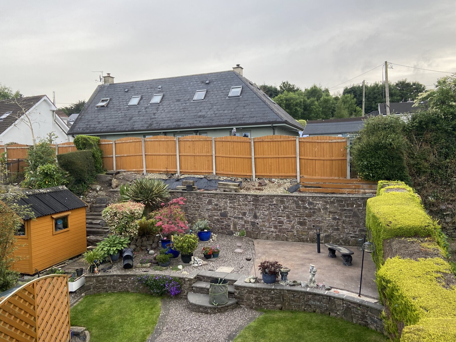

Some advice with regards a retaining dry stone wall

Understand that it will take up space but firstly I have to prevent the existing wall from collapsing
I can’t afford €20,000 and I can assure you that there will be other costs as other parts of the garden be affected by construction
Having said that I need something that will work - in your opinion will the gabion idea work?
What would you do?

So you have a civil engineer ( qualified??) who tells you the solutions and you come back asking unqualified perps what they think. ???? All depends on type of soil to be retained, clay,sand, something inbetween, water table at back of wall, any loading on ground at back of wall, bearing capacity of ground beneath wall foundations ( if it has any ), size and construction of foundations. What about a sheet piled or crib wall?

Sorry mate I am just asking for advice
The soil behind is a mix of clay and rocks/ rubble from an old ditch if you look at the original pics
A house was build on site of a derelict cottage a number of years before it sits about 30-35 feet back on its property.
The wall foundations are not deep or wide I am guessing
Not sure what you are meaning when you say crib wall
Another factor not mentioned, if another house is near on the other side of that wall, do its foundations collapse too, if the wall gives way...
The house behind is about twenty - twenty five feet away I will take a photo to indicate

Someone mentioned that if it did collapse and affected the house behind then we may be liable
