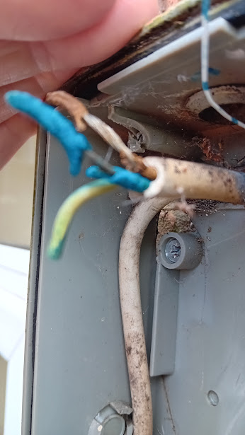

An elderly neighbour chatted with my immediate neighbour on the bus yesterday including the problem with an outside light.
The initial story as I heard it 2nd hand / As I heard it 1st hand
The light stopped working so she called an electrician from a local booklet we get through the door.
He came out and fixed it. £65
When it rained the power fused.
Electrician came out again and mended the fusebox, took the cover off the CU and did something, £65
Electrician came out again and mended it again, took the cover off the CU again
Neighbour told her I'm good at electrics.
I do know the lady, we will briefly pass the time of day while passing, She has had a hard time recently, lost her husband the day before 60th wedding anniversary a week before first lockdown, lost a daughter and grandson due to covid, lost a son to cancer last summer and another in a car crash in the winter, she had a stroke some years ago so is somewhat less mobile, I don't know her age but I heard the story of her evacuation to the country and didn't want to return to East London after the war so well into her 80's
When it rained the yesterday morning the power went for 3rd time
Called electrician, he told her there is nothing wrong and to flick the RCD up
She knocked on the door and asked for help as the RCD wouldn't stay up. By that time the rain had stopped and the sun was out. Turning off the lighting MCB the RCD held.
Sunray (for Motties benefit) I looked at the bulkhead light, the bulkhead whos clear plastic cover is dark brown, removed the cover to find what looks like a brand new 100W bulb (and a bulb in the recycling bin immediately below) and started stripping it before I thought to take pics:
Hole in the back of the fitting and gaping hole for cable access.
rotted heat resistant flex for the PIR, green yellow as perm live
rotted heat resistant flex for light
Basically charged £130 to change a bulb and presumably disturbed something so the water got in.

I replaced the fitting with a bulkhead I had 'in stock' - when panel building I had a set of 6 of them to do initial functional testing in the workshop which are now redundant so keen to find a use for them - the label on those states 100W wall mounted, 60W ceiling mounted. The bulb in the bin was also 100W and probably why the lens had gone so brown. It only gets direct sun for a very short period first thing in the morning in the summer.
My big question with the whole thing is why didn't he mention the condition of the fitting and wiring and charge her to replace it
