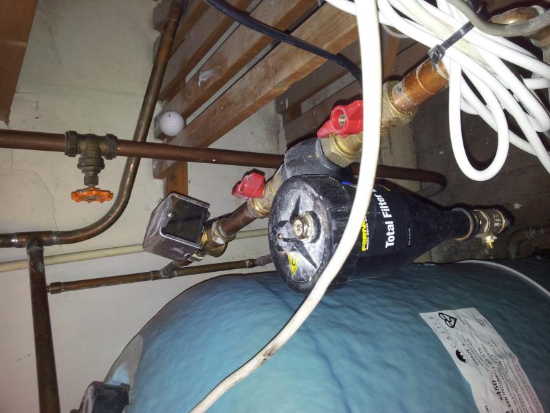

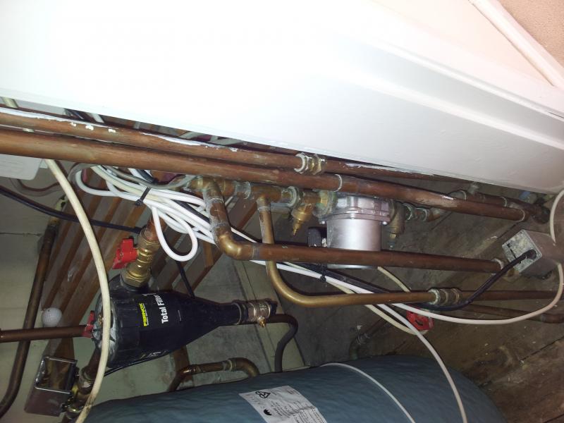

Ive attached a couple of images of some pipework in the airing cupboard for a job ive just been asked about. Basically she had a boiler installed last december and shes had loads of problems, banging noises from boiler etc etc....
basically i think she has been ripped off. told she needed new rads, new cylinder new pump, motorised valves etc...
the woman seems confused and also scared of tradesman, which u can understand, i darent show u the electrics.
ive had a quick look but why would the water be venting out as its before the pump and the cold feed? 2nd pipe in from the right
Many Thanks
What a horrible mess. I would be looking at the area round the tees where the cold feed and vent are connected just under the pump. I would suspect blockages in that area. Reconfigure the pipework by moving the feed and vent and pump position. The connections are correct but low down like that is not how I would do it.
The filter is only on the hot water circuit so what good is that? It needs to be on the return to the boiler or at least just after the pump before any motorised valve.
Thanks.
Shsll I cut thrm tees out then and start again? Why wud it go up vent pipr if blockef though? Flows through heating and cylinder ok? Return off cylinder is 15m
A gas man has put all this in!
That filter will be doing bugger all and reckon he just thought fuk it to much hassle to do it right she eill pay and never no
