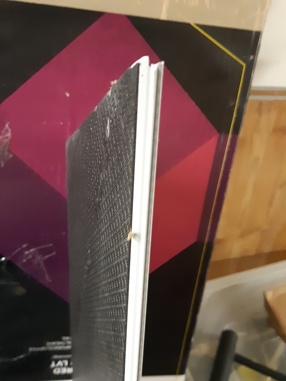

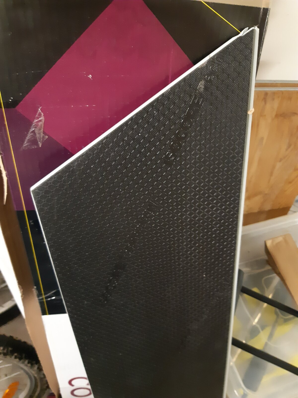

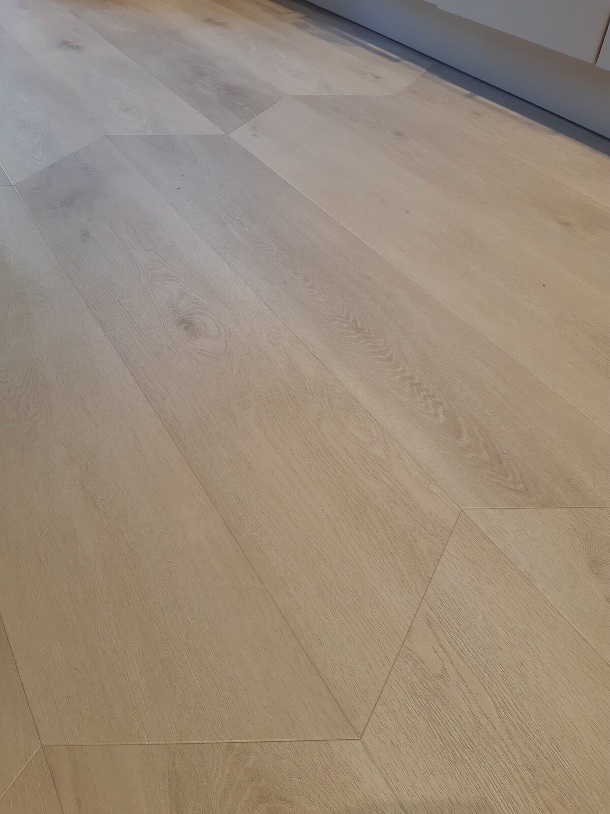

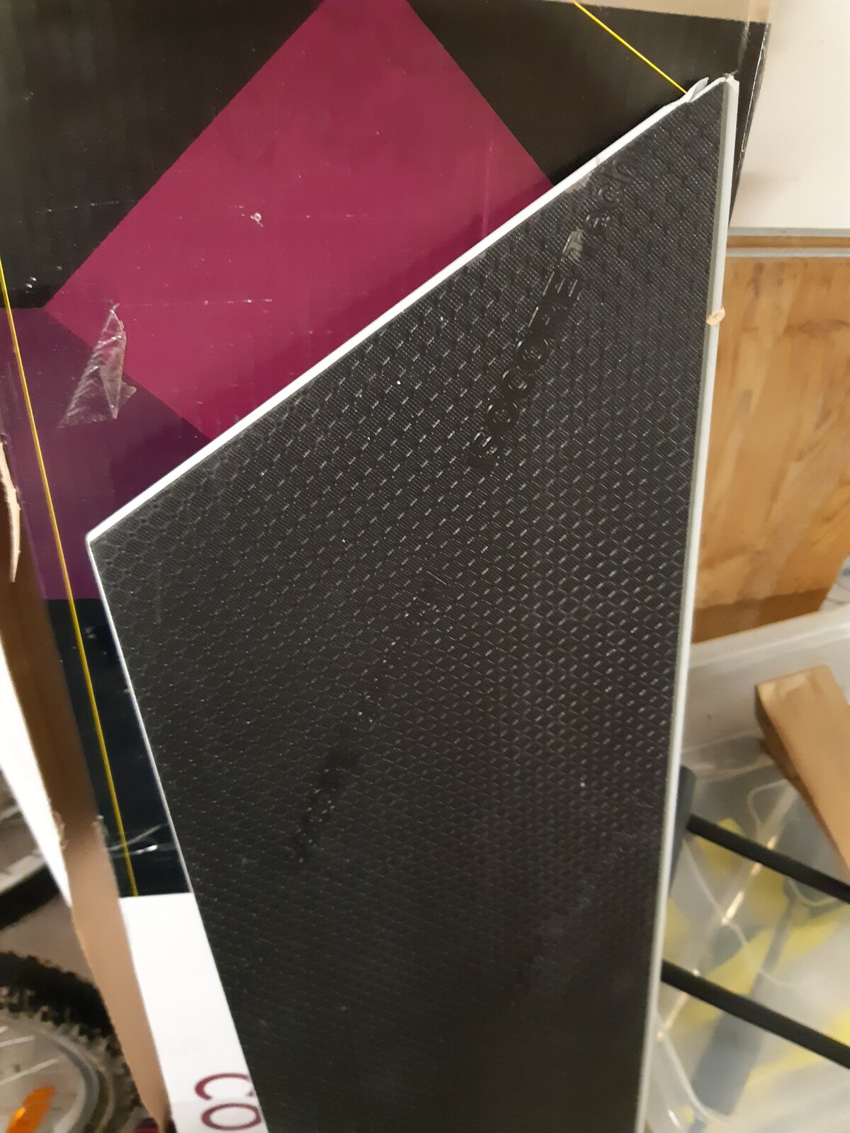

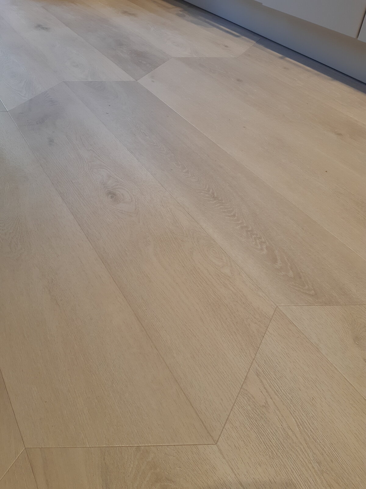

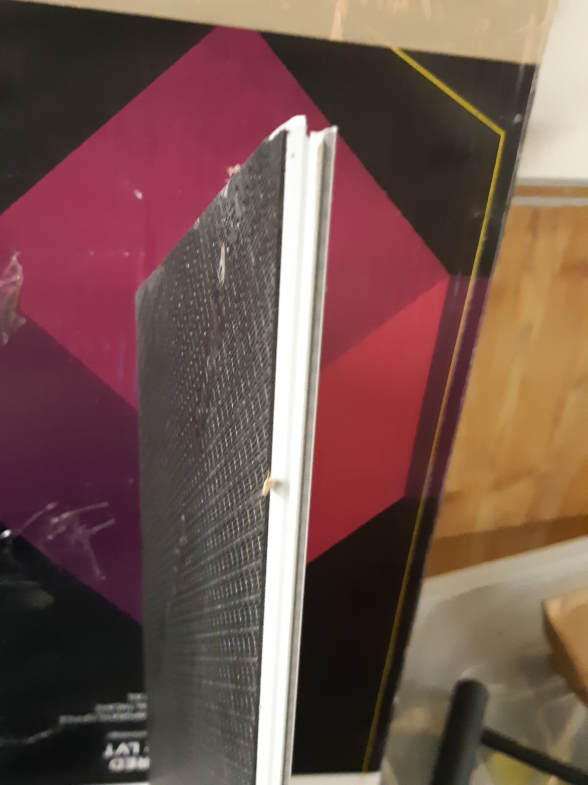

We have this LVT click flooring in our kitchen.
We found is very sturdy - it has been down for two years and hasn't moved. It cleans really easily. It was quite tough to click together. We took off the skirting boards so we could lay it under, but we didn't lay under the appliances. The only thing we were warned is that it can fade if it is in strong sun.
We liked this because the planks are thick and have a sort of strong backing. I attached a photo.
