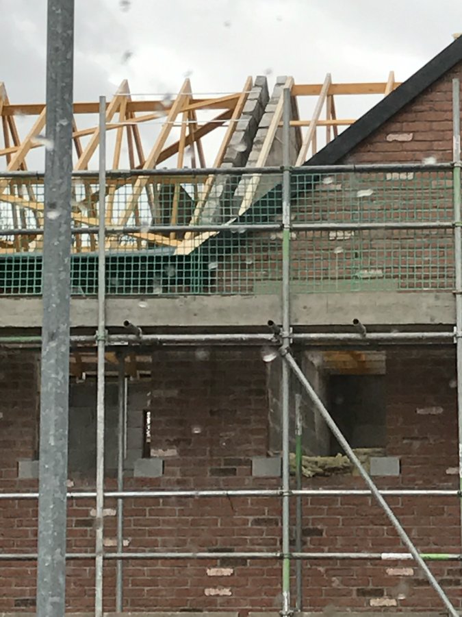

The breeze block party wall stops about 2ft up into the loft space and from there up it is just boarded to separate the loft spaces. I would have understood if it was just the upstairs affected by noise but the lounge downstairs gets a lot of impact noise transfer.
I was confused when I saw it was a double skin party wall, but that's what you can see from loft. I'll get a picture later.

They are building 3 houses opposite me and the party walls are cavity without insulation.

You would have to pour something in. There are loads of ties between the 2 layers that would stop anything solid going down.
Presumably those ties are responsible for much of the noise transfer too (at least below loft level)?
