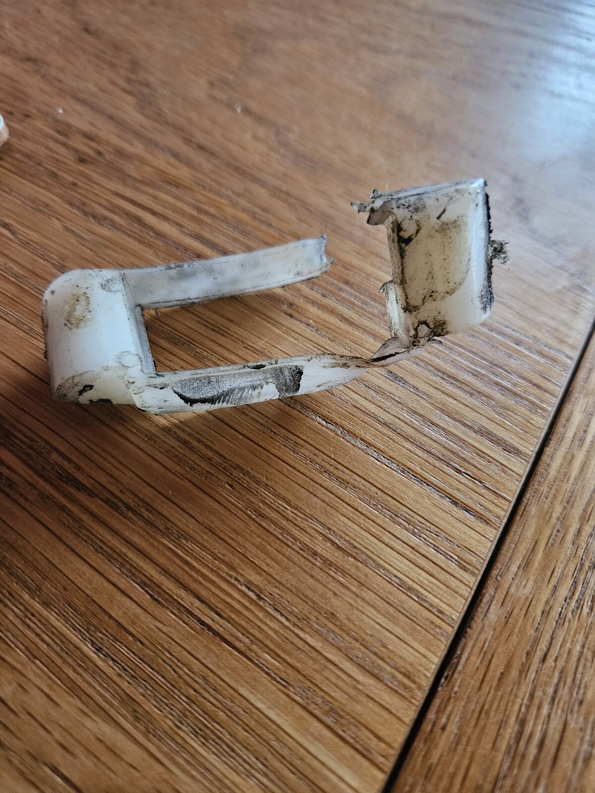

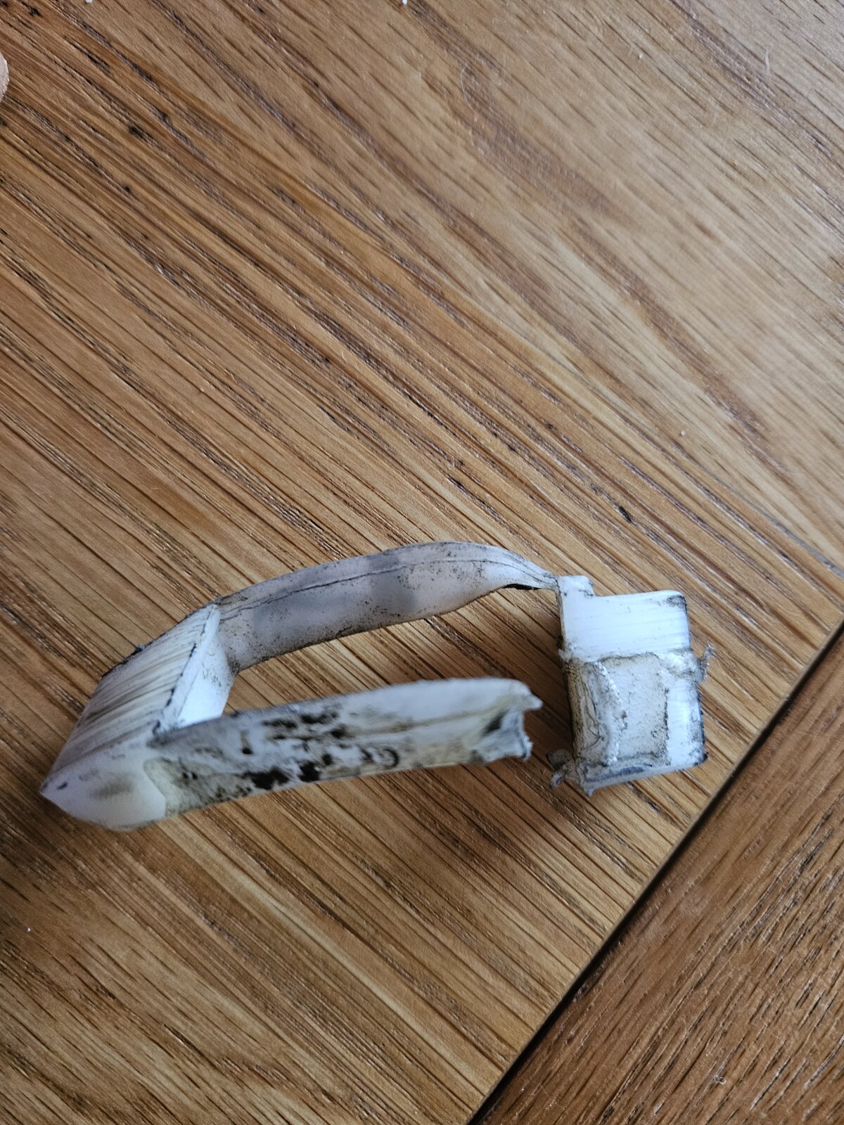

Hi, I have a sovreign xss40a petrol mower was reving then almost stalling, eventually wouldn't start, stripped carb cleaned out, also cleaned air filter starts great, tick over still surging then almost stalling, when I stripped it down I found a plastic part which was damaged it was from around the fly wheel area, think it is the governor vane but cannot find the part anywhere, it's about 6 inches long 2 pieces of plastic connected at each end
Sorry I can’t post links just now (in the south of France) but go to the GHS website and look for ‘governor blades’ and you may find what you need.
John
Have taken pics if part I need,
It fell out when I took top cover off, so it's from around the flywheel area, it runs sweet when I manually increase revs, but is hunting on tick over, hence why I think the part is some form of governor, but cannot find it anywhere, any ideas??

Unfortunately I don’t recognise that piece at all, but looking at the radius may indicate it’s part of the flywheel itself, which should be completely round with only a magnet fixed in one area.
I don’t think this is anything to do with the governor so your fault may be elsewhere.
Anyone else like to chip in?
John
Have a look on the crankcase carb side for a lever with a rod connected to the carb. If there is you can eliminate it as being governor related.
