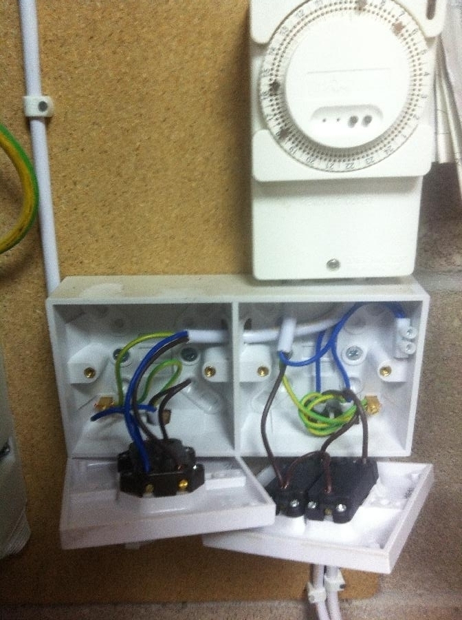

This may be a tad hard to spot. We'll see...
Outside lighting control on a shop unit.
The white flex dropping down vertically on the left is from the DB, taken from an existing lighting MCB.
The right hand switch in the dual box is 'meant' to be the main isolation for the outside lights.
The right hand of the dual box (two gang switch) switches the front lights and the back lights. The timer is wired in between the switches.
The main isolator does not isolate as it should!
I turned off the main isolator, turned off the time clock, and turned off both switches on the two gang switch. The lights were off, but still very much live...
How? Nothing spurious, everything is in the pic!
Reversed polarity at the consumer unit, AND faulty double pole switch, breaking only one pole?
the 20A DP switch ! That switch is should be wired across the connections LL NN

Terminals look too small for it to be a 20A DP, so must be an intermediate :eek:
There really are some muppets about :rolleyes:
It's an intermediate.
That's what I reckon too - and I decided that before reading any suggestions.
So when "Off" it merely switches L & N so when the timer and/or light switches are off, it is the neutral (now on the brown wire) that's disconnected.
