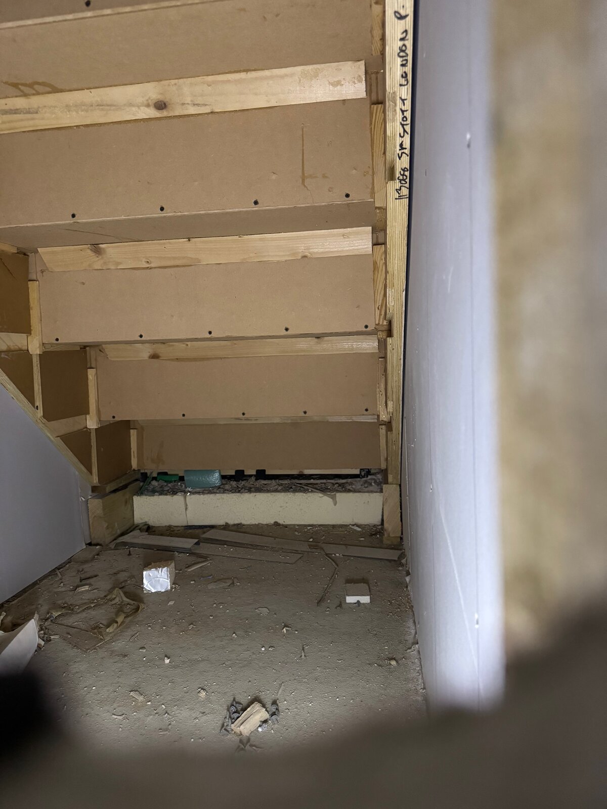

Want to run a spurred outlet to a cupboard i have built in a walk in cupboard under the stairs - New build 10yrs old
All the cables currently run up parallel up the walls
The walls have metal strut attached to the plasterboard so without cutting a channel its impossible to feed a cable horizontally along the wall
Plasterboard Metal Strut Plasterboard seems to be the install
What i was looking at doing is running the mains cable parallel down the wall and then drilling into the cavity under the stairs and running it to the socket
a) if i stick the cable into PVC conduit would that be deemed ok?
b) where would the pvc conduit start do i make a hole big enough for the conduit to come through plasterboard?
c) the spurred outlet will be at 30cm height so that it fits under the shelf which i dont think makes any difference
Already drilled a hole out where i want the spur as attached so i can see what i have

I don’t entirely follow what you’re trying to do, but…
Putting cable in PVC conduit does not exempt it from the “safe zone” rules. It would need to be a steel conduit, and it would need to be earthed.

Is it ok to run a cable diagonally in the space under the stairs, and is there anything i need to do to comply with regs?
The photo is taken through the hole i created for the spur outlet socket
The current socket is on the right hand wall the other side of 2 layers of plasterboard
If you can make sure the cable is 50mm or greater below the finished surface, then great.
If not, you need earthed metal conduit.
Or used SWA cable.

The void can't be accessed by anyone?
So regular cable may be fine, slung in the void.

Nope cant be accessed by anybody
The photo is taken in the hole i made in the plasterboard for the Socket
The other end of the cable will run to the wall on the right hand side at the diagonal where there is an existing socket on the other side of the plasterboard i will spur from
The cable will be on the floor of the Void as i intend to obey the safe zone and run from the Current outlet down to floor before feeding across
Zones apply where cables are concealed in walls.
They do not apply in this empty space under the stairs, as that is not a wall.
There are no zones in floors.
