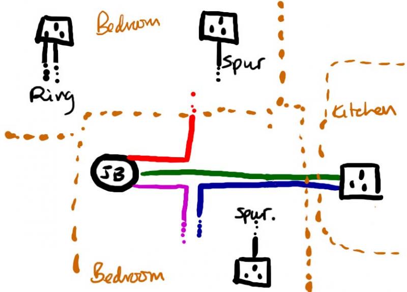

It's not what you think! I don't want to do this - I think it's already been done for me. :shock:
Peruse the diagram: concentrate.... :D
There are three rooms involved here: the kitchen and two bedrooms (between which I an rebuilding a stud wall). The temporary junction box (circle with JB) is taking the place of an original socket (in that wall I'm rebuilding) and has three cables (the red, green and pink lines) running from it.
In one bedroom (top) I have a socket with two cables which I have been using to test the ring is live using a storm lamp. Then we have two other sockets, one in each bedroom, with a single cable each; obvious spurs then.
Lastly we have a kitchen socket which has two cables, the blue and the green cables - so you would assume this this is on a ring, wouldn't you?
The diagram is loosely based on how the cables are under the floorboards; specifically the sockets they head off towards.
I wanted to work out which of the cables I can see was the one that went off to the spur, so I could add a new socket to the ring in my shiny new wall (which would only involve another 2m of new cable). Thinking the green and blue cables *must* be part of the ring I disconnected the pink cable, but all the sockets continued to work. So, I disconnected the red cable, but all the sockets *still* continued to work. uh...
So I disconnected the green cable and the "southern" spur stopped working! All the other sockets still worked too *except* the kitchen socket. Now, the only way that could happen is if the blue cable (connected via the green cable and the kitchen socket) went to that spur. Now, if the blue cable *were* part of the ring the kitchen socket would still work, yes? But with the green cable disconnected it doesn't.
So, it looks like the original house wiring includes a spur off a spur. Or is my logic floored...

(FYI: I pulled up a few more floor boards in the "northern" bedroom and the "northern" spur is fed off the red cable via a junction box. The ring continues off toward the other socket in that room. There used to be another wall in the kitchen below, so I'm assuming there was a socket down there which was part of the ring and is now replaced by the Junction box. The only other plug socket upstairs has two cables so I assume is part of the ring; it's in the general direction the pink cable is off to. Yes, a couple of assumptions there, I know.) :shock: :shock:
From your tests it does indeed seem to me that the green cable goes to the southern spur.
can you disconnect the blue cable from the kitchen socket and reroute it to somewhere on the ring?
Before you take any further steps you need to check your assumptions.
Just because a socket has two cables going into it does not make it part of a ring. It may be a spur with another spur off it. Or the circuit may be a radial.

It's a bit too late to check tonight (I'm surprised to get a reply so soon!) but I believe there's two cables running to the consumer unit. Quite sure it's a ring: one, I was told by a sparky one time; two, when I disconnect all these cables all the sockets stay working (don't worry, I place boxes on the ends - no floating live cables here).
There are two rings: the original ring for the whole house and a new one for the kitchen. There's one socket left from the original ring still in the kitchen though, which is the one we're talking about.
There are nine sockets on this ring (including (this kitchen one and my temporary junction box). Only this one has three cables. Only the two spurs on my diagram have one cable. The rest have two cables.
All the cable (that I can see) is 2.5mm. The MCB is 32A.

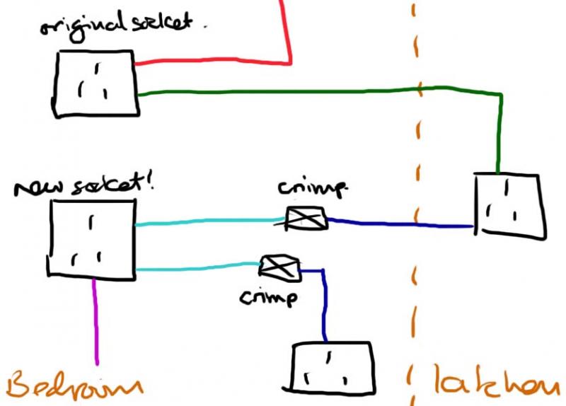

I was thinking this:
Cut the blue cable and link with the pink to make a circuit and a proper spur. Does that make sense? But I need to be *sure* I'll get the circuit I want - there's still a tiny doubt in my mind I can't ignore - and it'll need to be crimped rather than be done with a junction box as it won't be available for inspection.

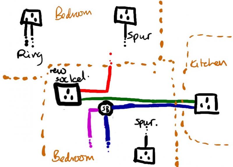

OK, here's what I'm thinking the solution is:
The red and the green cables don't get touched. I cut into the blue cable and junction two new cables in (temporary - they will be crimped later on but it'll get me moving on finishing the wall) up to a new socket next to the original one (currently in a temporary junction box). The pink cable will then run from this new socket instead of the old one.
So the ring will now run through red, green, blue and pink. The spur will be OK and the kitchen socket on the ring main for the first time in it's 38 year history.
Anybody see any issues with this? Am I right in thinking that the crimps won't need heat shrink as long as they stay in the junction boxes? (You are still there...?)
Crimps are only good for through connections. You cannot get a good reliable connection for a spur - eg two in and one out.
Much better to do that sort of thing in a deep box behind a socket, or have a box in theh wall with a blank plate over it. Then its accessible and you can use terminal strip.
