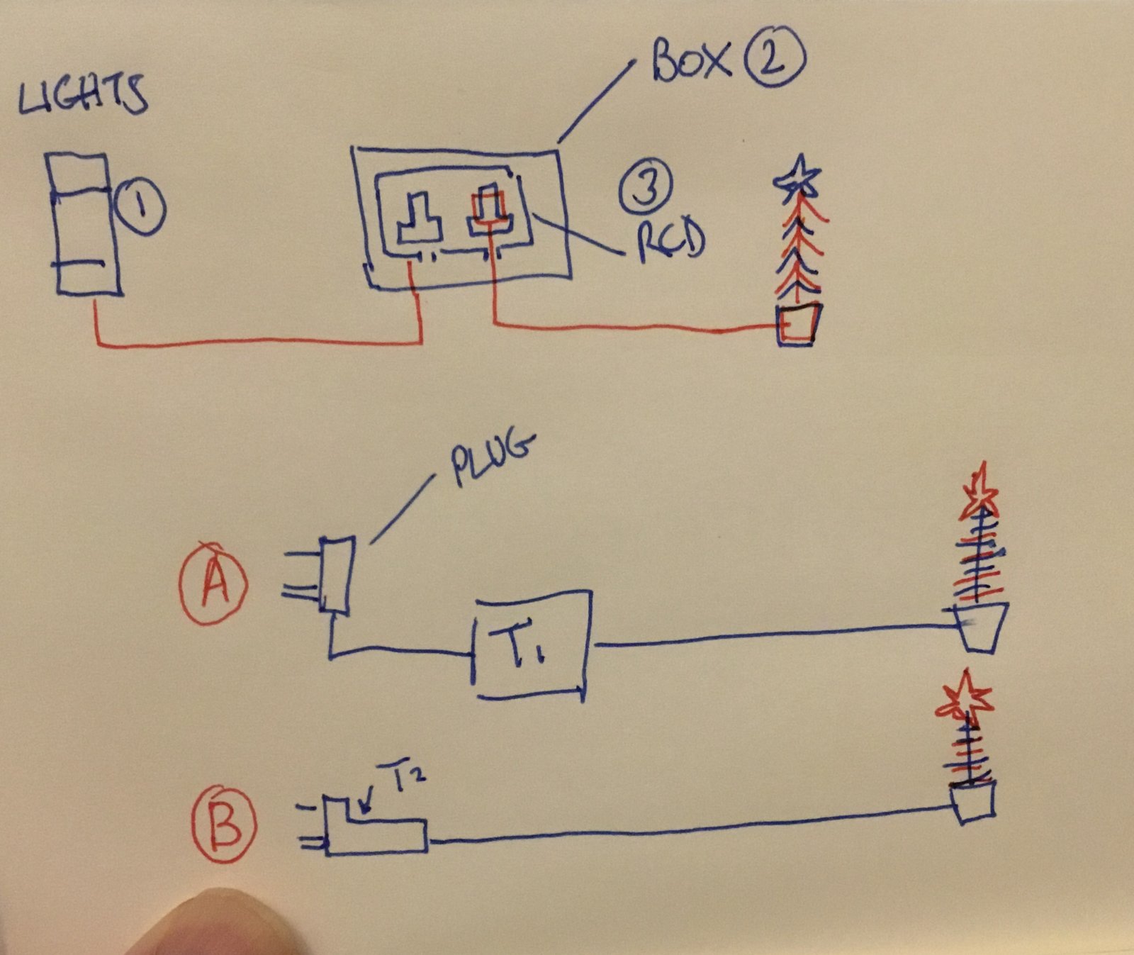

Spur socket off lighting
Hi
Guess who?
Please take a look Ebenezers
Spur from outside light
Run to waterproof box screwed shut
inside box (box under eves of house around 7 foot off floor) rcd twin sockets
Some lights have a plug and then a transformer, so would place that inside box
others have transformer in plug head, like a mobile phone charger
lights will be led
ok
do I need rcd sockets? House has a rcd board for light, sockets etc
What size cable
what power can be drawn. Only plugging in a few lights, but want to know.
Regards
Bob
let’s get this sorted befor Jacob turns up
If that is running on the lighting circuit then 1mm² or 1.5mm² will be fine. Please be careful and ensure water cant get into anything and drill the hole to the outside angled down so water cant run inside.
If the light installed is 1. is it ok to run 1.5mm from it?
Drip loops. Got it.
Extension lead or rcd sockets as per last proposal?
