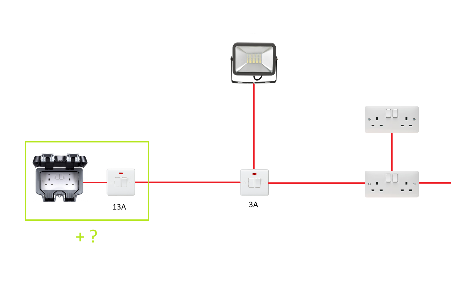

Hi, apologies for the basic question
In a radial circuit, is it permissable to spur off the supply side of an existing fused connection unit?
As above, 3A FCU is feeding a floodlight, is it okay to spur off the supply side of the 3A FCU to feed a 13A FCU, isolating an outdoor socket?
Cheers

The answer to your question depends on cable sizes and the size of the breaker/fuse protecting the circuit concerned. Can you provide us with that information?

Sorry John don't know what happened there, worked when I posted, have edited the OP hope it shows, the main socket circuit has a 20A breaker in 2.5mm T&E, with 1.5mm T&E coming off the 3A FCU feeding the floodlight.
Yes, you can do as you wish but the 13A fuse is neither necessary nor desirable - a double pole switch indoors would be desirable so use a 20A DP switch.
Much appreciated, is the DP preferred due to the extra 7A of breathing space? And safer as it's isolating the neutral as well as the live where I assume the FCU would only isolate the live in case of a fault?
Well, sort of but more the other way round - the 13A fuse is just not needed so why restrict the supply?
There will be fuses in the plugs used.
No the FCU is also DP - you just don't need the fuse.

Thanks for that information (which, as I said, wee needed). I won't bother to repeat his answer, since I agree with everything EFLI has written, including the fact that the 13A FCU is not required.
Kind Regards, John
All agreed the FCU certainly not required, nor a switch for that matter but something is a very good idea to provide isolation, even if just for ourdoor Chritsmas lights.
As Sunray says a DP switch of some kind is a good idea to isolate things outside in case of damage/water ingress or even just to prevent unauthorised use. So either a 20A DP switch or a Switched Fused Connection Unit would fit the bill. If it`s a SFCU then the fuse is not really needed and might confuse someone in future (including yourself over time).
