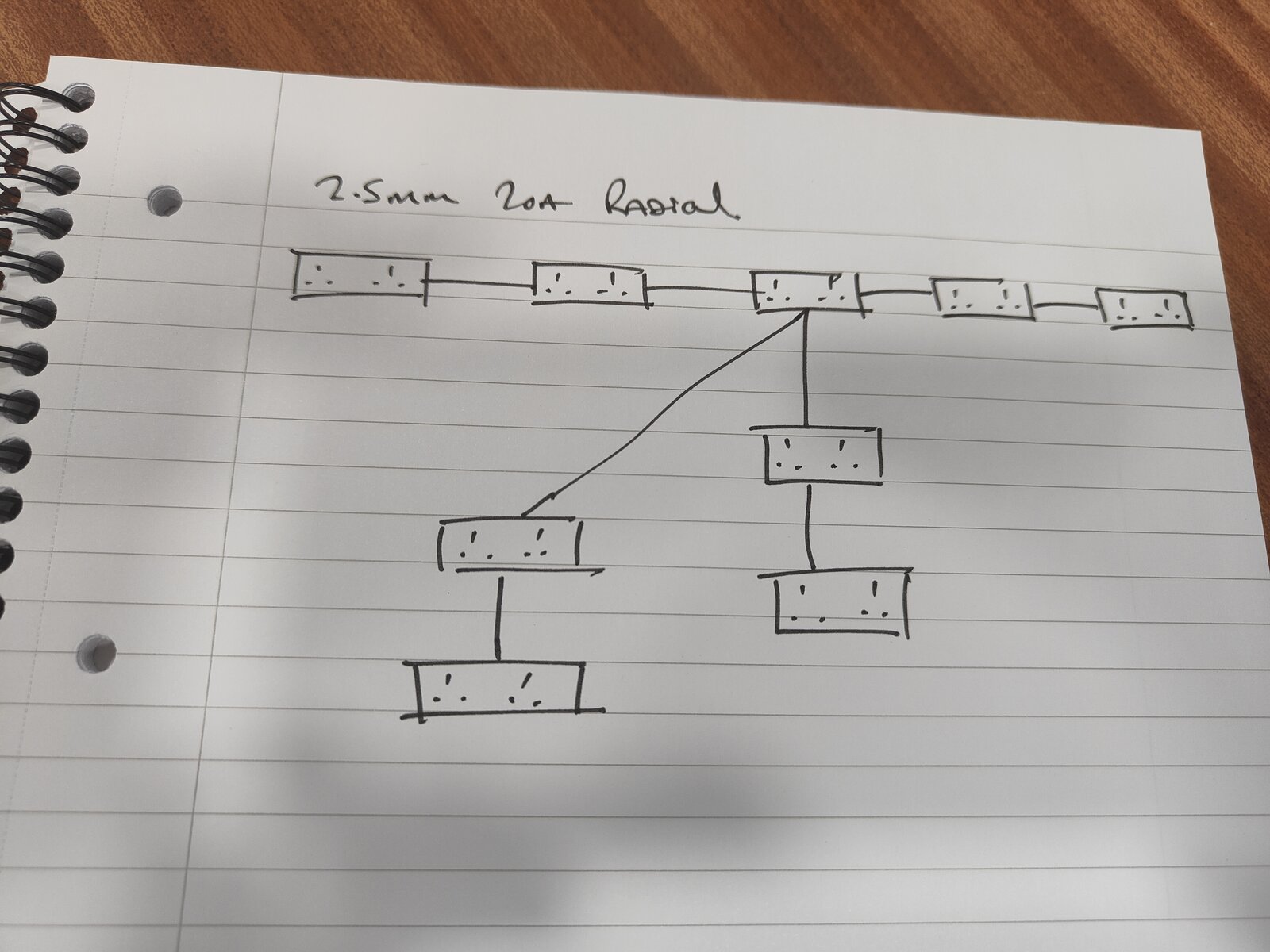

Morning all,
I'm competent installing electrics.. and understand that rings can have one spur or multiple after a FCU.. and radials can have as many spurs as you want really.
But.. my brain is having an off day and can't get my head around the reason why this is so.. can someone explain in easy terms for me ?
Thanks all
Mark

You have used the wrong word. There is no limit on the number of spurs.
A spur is only allowed one socket without the FCU and when the cable is 2.5mm².
This socket may be a double socket (the limiting it to one single socket does not make sense) so, two 13A loads could be plugged in and the likely 2.5mm² cable used is rated at 27A therefore it cannot be overloaded.
More than one socket is supposed to have the FCU to also limit the current on the spur; unfortunately 13A is the maximum fuse size in an FCU.
Of course, you could use 4mm² cable for the spur, then it would be capable of carrying the 32A so no restrictions or limit.
The same rules apply to Rings or Radials.

Ahhhh okay.. so sockets on a 20a radial with 2.5mm cable can have as many spurs of a socket on 2.5mm as its rated approx 27a and the breaker will trip before the cable gets too hot?
Yes. (I think I know what you mean)
There aren't really any specific rules governing spurs. As long as the cable cannot be overloaded then you can treat it like any other circuit.
Only examples of some methods for spurs are shown in the regulations so people think that is all that may be done.
Would this configuration still satisfy?
Yes, and 25A would be alright - or 32A with 4mm² cable.
Just to clarify, the cable is the spur. Some people call an FCU a spur or possibly even the socket.
When I started a radial was a supply radiating out from an over current device so a FCU would supply radials, but the wording seemed to change and they are now called fused spurs, a supply from a FCU is a circuit, however since a ring final is the final circuit, you can't have any more circuits from a final circuit so supplies from a FCU are not considered as circuits, at least if supplied from a ring final, since a radial is simply called a radial it could I suppose have a further circuit, but we don't consider it as such.
But at the end of the day it is all about stopping over load, so a 4 mm² or 2 x 2.5 mm² can take 32 amp, but a single 2.5 mm² can only take 20 amp depending on type of cable and the way it is installed to allow cooling.
A 13 amp socket can only supply 13 amp (except in a hospital) as there is a 13 amp fuse in the plug, so if supplying a single BS 1363 device it should be limited to 13 amp, as to why a double socket is permitted and two single sockets are not I have never worked out, I was told is was because you can tell if socket is part of a ring final or not when supplied with 2.5 mm² cable by how many cables, but that is clearly not true as could be a 20 amp radial.
To my mind we check if a ring by testing continuity between the pair of cables, and size of overload supplying it. So have not idea why a double socket is allowed on an unfused spur with 2.5 mm² cable. Or how it is permitted to market a double socket with a combined rating of 13 amp, it seems wrong, one would expect a double socket to take 26 amp. However there are double sockets, in the main specials like filtered sockets, where the combined rating is only 13 amp.
