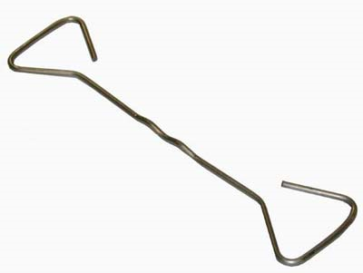

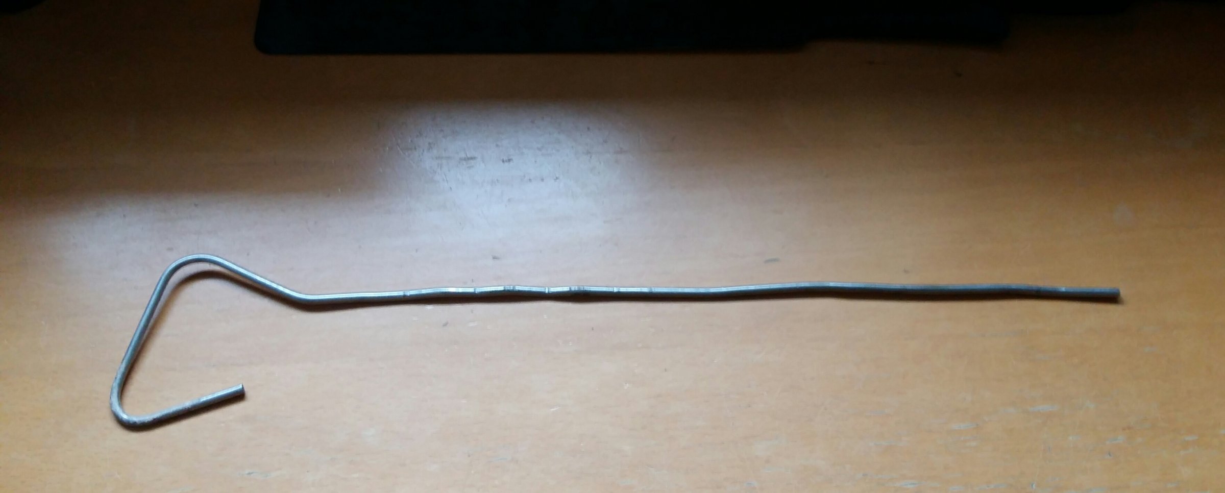

I use this to clean my foam nozzle....
It's a straightened version of one of these......
The one end is left bent and makes a good handle.
That looks a bit easier to use than copper wire.
Thanks for the tip, will see if I can get myself one of those.
Jever
The new SS housing ties are a wee bit thinner but they are still reasonably strong. I had a couple of the chunky fellas left over from a job that I straightened. I have one in the van and the one above is used to thread the hoodie rope back through my hoodies because I always forget to tie the ends together before depositing them in the laundry basket. :mrgreen:
