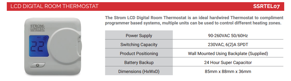

my dad is in the process of upgrading from a Sunvic TLM2253 to a Strom SSRTEL07.
not able to get to his right now but he has managed to get the heating on but has no real control of it and the new SSRTEL hasn't lit up when pressing in the settings button.
Can anyone tell me what needs to be done and how it should be wired.
He tells me the Live and neutral are wired up correctly, however he does tell me that his screwdriver should power on the black and not the red and he then changed the wiring round to suit.
I think he need some to use something a bit more safe and accurate than a neon screwdriver. Doesn’t the Strom need batteries as well?

Quite a lot come with batteries so they can be volt free switching, and don’t require a neutral for an anticipator. They are often used when only two wires are available.
the Sunvic is an old mechanical stat and will have a live a switched live a neutral and possibly an earth, the only two wires you are interested in are the live and the switched live the rest you need to terminate safely as they are not used in the new stat, do not go by the colours of the wires these mean nothing in a heating system, the new stat is battery powered and you connect the old live and switched live to COM and NO on the new stat

The SSRTEL07 is mains operated.

The new unit has three terminals Neutral, Live, Normally open.
The unit isn't illuminated (so if battery operated there appears to be no battery), the unit says its battery operated with a cap as its power back up.

My apologies @EFLImpudence seems to have found a wiring diagram for it and I was incorrect, it seems you need a live and neutral supply and a switched live to bring the boiler on, still not rocket science to work it out with a multi meter
