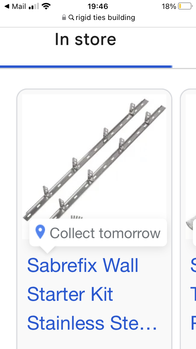

Evening woody ,
I’m not sure how easy it will
Be to bond them
In as it’s a single skin wall it’s joining on to and insulated on the inside,
These are the wall starters I’ve been using but not sure if these are flexible or rigid ones?
Jake
All wall starters are flexible and allow for some movement. All door frames, especially those with heavy doors/glazed doors put a lot of rotational load on the jamb they are fixed to, so there is a risk of slender piers cracking.
If its a single skin wall being joined to, it should be easy to block bond in the new pier.
