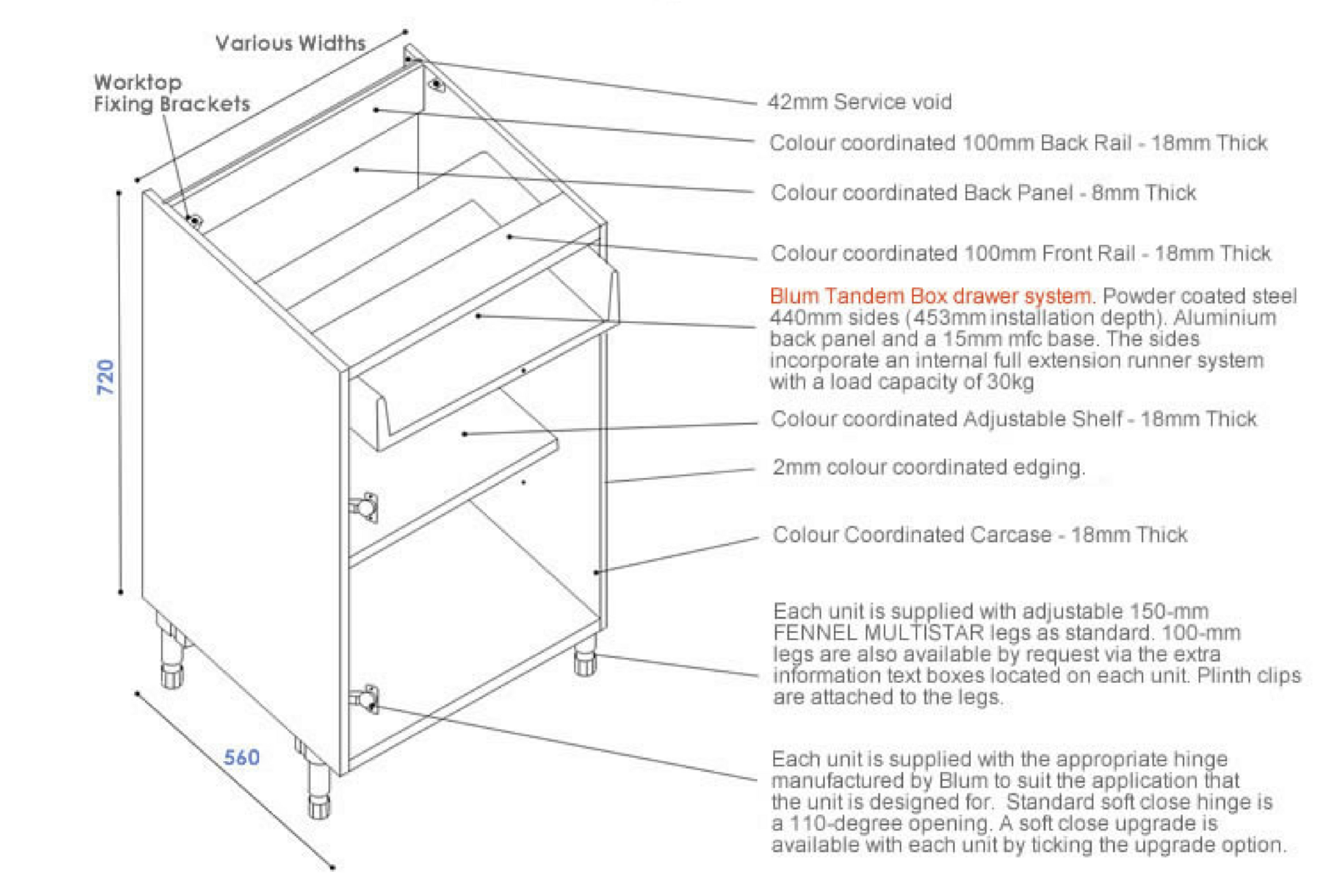

With rear panels in place the internal depth of DIYK cabinets is 510mm.
Not one of the integrated fridges which John Lewis sell (covering 7 "mainstream" makes like Zanussi, Beko, Samsung) needs less than 545mm.
But then I should have given this more thought...
a) seems reasonable that there should be free space for air to circulate.
b) seems unreasonable to think a kitchen company could get away with selling fridge/freezer cabinets in which no fridge/freezer would fit.
c) it may seem that other makers make deeper cupboards - Howdens for example are 575mm deep, but their service void is 72mm, so with the back panel in place the internal depth is less than 500mm.
