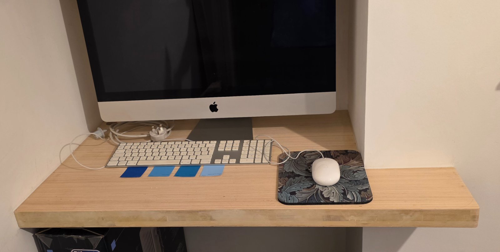

I made a desk from a 44mm Plywood FD30 Fire Door offcut. The door has what looks like white oak wood veneer on both sides and I would like to source wood veneer edging to finish off the desk.
Is this wood veneer edging a good choice? If not, which one would you recommend?
is is straightforward to stain the desk including the wood veneer edging? Is water-base or oil-base stain the best choice for this application?
If I didn't like the result, could I light-sand, prime and paint over it?
TIA

That edging is ok.
Personally I prefer the non pre glued so I can use my own glue.
For a busy desk I would use oil based stain, however, if it's going to be used by a neat adult, ronseal diamond hard stain/varnish would be more than good and you can do 3 coats in a day.
Just a bit of a warning, staining can be more hassle than it's worth, it can highlight deep scratches (which you think have been sanded out but have still bruised the fibres), highlight glue, filler and open joints. A light stain whether water based or oil would be better than a dark stain, Personally I wouldn't use a stain/varnish, this is known in the trade as a tinted lacquer and I just don't like them I prefer a stain then clear coat. If your using varnish then either oil or water based stain will work however if your going to use water based I would advise wiping a damp cloth over the surface first to 'raise the grain' the sand it flat before using the staining.
