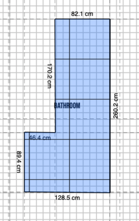

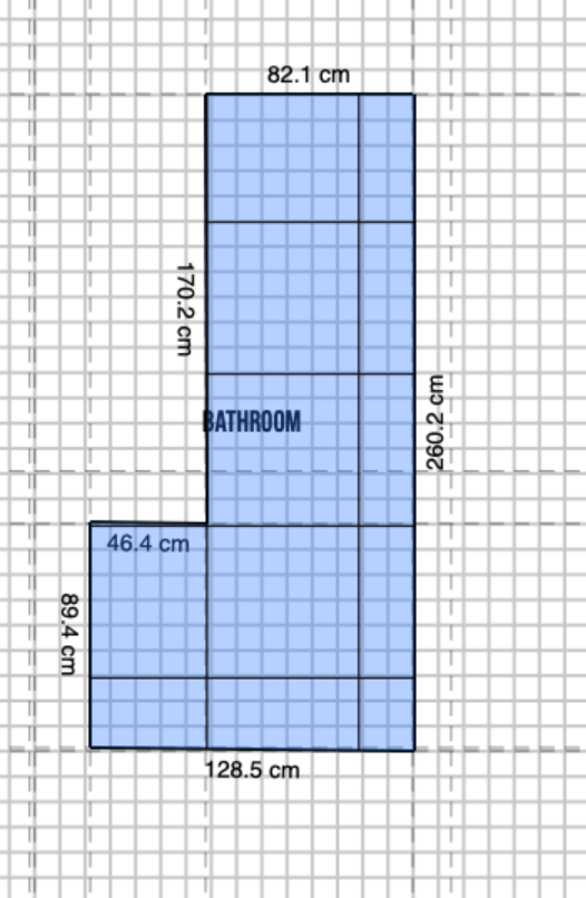

Im going to be putting some 60x60 tiles down arriving that are a terrazzo pattern
This is just the floor space, bath will be in the 170 length section alcoved with pipe boxing and the Door will be in the bottom right corner. WC will be in the left corner section (centred to that bit)
The plan options seem to be;
Option 1 - Full tile will be in the entrance (Bottom right corner) with 1/4 tiles along the bath
Option 2 - 1/4 tile in entrance and full tiles along the bath section.
I've read about a full tile on the doorway being better but open for suggestions for this.
Tiles will be 600 x 300 on the wall hence why I've got 600 x 600 floor.

I would also tile the section under the bath otherwise you have created a 1cm deep area where any leaks can pool and sit there for weeks doing whatever damage they like and you would not know until the damage is done. If you tile underneath as also seal where they meet the wall then any leak will make itself known by appearing under your bath panel.
Can't tile fully under the bath now, I will be doing a tile panel and plan on tanking the bottom of the bath.
It was a 90's plastic cover before and never had issues to be fair though.
