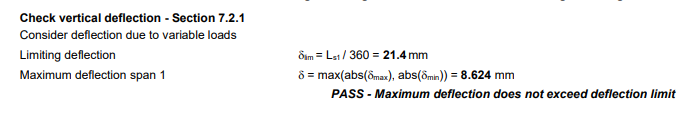

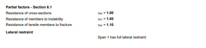

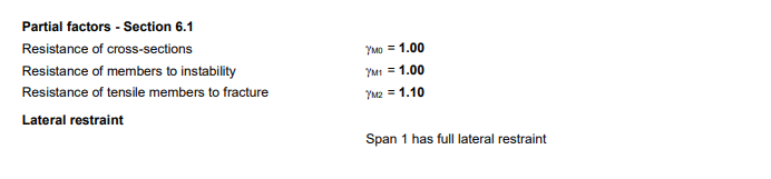

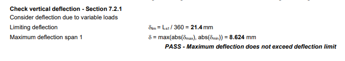

thanks for comments see attached calcs
  • Structual beam Calcs.pdf
As I suspected...
He's taken full lateral restraint
and taken live load deflection only
Put him back on photocopying duties until he learns what he's doing :LOL:

As I suspected...

I think you're being a bit pessimistic. Fig 3.15 of SCI P360 would suggest a series of joists can provide lateral restraint. And 2.5% of compression forces should be able to be held by joist hangers. (if the joists are parallel then red alert)
Bigger issue for me here is use of an open section for torsion resistance, wall returns instead of posts (not very impressed with the padstone/wall calc) and lack of dead load deflection. Oh and its not galvanised on.
