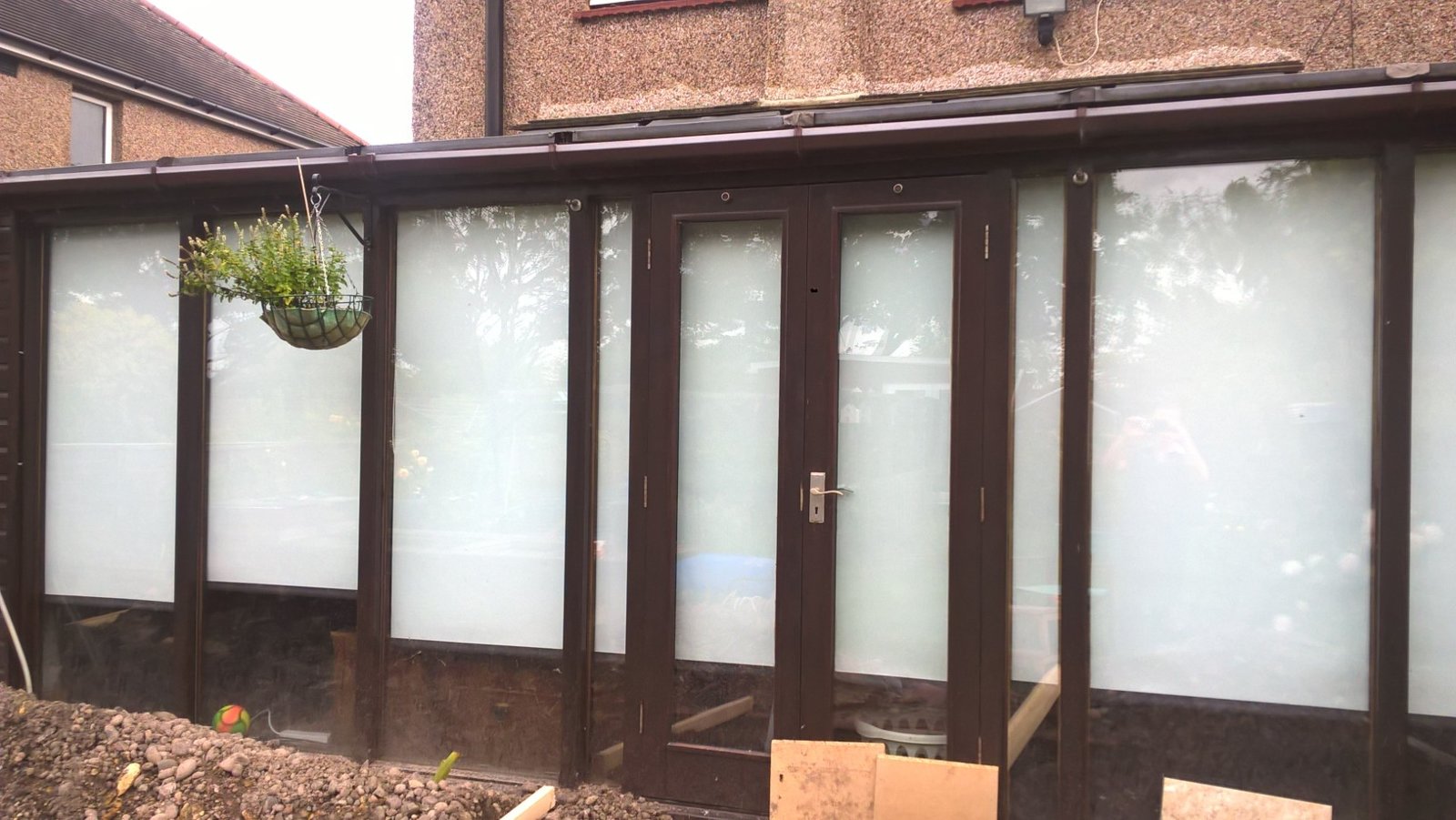

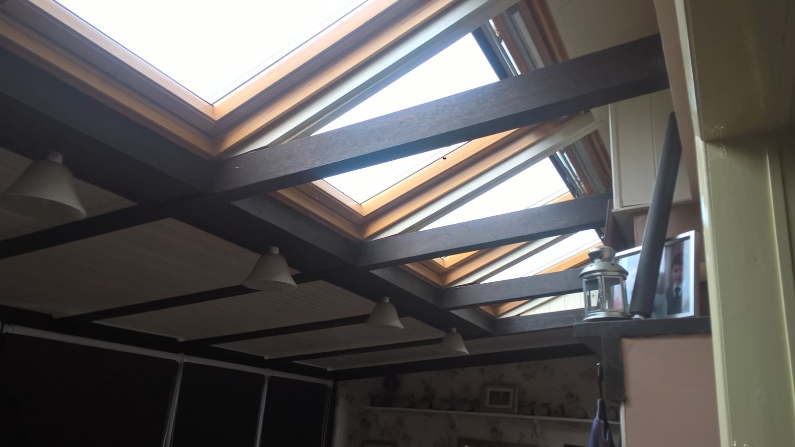

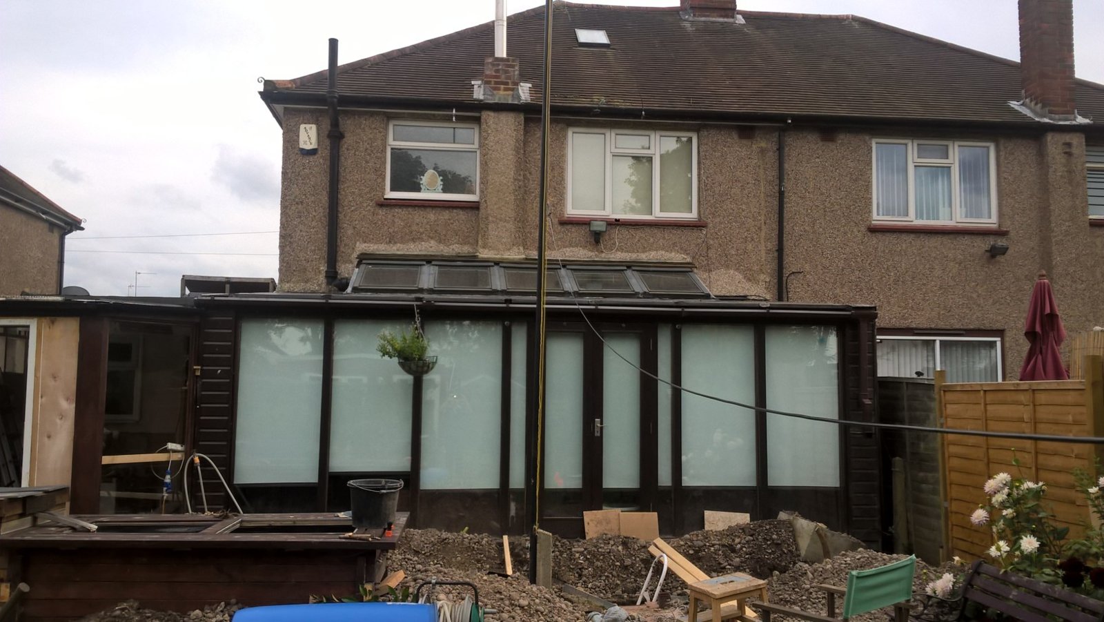

Thought i would upload pictures of current conservatory. I will be using this front brought forward to the new boundary line. As you can see the current roof has velux openers sitting on the hard wood beams which are easily same weight as glass units if not more and this has been all ok for 6 years.
I am really not worried about the front weight only the span of the beams.
I will let you know what i find out from the company's over the weekend. The guys that do the skyline bars have got back and said they could do it all if I give then some details. Will sort this out tonight and see what they say.
As for the two tier drawing this was done in wood, using there beams I expect I cannot do this and will be back to joining the units. I thought I saw on there web site that they did this so will have to ask them

It's a bit more like a half lantern construction on top of a frame work, with quite a large cross member.
On the area that's not glazed, what is the roof construction?
Externally this is all poly sheets, internally this was paneled over due to noise. This roof will not be what i am fitting on the new conservatory as it will be all glass.
Construction of the current one is 4 x 4 grandis red hard wood beams with none supporting glazing beams on top.
