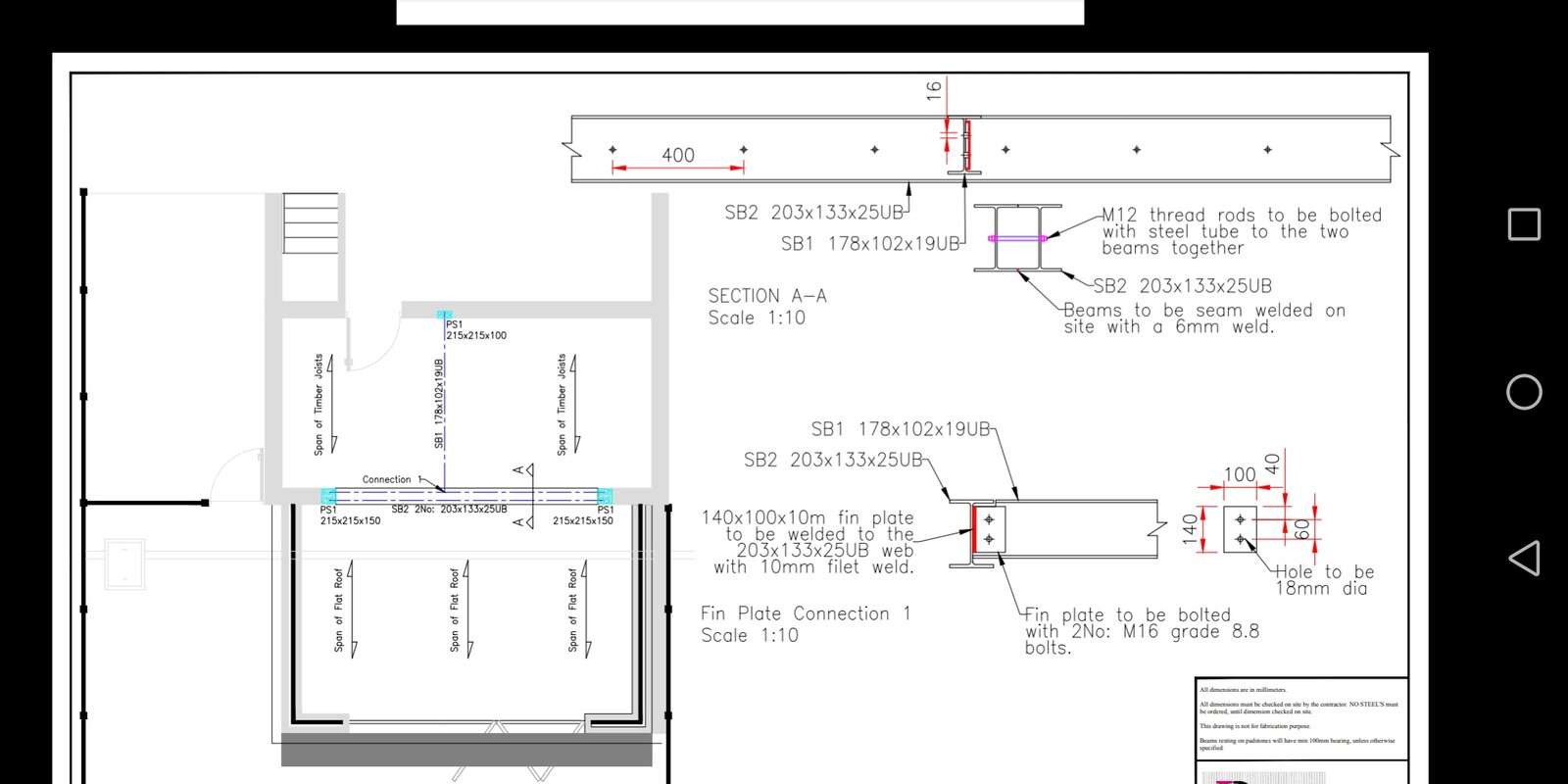

Just a quick question, im awaiting structure engineer to reply to email, but it's bugging me now.
The council BC attended today all work fine but have questioned why this timber spec on drawing.

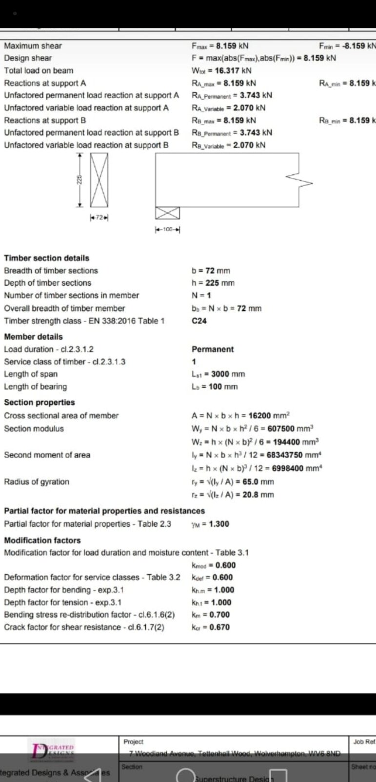

It's just randomly on there and confused everyone, the calcs are only for steel in rear wall, but the engineer has included timber spec, see attached.

Looks like he's sent you the output from a timber beam design in the software package TEDDs. It's nothing to do with steel beam design.
Do the forces match with what been used for the steel design? Unless they're in there as an alternative to a steel they probably accidentally included.

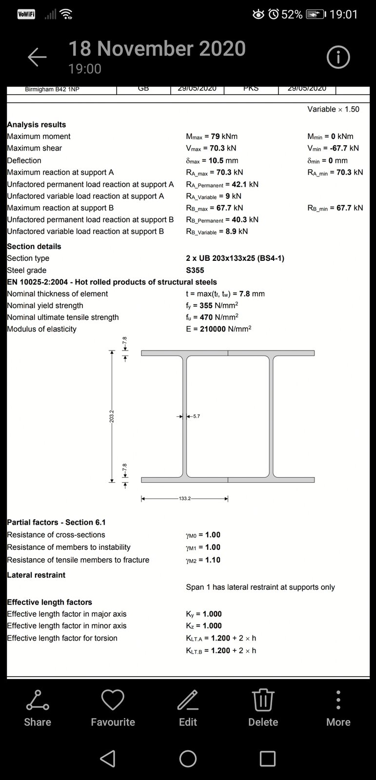

Unsure of how to read the force correctly, but I hope the attached helps

Can't see the timber included in the final drawing.
