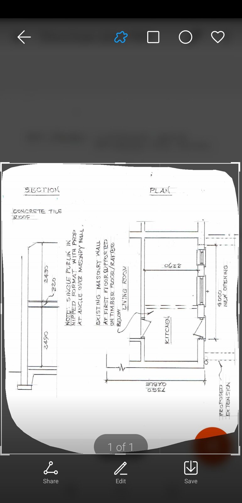

Just some Feadback if interested
The timber Is related as on one of the drawings you sent attached, it shows a timber purlin so we have generated the load that purlin will impose on the steel beam we have designed.
So presumably the purlin is existing, and is propped off the masonry wall at first floor level, which in turn is to be supported by the 178 x 102?
Seems to make sense now.
No idea if I need to do further works, just a little random to have a timber spec with no details, yet another question I need to ask.
As I see it, there's nothing additional to do.
The wall at first floor level is going to be supported by the 178 x 102 beam which is bolted to the inner of the two main beams. At present, it looks as though the first floor wall may be supported off the floor.
In the loft, there may be a purlin propped up off the first floor wall. The SE seems to have added the load from that purlin to the weight of the wall, to arrive at a suitable size for the beam supporting the wall.
(In other words, the new beam is supporting not just the weight of the first floor wall, but probably part of the roof via a purlin prop as well - if that makes sense?).
