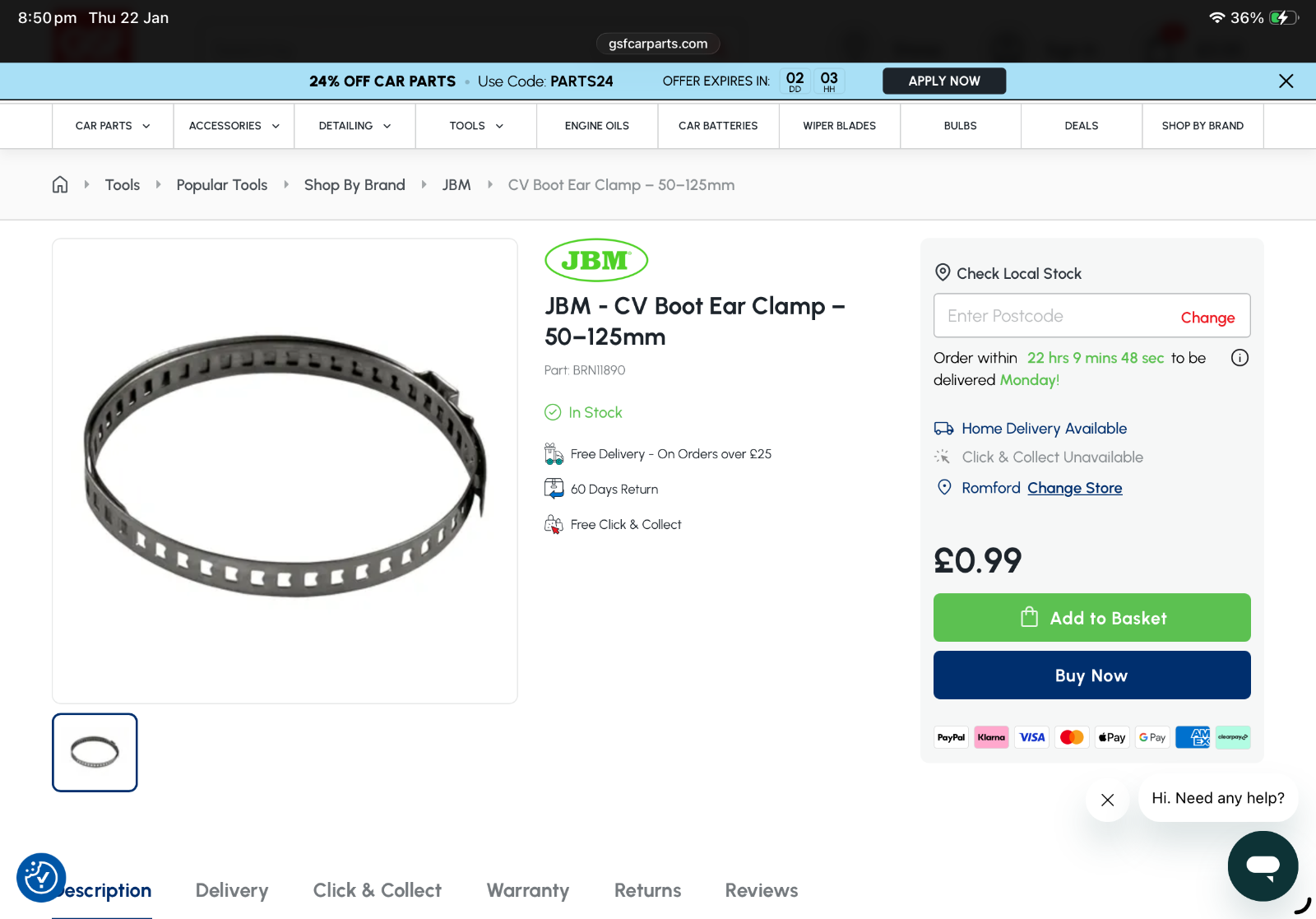

Hi All, Replaced the inner tie rods last year on my son's 2015 1.2 Corsa both sides. Fitted new gaiters on the inner tie rods and fastened with cable ties as tight as I could get them. The drivers side gaiter has come off after about 8 months of driving, looks like the inner cable tie was the one that didn't hold the gaiter on. Anyway now have to put a new gaiter on but was wondering if there is a way to get a cable tie tighter or some other method of holding it on. I did look for a jubilee clip but couldn't find any narrow ones to fit.
Is it a hard plastic gaiter? One of these will do it.
