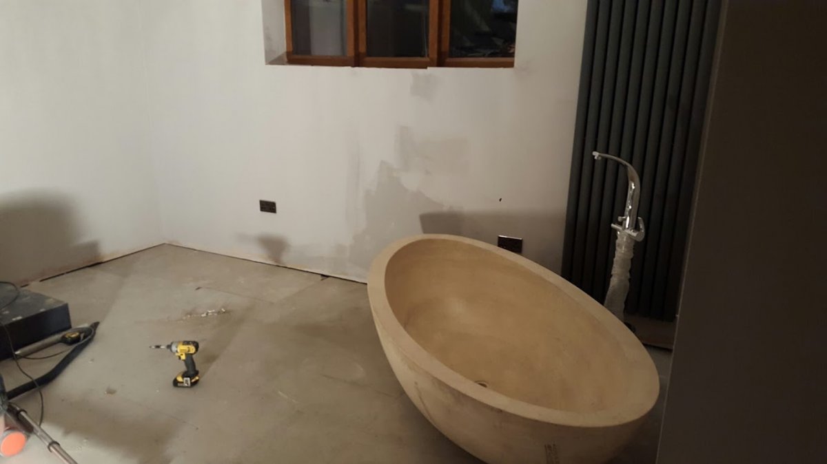

Hello,
I have a stone (travetine) bath, but I have no waste for it. Standard won't work. It needs to look like a basin waste but be 1 1/2 inch rather than 1 1/4.
I managed to find this http://www.ebay.co.uk/itm/Bath-Wast...676705?hash=item27fd9d6ae1:g:u8gAAOSwqu9VMkZJ
But the bath is 65mm thick. So it won't work.
I know this type of bath is pretty rare, but there must be an off the shelf option.
Picture of bath attached for reference.

That looks like it could/would work, but we wanted the pop up style, this bath was incredibly expensive, and that plug would somewhat detract. I tried the company that imported these baths and they couldn't help. I'm not sure if this bath was a complete one off. Or if there was another sold. But either way, waste was an issue. (which is annoying)
I found another UK company that sell something similar so i'm going to try them.
I might be able to buy one of those though and machine an insert to make it a "pop up" waste.
Its a very uncommon fitting to be honest. assuming the bath has no overflow?
http://www.willesdenbathrooms.co.uk...k12U4XfjiWtLMdM5m9uOMl-TwOIGGCAyg5xoC3PLw_wcB
It doesn't have an overflow, unfortunately though the description in the add is incorrect. If you read the dimensions of the drawing it turns out to be 1 1/4". Thanks for the suggestion though :)
Who supplied the bath? Surely they can supply a waste for it?
If not then something like this?
https://www.bathroomsandmorestore.c...th-overflow/?gclid=CMbRuOXFq8kCFSMFwwodIFANGQ
A got the bath from a high end house renovator in london and it was on its own.
I have spoken to somebody that makes/imports stone baths to UK and he has the wastes custom made.
The one you linked is a basin waste again so 1 1/4. More importantly the flange is 60mm rather than 70.
I have found this, which might help anybody searching, but its slotted, and might not be long enough for what i want so the search continues.
http://www.bristan.com/WebRoot/BristanNewDB/Shops/Bristan/Products/WEB_DATA-1112075-1-D2-1.PDF
If you look at the dimensions again Ricky, the threaded shank of the waste is actually 1 1/2" dia not 1 1/4" even though it does state it's a basin waste, so it is the size you need.
If the top of the waste isn't large enough for the waste rebate then fair enough. Though a spacer may be found to take that up.
I've just called them an ordered. But I fear it will dimensionally be correct at 1.5" but actually be a 1 1/4 BSP thread which will be infact smaller.
Can you not confirm with them before they dispatch as that could be deemed as misleading or return as that could give you a just reason to refuse.
I possibly could have, I did ask but he wasn't that sure, for the cost I guess it doesn't matter and its worth one last shot. I could probably use it on another basin or something.
It arrived today but was another basin waste. The seals looked better and it was longer so I decided to try it anyway. It doesn't leak, so I suppose that's a plus but it doesn't look right in the bath and it will leave a small amount of water surrounding the plug. I'm going to leave it for now until I can find/make something else.
