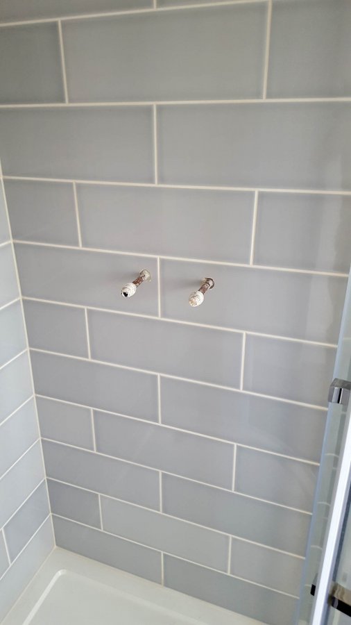

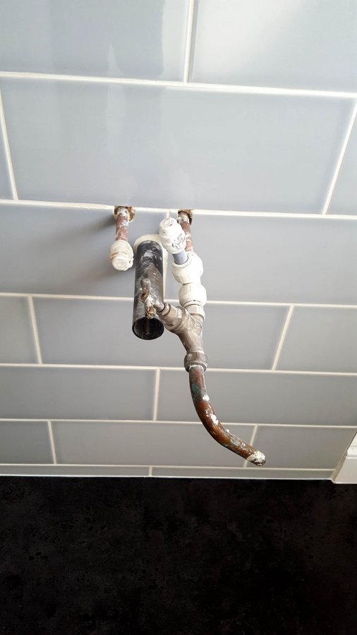

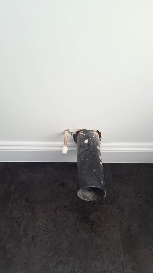

Hi all,
I wondered if building regs stipulate a stop valve on all new bathroom fittings?
We are about to have the 2nd fix done on our loft conversion bathroom.

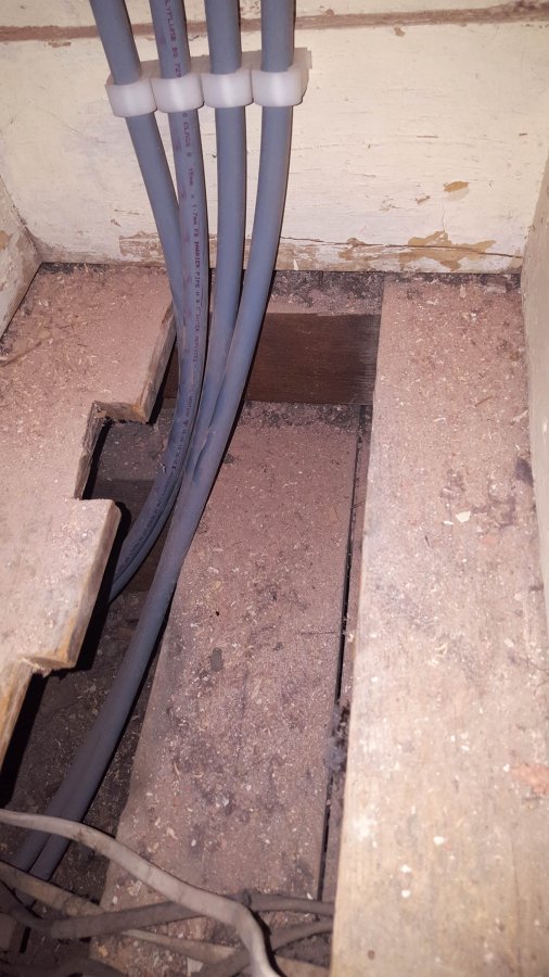

The plumber says he can't put one on the shower as there is nowhere to put it which is true. I asked if he could put one on the pipe that supplies the water to the loft but he says it would reduce the flow and make the shower almost unusable.
The supply to the loft runs up inside a fitted cupboard on the first floor.
The water pressure is very good in the house, so could he not put a wider bore stop valve on the supply pipe inside the fitted cupboard?
Then maybe a stop valve on the sink and toilet?
I've attached pictures.

Isolator valves are so useful for future maintenance......for the supply to your loft, use a full bore lever arm valve and the flow won't be restricted.

thanks for reply John. The full bore lever arm valves I have found online say for use with metal pipes. I think the plumber has used 15 mm plastic pipe. I suppose the must be a version for using with plastic pipe
Its possible to use brass compression valves with plastic pipe, so long as the correct inserts are used to strengthen the plastic.
Much better than the plastic valves, I feel!
John :)
Just make sure he uses copper olives, the proper pipe inserts and doesn't overtighten then all will be fine.

Doing a job @ the moment whereby its impossible to isolate each bathroom unless access panels are fitted or running pipes up and over roof space, basin hot and colds will be valved within vanity unit although shower mixers won't be valved..this applies to all 7 bathrooms.
Certainly come across difficulties in isolating certain appliances due to access, was more the fact that it was said it could be done but not without reducing flow but splitting hairs now I guess. :sneaky:
No splitting hairs Madrab , just letting the OP know that not all sanitary fittings can be isolated.

Their plumber told us categorically it is not possible to put an isolator valve on a shower without reducing the flow. We now have full bore valves on the supply to the loft. Unfortunately the valves he fitted 2 days ago as well as the toilet are leaking.
