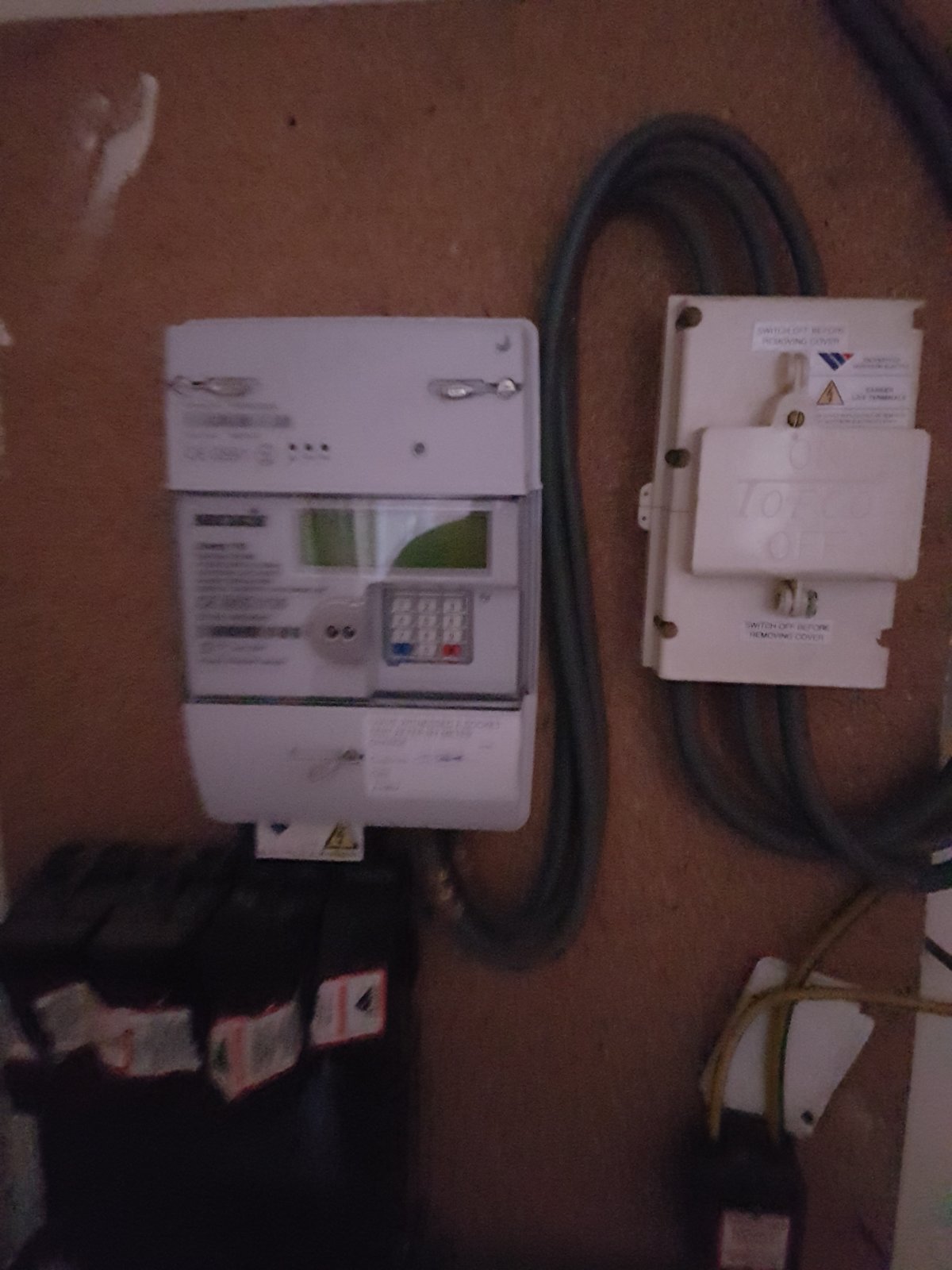

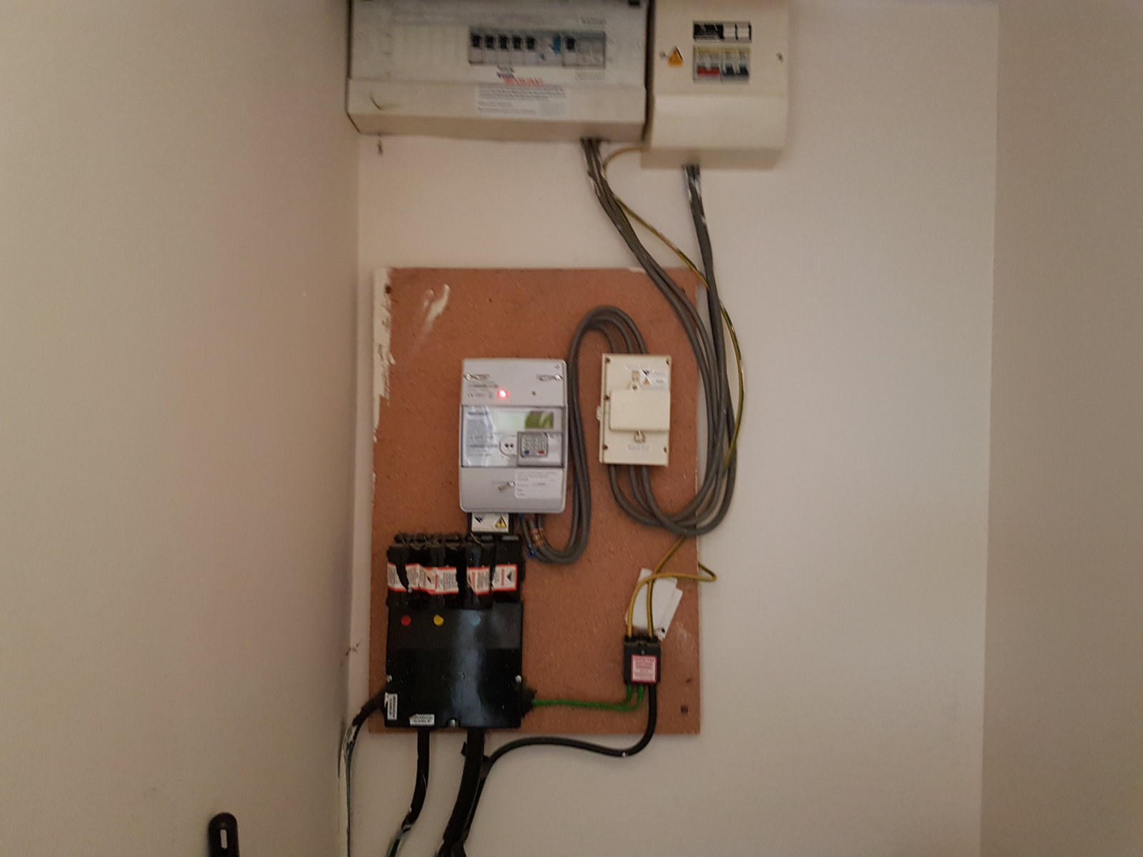

This is meter if any help

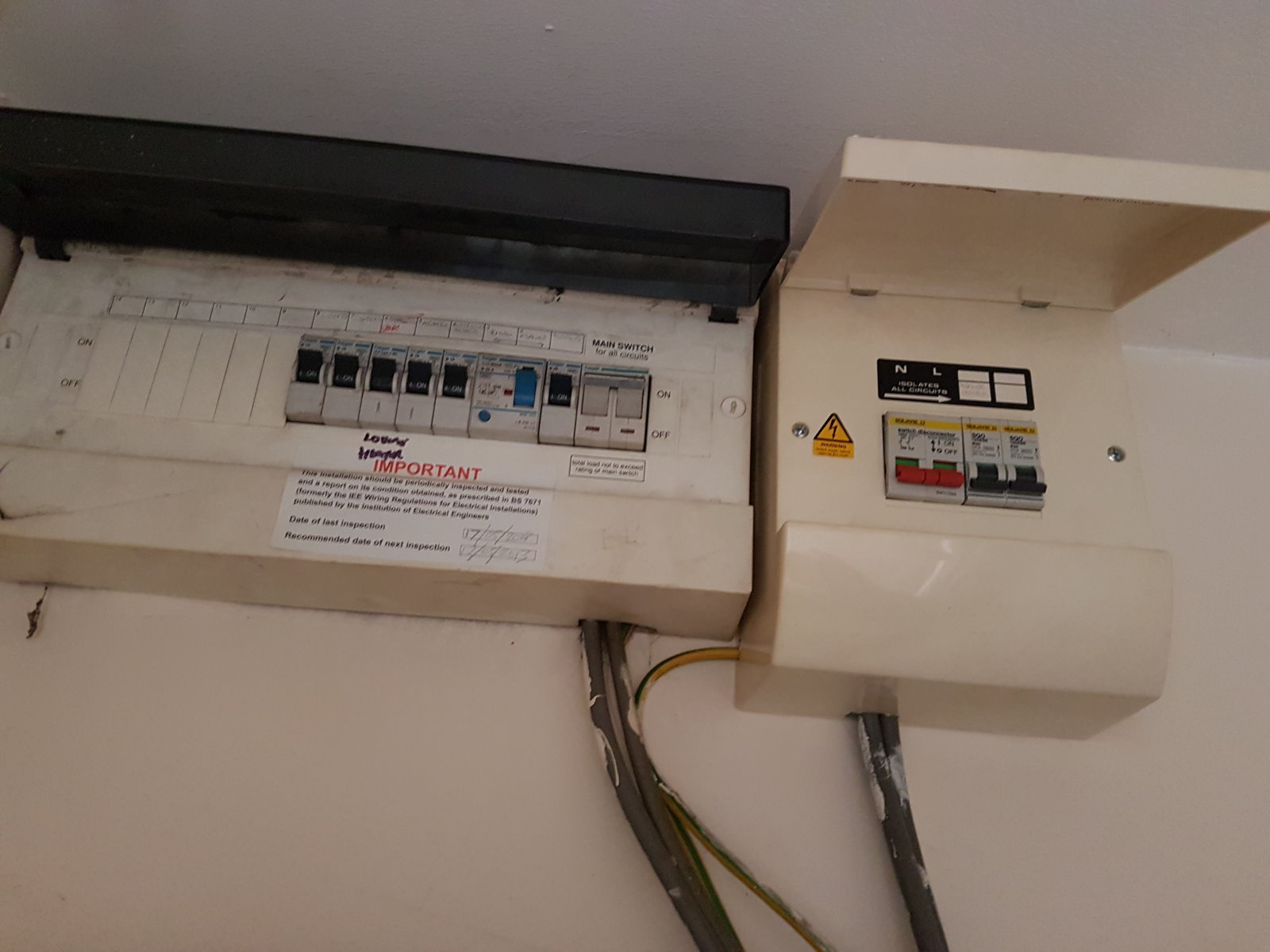

Looks like you have a Pre-payment 'Smart Meter'. You certainly have more than 2 cables leaving the meter which is indicative of dual rate charging - can we have a picture of the consumer unit (fuse box). It is very possible with a 'smart meter' and time switch that you will get the amount of hours of Off-peak electricity every day but not necessarily at the hours you expect (overnight). (e.g. my fathers place has 10 hours a day - typically 04:00 to 10:00 and 15:00 to 19:00 on a radio controlled 'time switch'…)

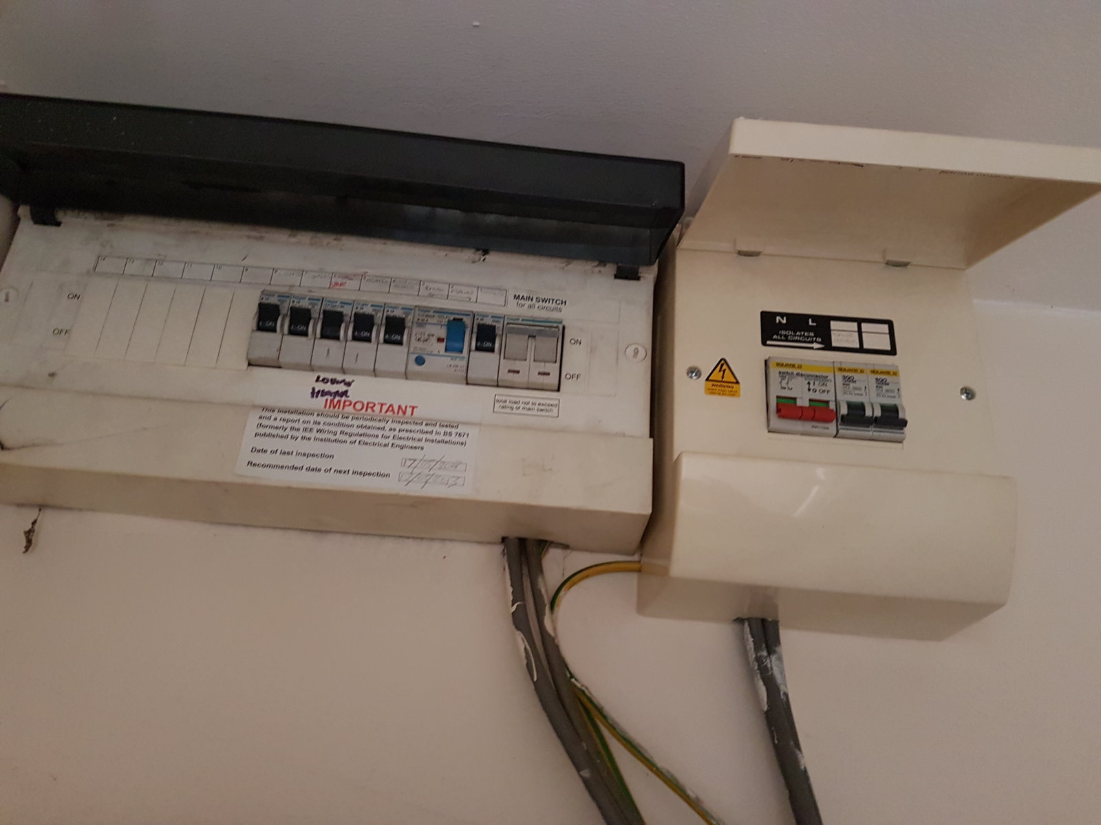

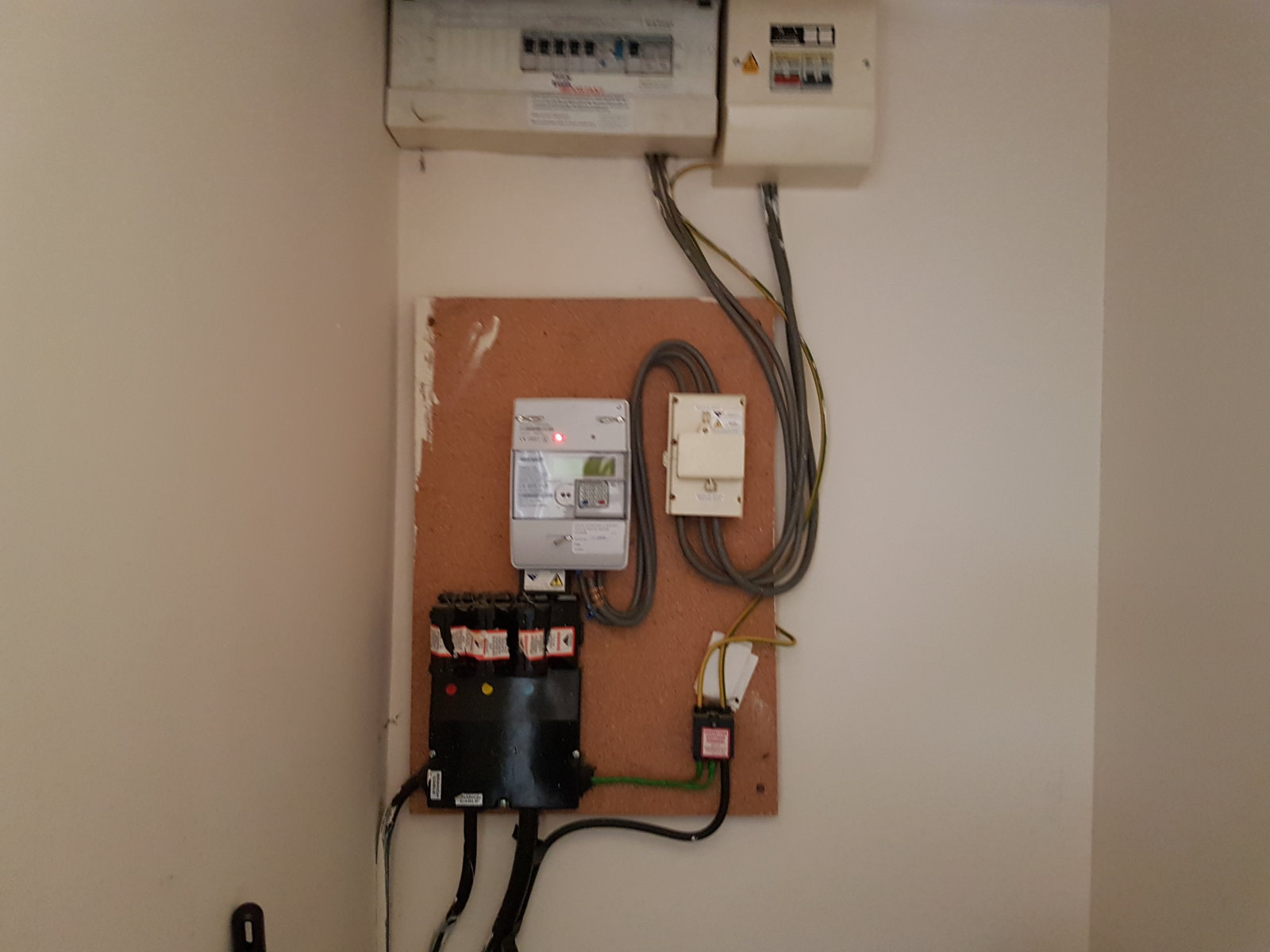

These are all the meters and fuse boxes

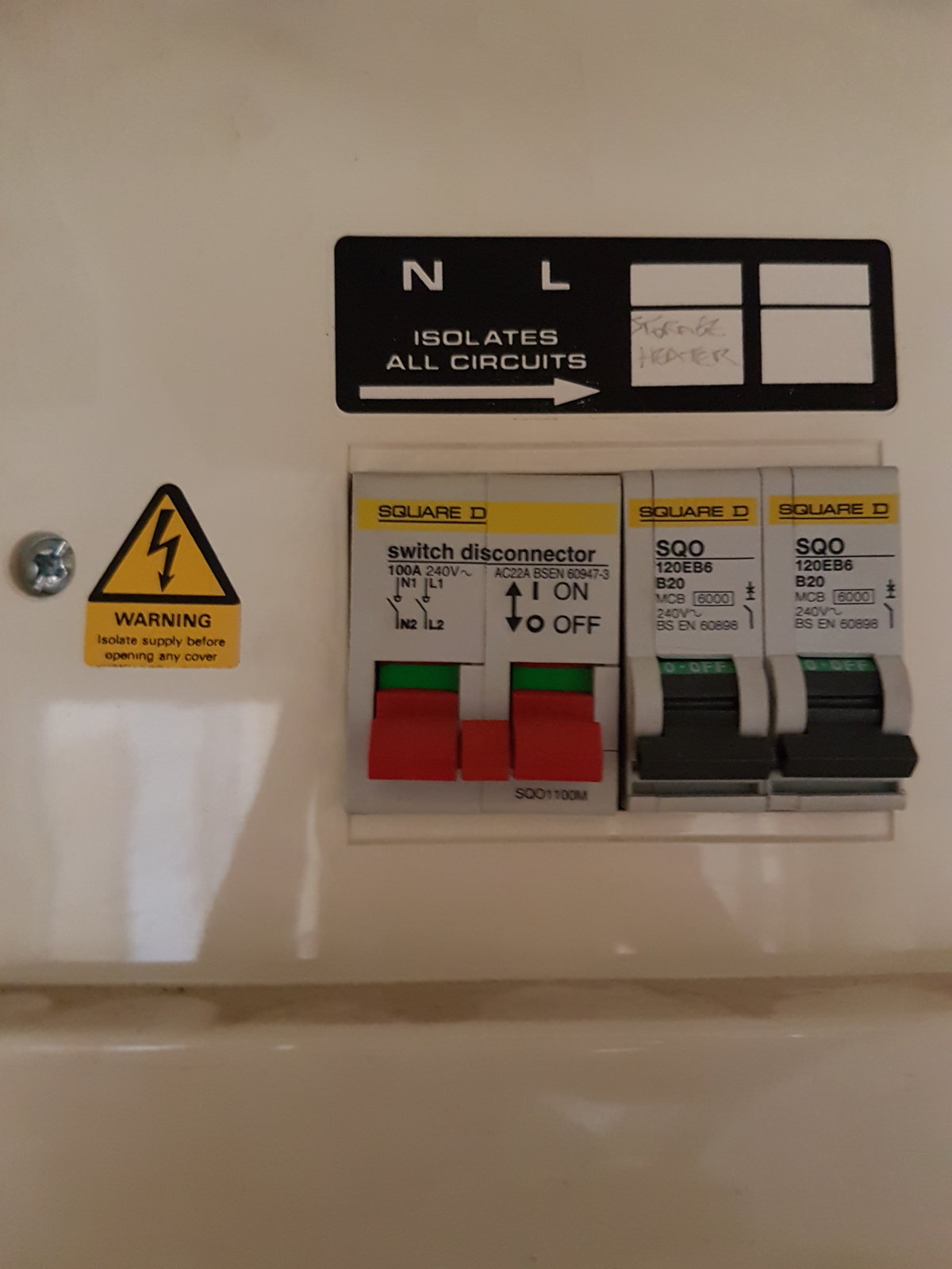

It appears that you do have two separate supplies. The consumer unit on the left will be the normal supplies for your sockets and lights etc., the one on the right is probably for the storage heater(s) and maybe heating the hot water. What is being controlled should be written above the circuit breakers. What does it say?
Turn off the the big red switch on the right consumer unit, and see if the heater warms up now. If not, you do have a separate supply for it, but if it is coming on when it shouldn't that can only be rectified by your electricity supplier.

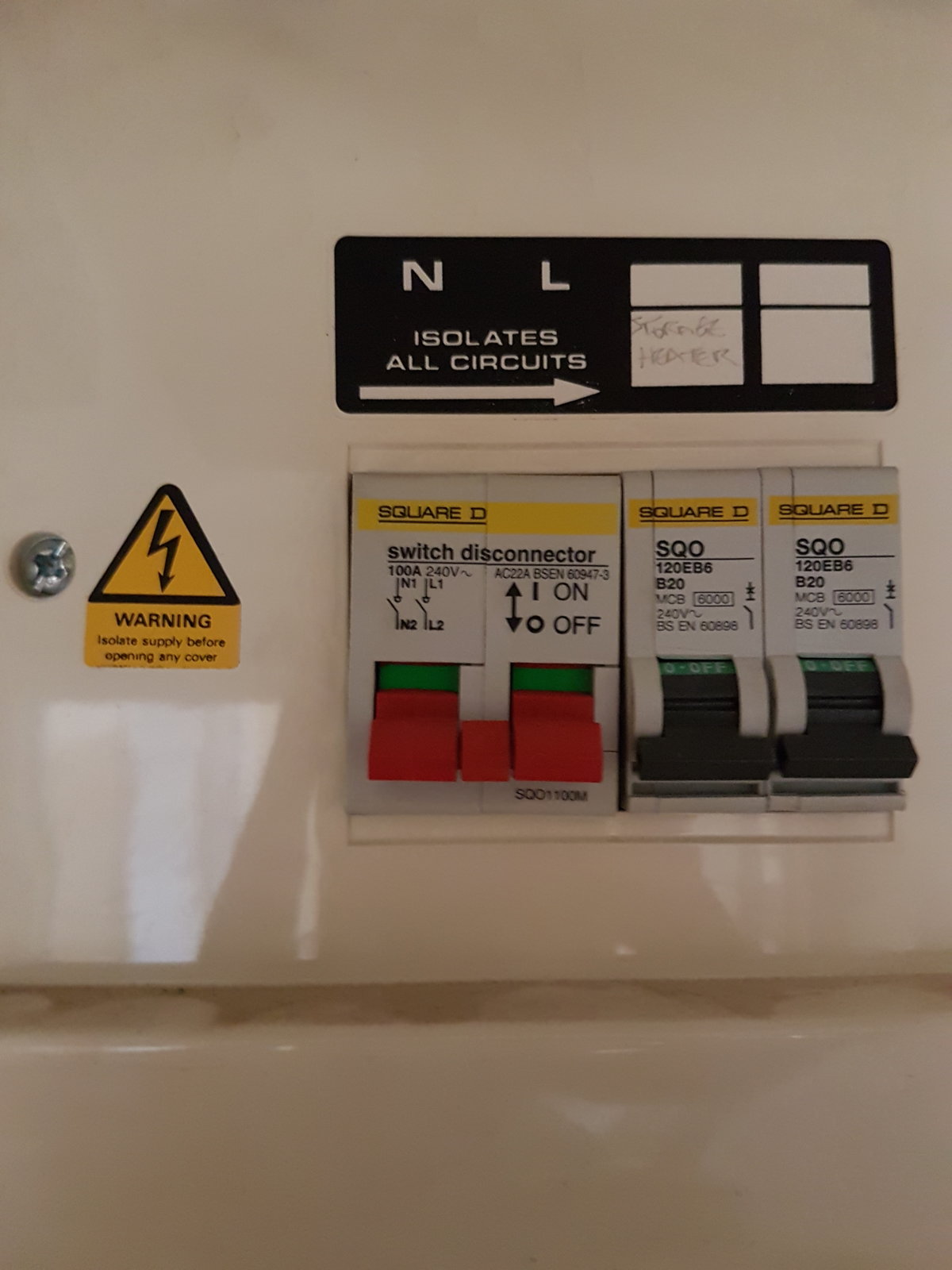

Do u mean this one I think it is off? I've never touched it
That's the one. the clue is that it says "Storage Heater" above the circuit breaker. And you are right, it's off so the heater shouldn't be working.

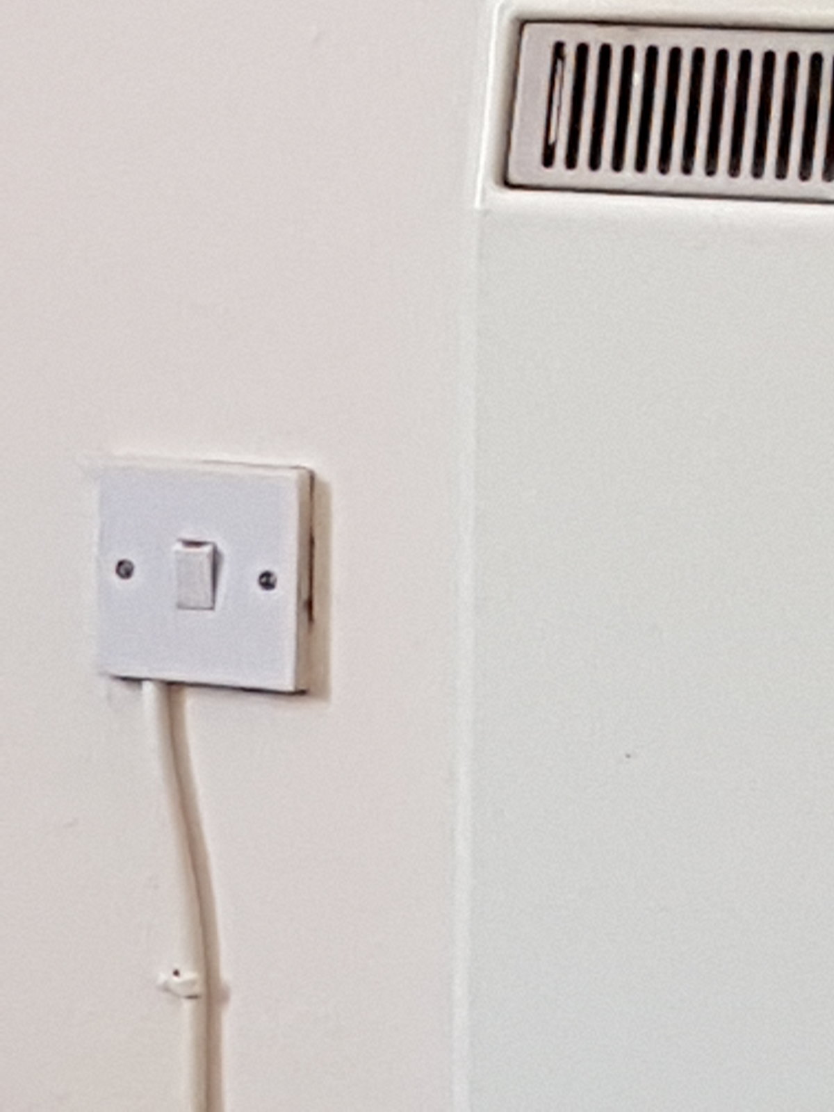

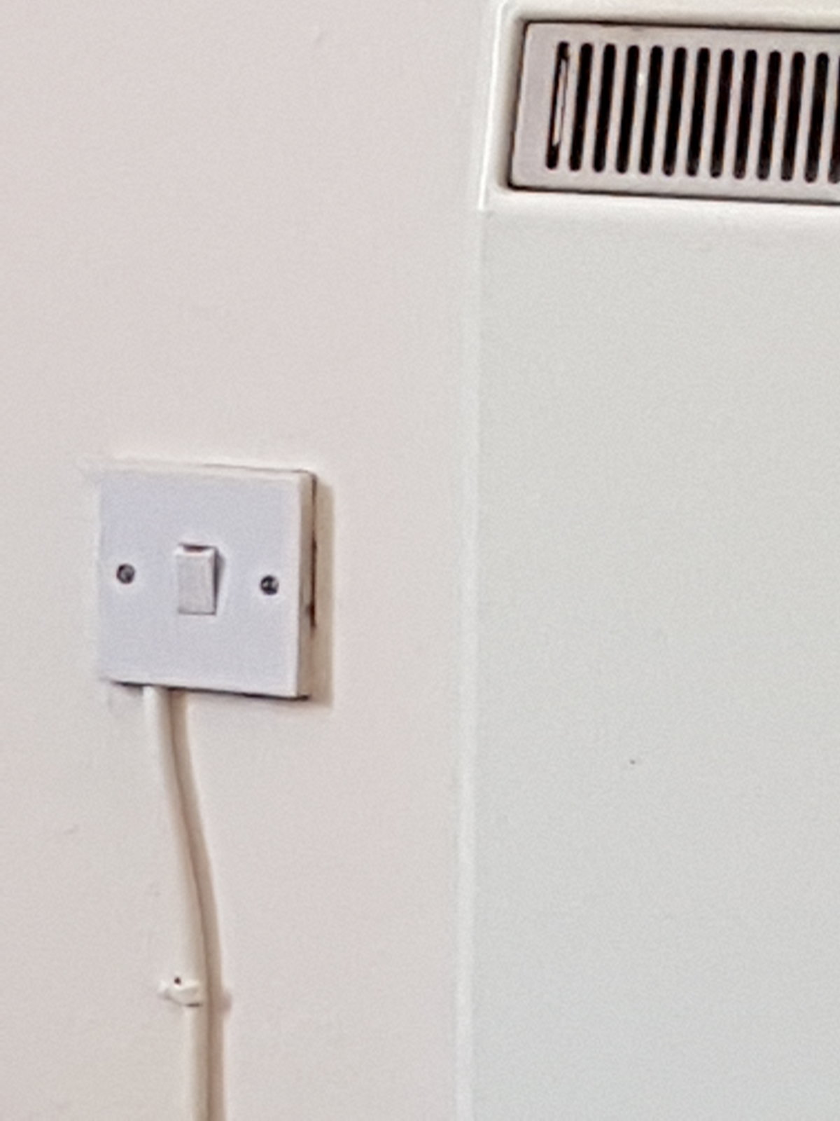

Can you post a photo of the wall outlet(s) for your heater?
Thanks. That looks as it should, so doesn't help unfortunately, and if that's the only supply, then it doesn't have a convector heater built in.
That connection point should not be receiving power at any time whilst the aforesaid supply from the right hand consumer unit is switched 'off' and even if it were switched 'on' it should only receive power during the 'off-peak' supply. So, something seems to be amiss and will need investigation. Unfortunately it's not something that can be done over a forum, it will need someone competent with test equipment to examine the installation and find out what's going on.
