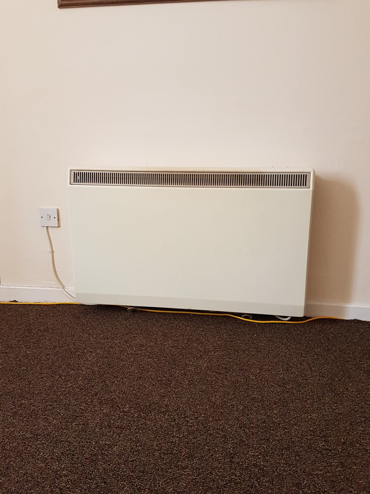

Storage heater help
What if I turn the fuse off on right box and put other one one will that work do you think ?
it's the only switch Tht is next to or could be for heater.
Am not sure if am on economy 7 as waiting for supplier to get back to me would this make a difference as well
The photo looks fine, so doesn't give any clues. There is no inbuilt convector, it is only a standard storage heater. So as the right hand consumer unit to which it should be connected is turned off, it should not be working at any time. So, it must be connected to the left hand one. So as you have discovered it will work anytime but will be using full price electricity.
