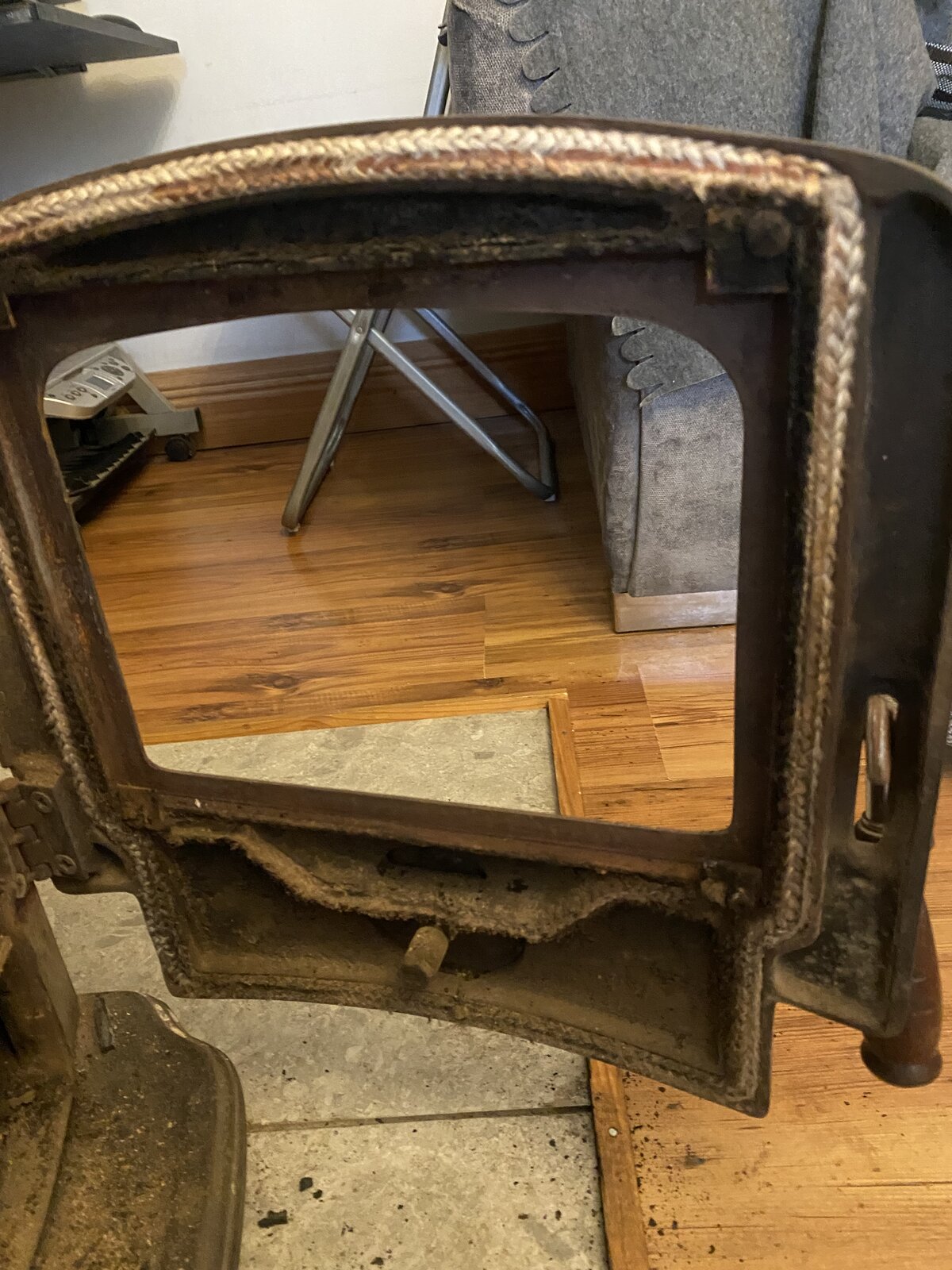

Hi guys. I've to replace the stove glass on the Stanley Oisin
Stove is old and I had to drill some of the screws out last time
What's the best approach to remove the screws . Should i tip the stove on its side so the door is flat on the floor and apply release spray to the screws ?
Thanks for any ideas
Ex Stanley agent here
As above new sealing rope needed.
Door off always replace all screws drill out tap out as needed. Clean up carefully with rotary wire brush .
Rebuild.
Rebuild.
So new door rope and glue yes ? I've done that before so no problem
When you say replace all screws you mean the glass retaining screws only ?
Also will the door usually come off easy enough. would you use an impact or release spray on the door screws ?
Thanks for all the advise
Hmm so the door screws were easily removed and I can see the sealing rope is 12mm
My only remaining concern is how do I tighten the glass correctly
