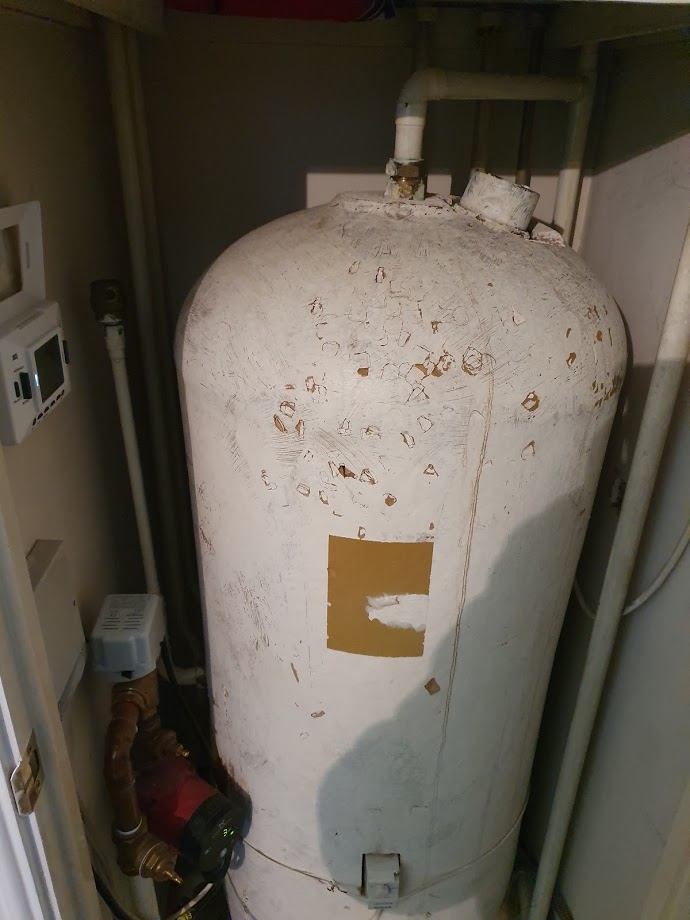

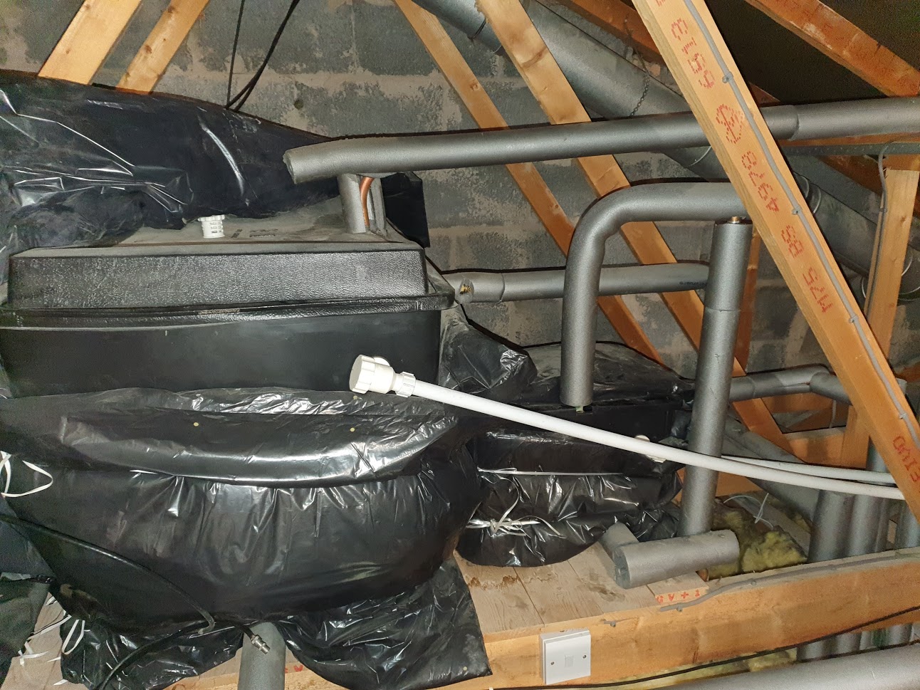

thanks oldbuffer! i've just taken a few photos. there are 2 tanks in the loft (a large one and a small one). both seem to be working ok in that they're full of water and if i move the ball cock water comes into both tanks...
The F&E tank should NOT be full of water. With the system off and cold(ish) it should have about 4 inches in the bottom. As the name suggests, it is there to feed water into the heating circuit, and handle the expansion when the water heats up. If its full with the system cold, any expansion that goes into it will disappear down the overflow.
The pump looks quite new, so probably not the issue.
Sounds very much as if the feed pipework is blocked. This also ties in with the fact that there's no air or water coming out of some radiators when you bleed them.
The blockage is usually at an elbow and / or in a horizontal section. You could try running a magnet over the copper pipes. If its attracted to the pipe, there is likely to be some haematite in the pipe (from the inside of your radiators) and could well indicate a blockage. Central heating cleaning chemicals won't touch a complete blockage (no circulation), so cutting out and replacement is the only realistic cure.

not the answer, I too think you have a blocked cold feed, only way to sort it is to cut it out , as already suggested see if a magnet attracts to it

There may very well be , but that wouldnt stop the rads from bleeding, only a blocked cold feed will do that if the F&E tank has water in it
