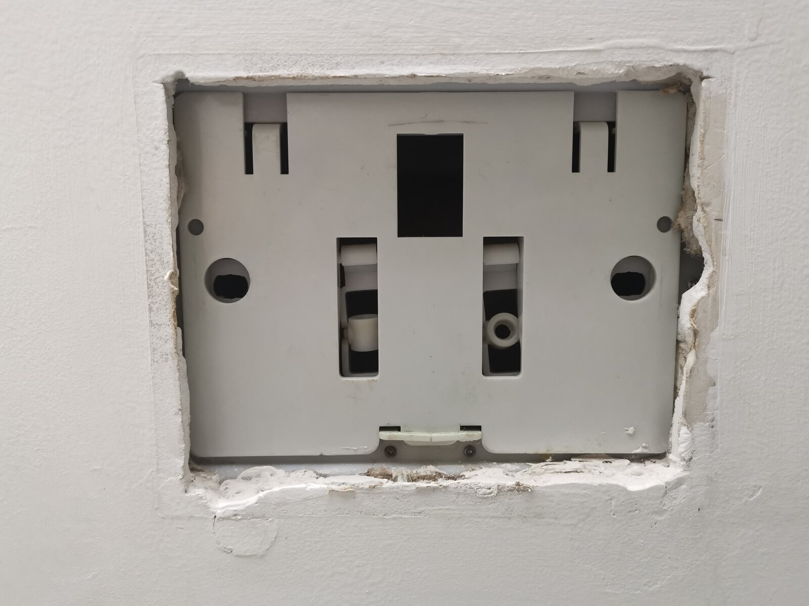

Hi All, these forums have been really great in the past with some plumbers really helping me out, and I've now got another problem.
The house we moved into last year has the cistern enclosed in the wall It intermittently, when flushed, makes continuous noises that occur every few minutes and last for approx 5 seconds each time, that sounds like the cistern is starting to fill up again......?

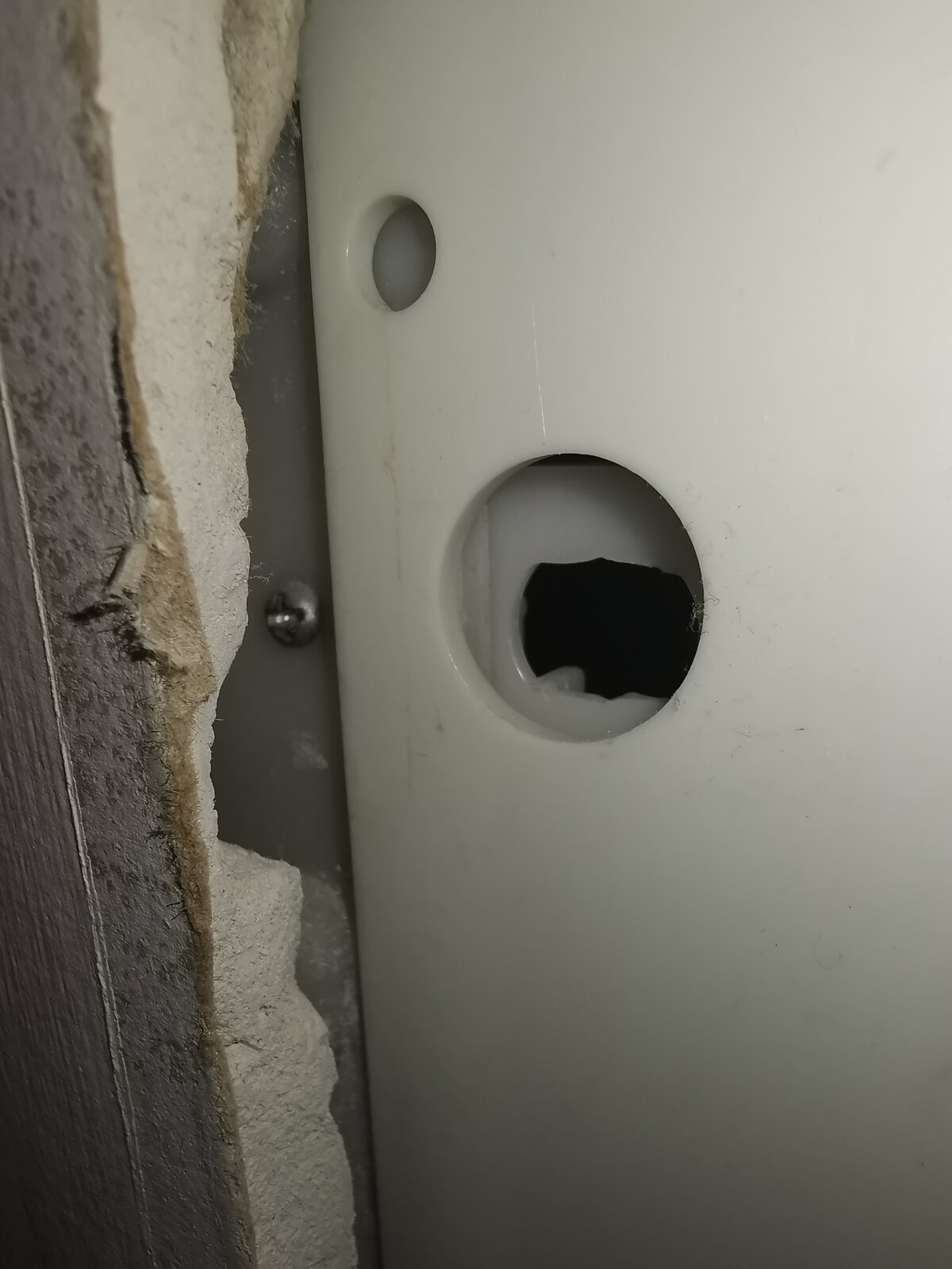

To get over this problem, we had to keep pressing the chrome plastic push plate very slightly, and it would sometimes stop, however in the process the chrome plastic plate broke, I removed the plate from the wall, to find one of the metal springs behind had broke down away from the plate. I also noticed that the backplate had cracked where the Gyproc board is flexing......
We also can't identify the make of the toilet to get another push plate, ive taken it to a plumbers who are very good but we're unable to identify it.
So my question is what do we do now?
Its an ensuite bathroom and we keep getting woken up by the noise from the toilet when it starts playing up through the night with its refill sound!
Do I need to open up that wall and then see where I can get back to with a standard fitting I. E find a part that's a standard part that I can then start to rebuild it from ?

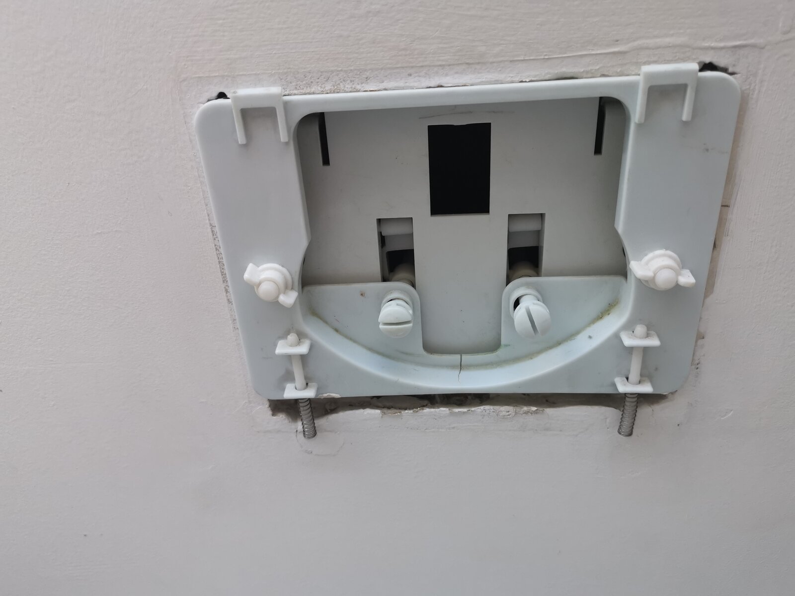

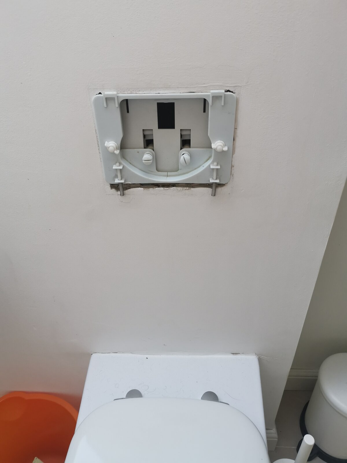

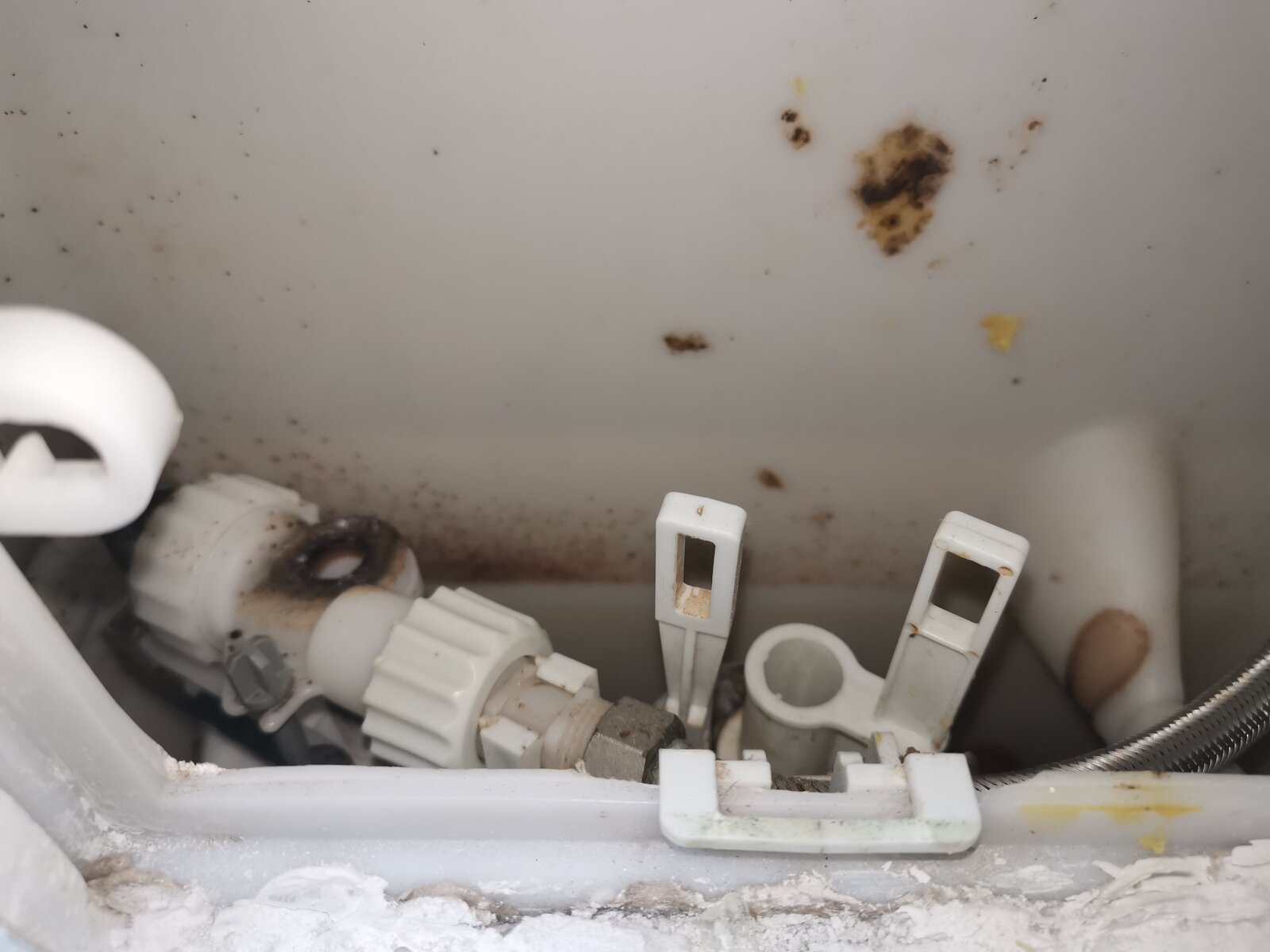

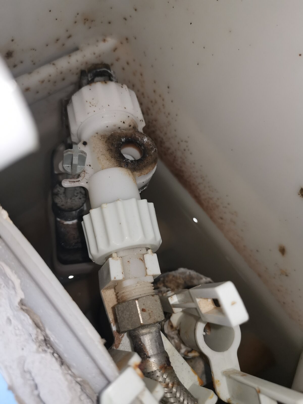

Any photos of chrome front plate or perhaps the cistern internals, eg lid, float valve?
Hi Chris many thanks for your response mate.
I took the plate into work around 6 months ago to see if they could fabricate me one out of metal and haven't seen it since, think they've lost it. It had two push buttons on the face but didn't have ANY identifying features on it.

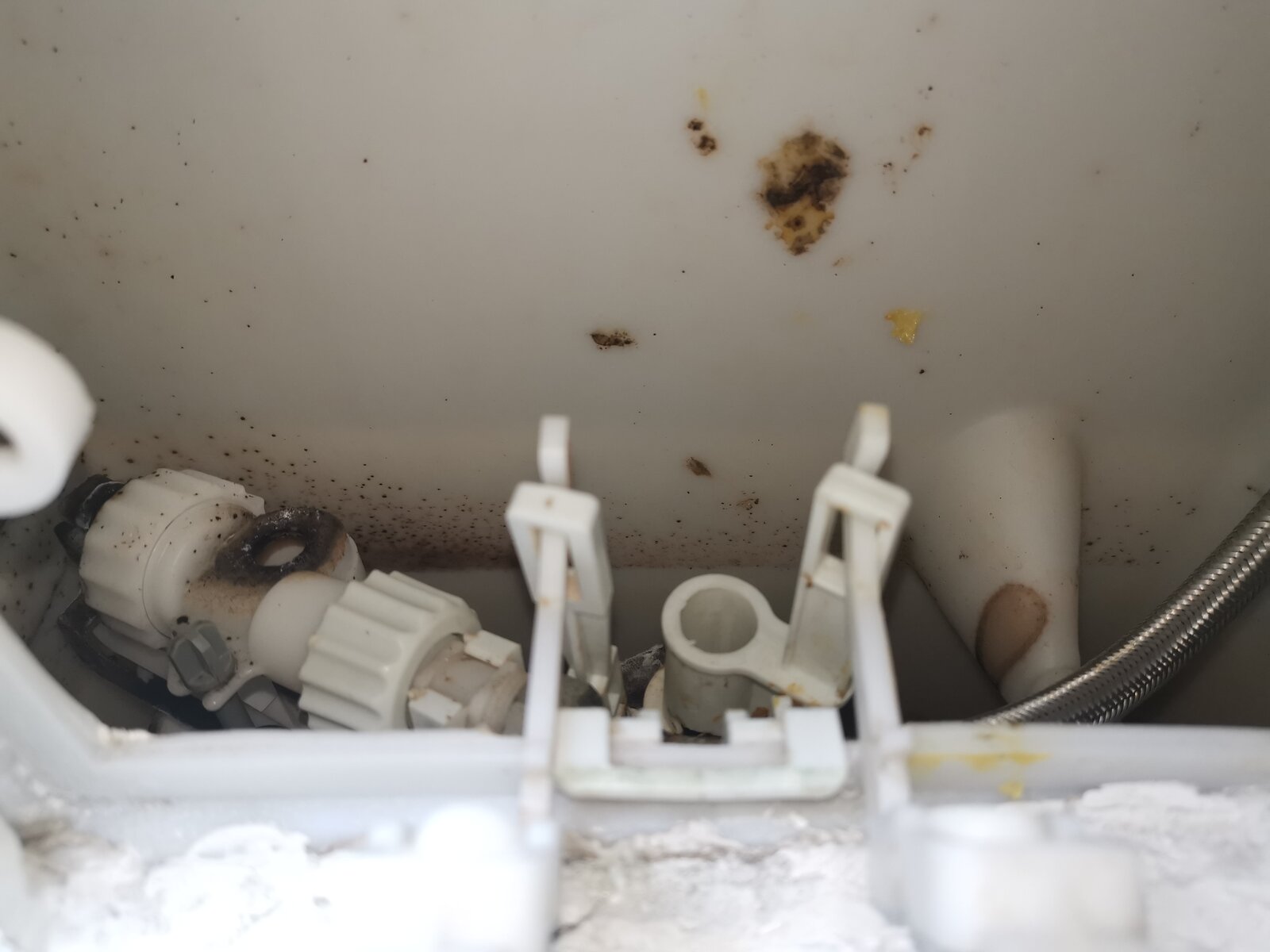

As for the internals, I think those long plastic threaded screws/push rods unscrew and can remove the plastic plate from the wall, would that be any good if I try to stick a camera down there inside the wall?
It might work, just need something to try and identify it. I think the wing nuts undo, and perhaps the two screws going into it.

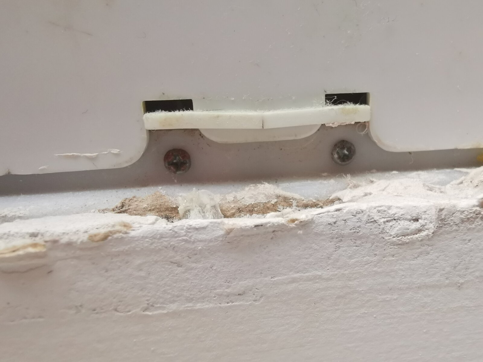

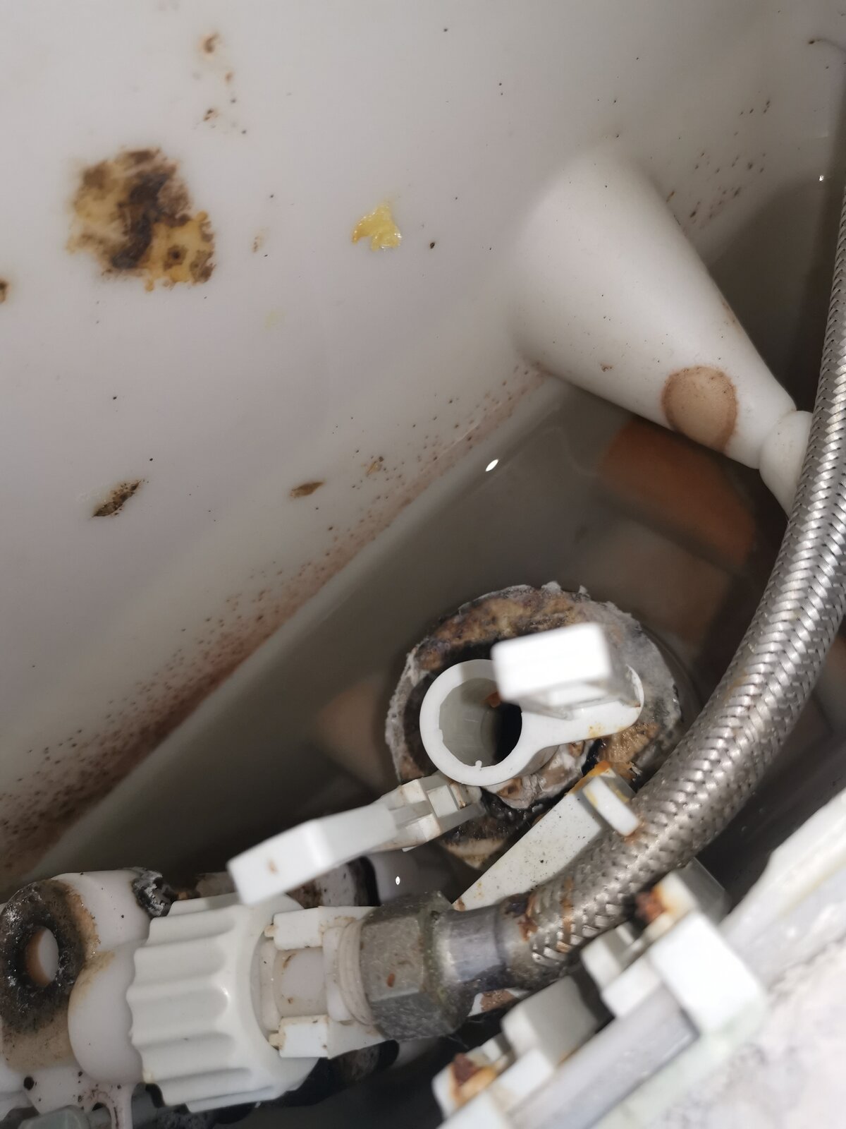

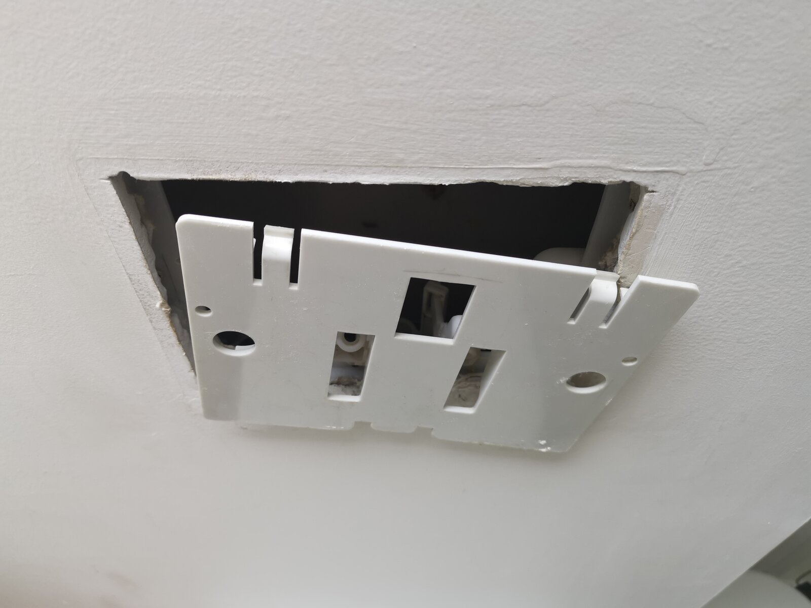

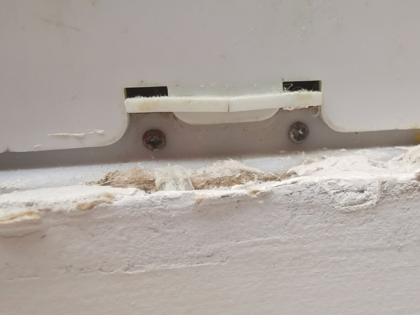

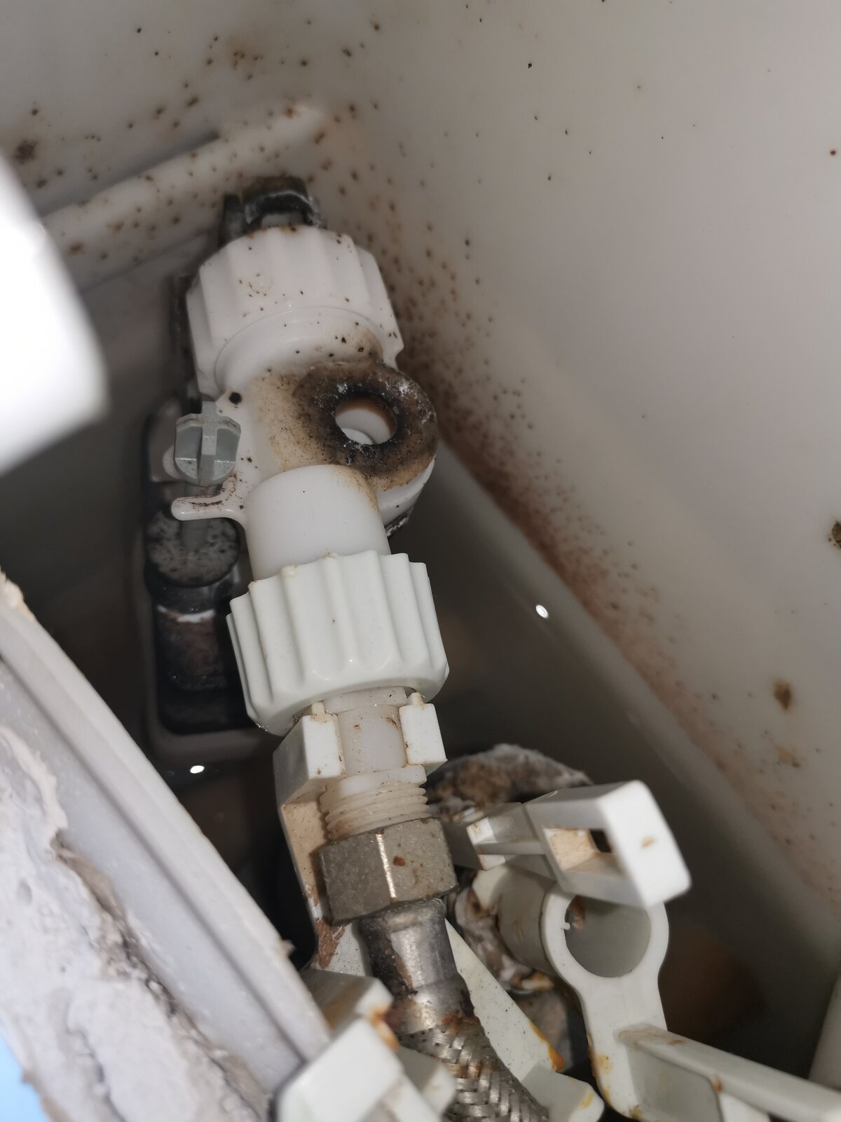

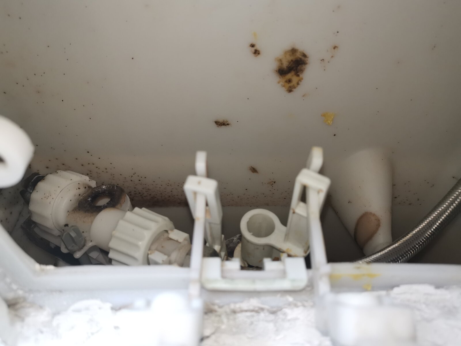

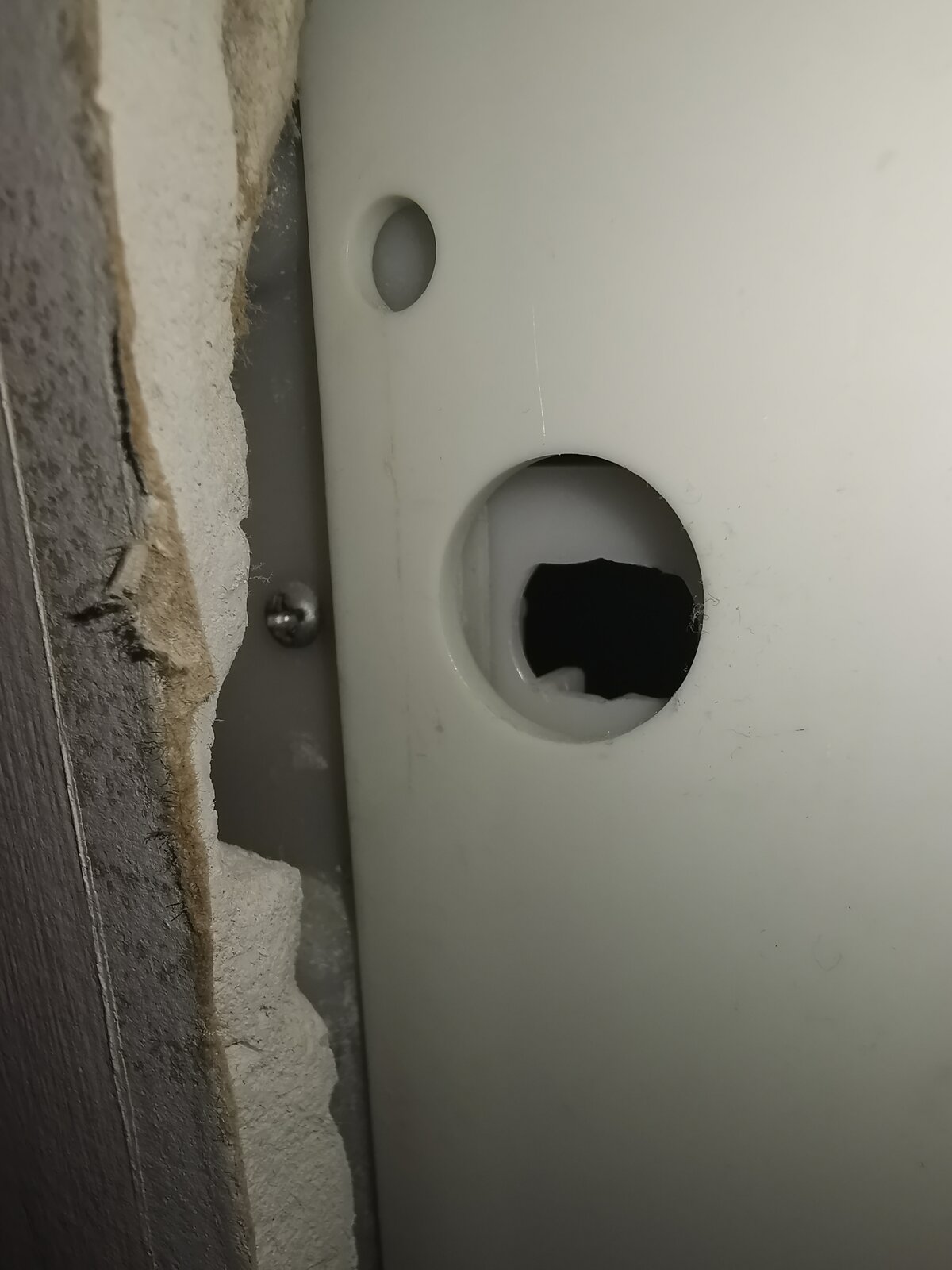

Hi Chris I've taken the rods out and the front plate but now stuck with this?
There's about 2mm movement upwards and it not enough to clear the tab at the bottom?

If it's constantly topping up, then the syphon is passing. The missing operating plate is a secondary problem.
Hi Harry what does thst mean in leyman terms? :)

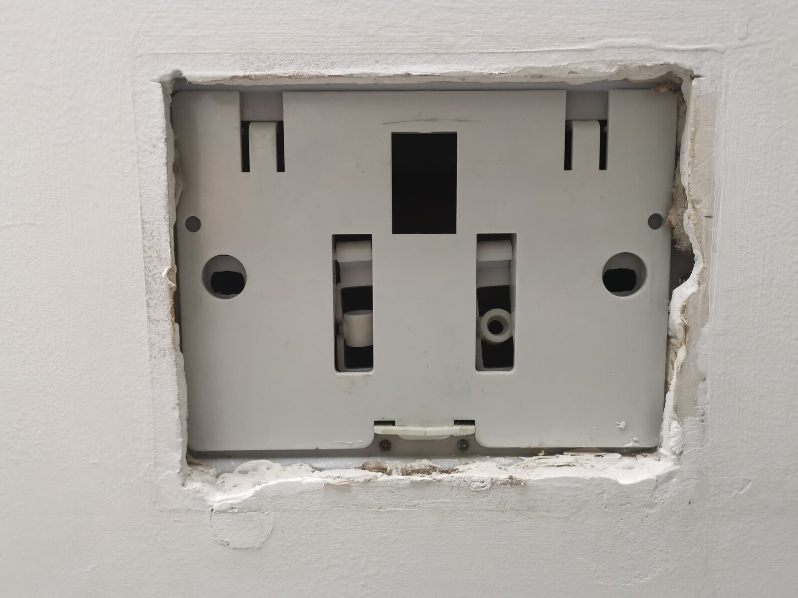

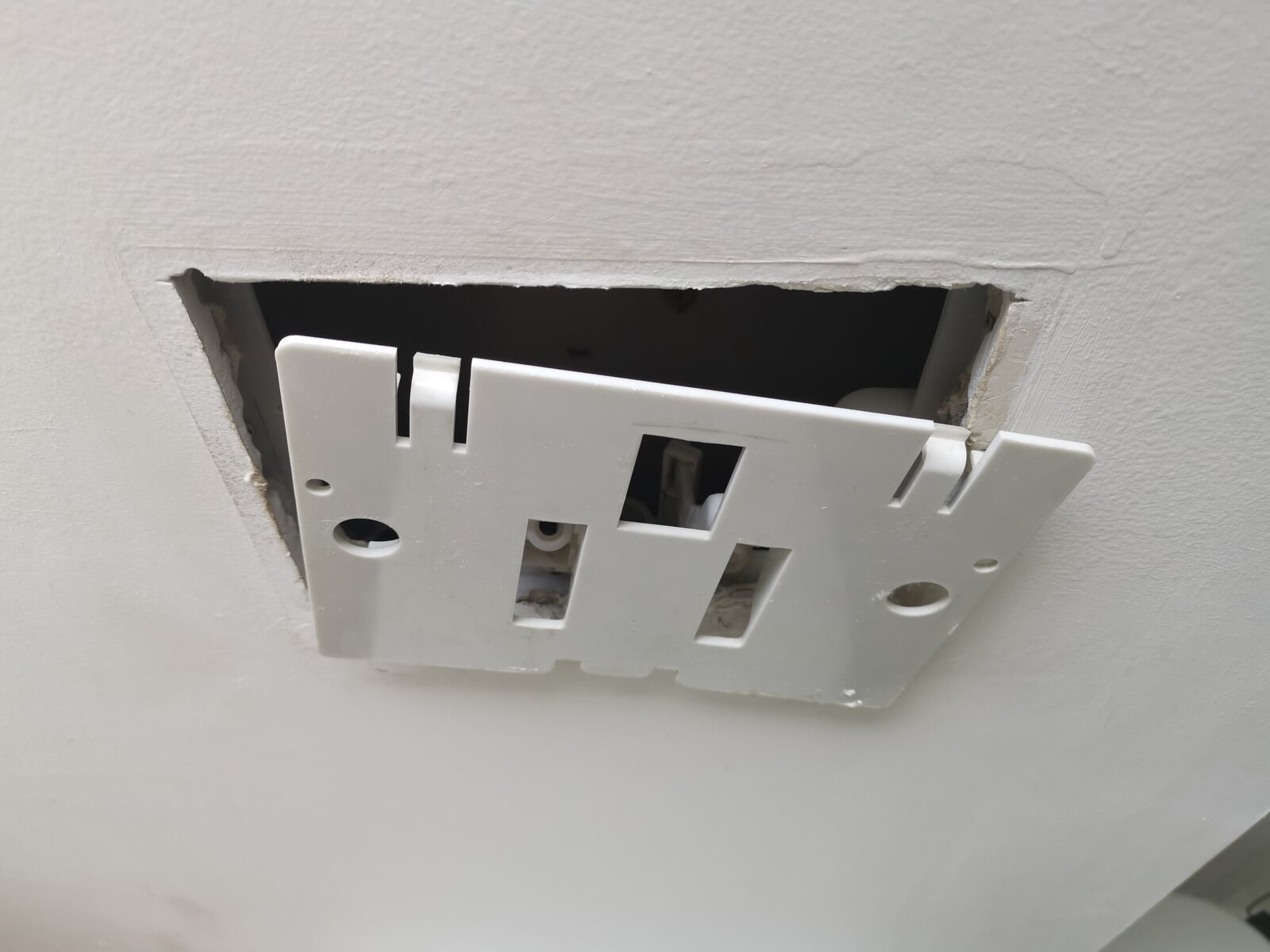

I've got that plate off and another photo below?

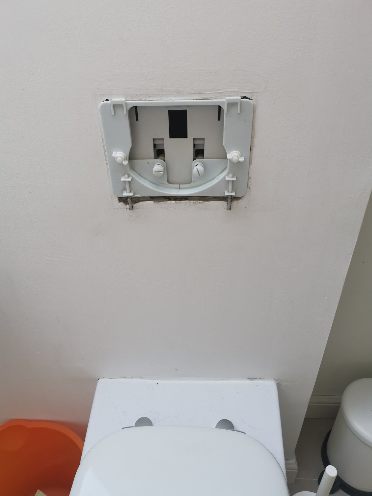

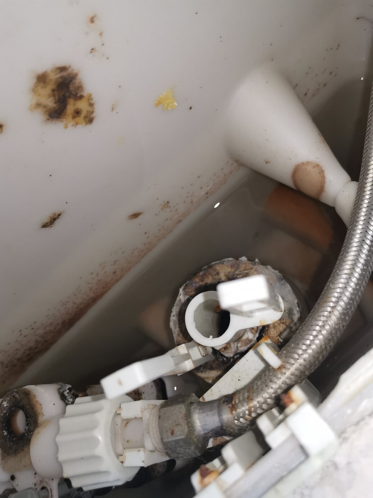

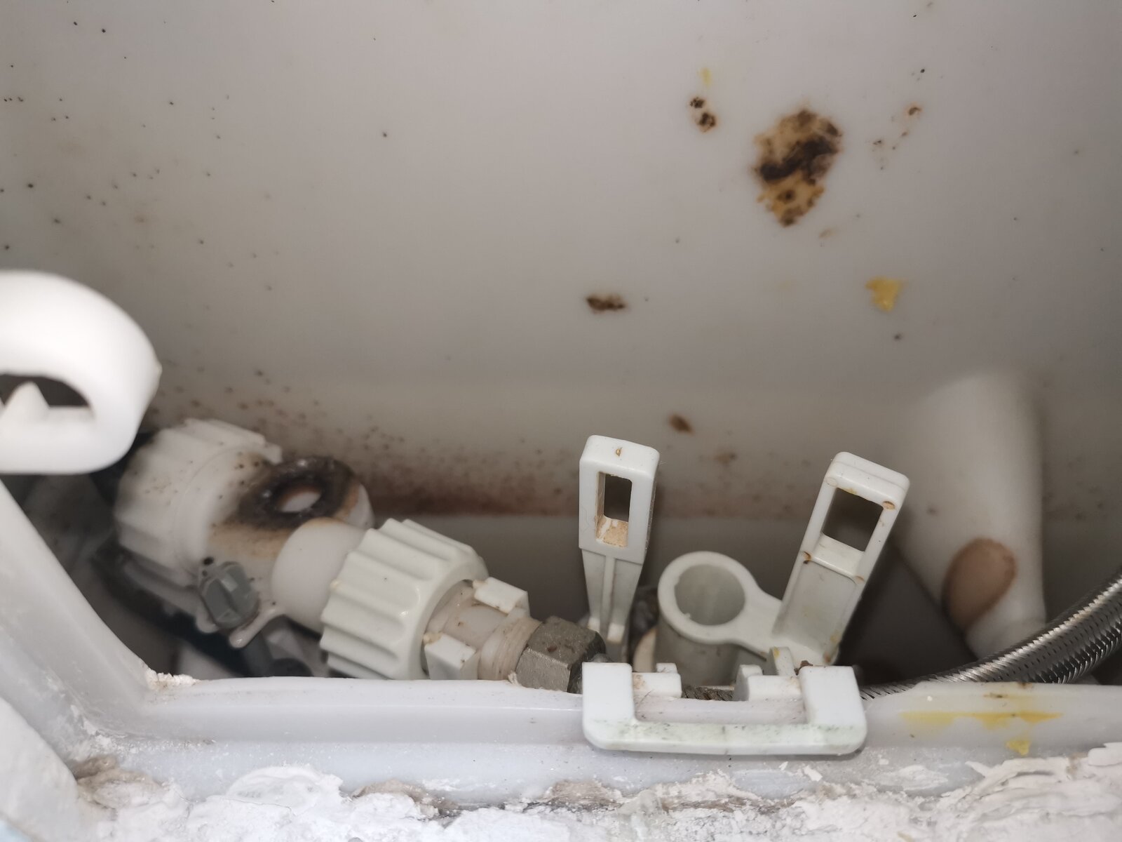

I've taken another couple of photos here

After filling up, check the toilet pan, if it’s trickling it’s wither the siphon or flush valve. The filling valve is a Siamp, so likelihood is the siphon is as well. It might twist out, many like that do.
Hi Chris defintely no trickling in the toilet when it makes that noise and once the toilet fills up there's no trickling either.
Did you have a chance to watch that video? I don't know if you can hear that very faint noise before the main noise starts?
It means the flush syphon is constantly allowing water to leak out, into the bowl, so as the level drops it fills up again. Another possibility is that the water level is set too high, it fills, overflows, then refills - but I favour the first cause.
Cistern: Siamp Intraslim B concealed cistern
If no water trickles/seeps into bowl with the water to the cistern shut off and cistern full (check carefully, blue paper on walls of bowl ) then it's the inlet valve: Siamp 95L
If so it will be the inlet valve diaphragm washer. May be
easier to replace the whole valve .
There should be a quarter-turn shutoff on the other end of the braided inlet hose.
