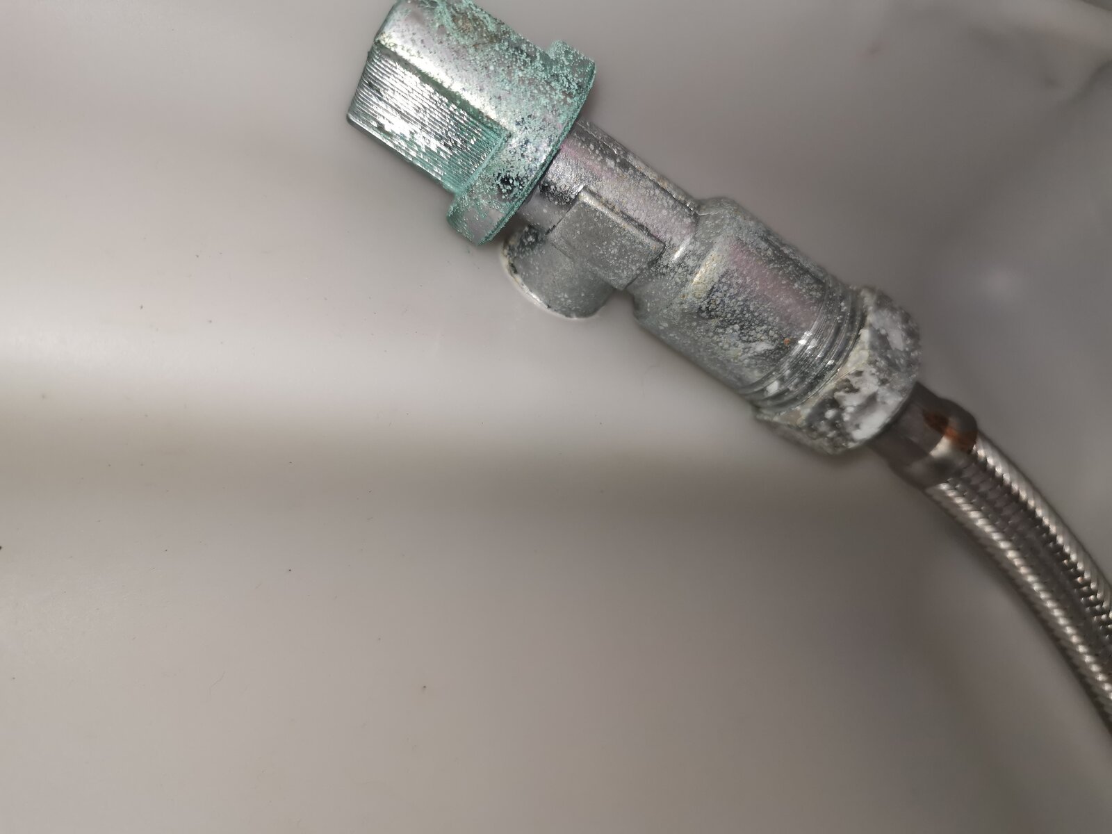

Hi mate OK what part of that braided hose joint do I turn to turn off water? (picture below)
Well, I can only guess that the tacky plastic cap is meant to be turned clockwise to close.
Whether it does so readily after years of disuse is another matter.

I've tried turning that valve on the braided hose and it does shut off the water.

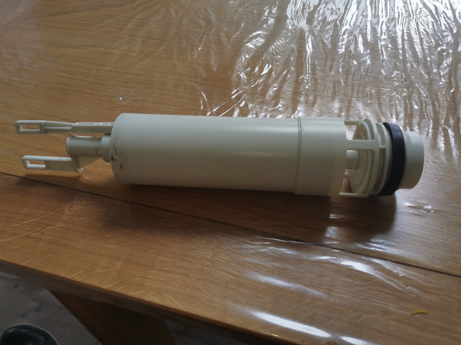

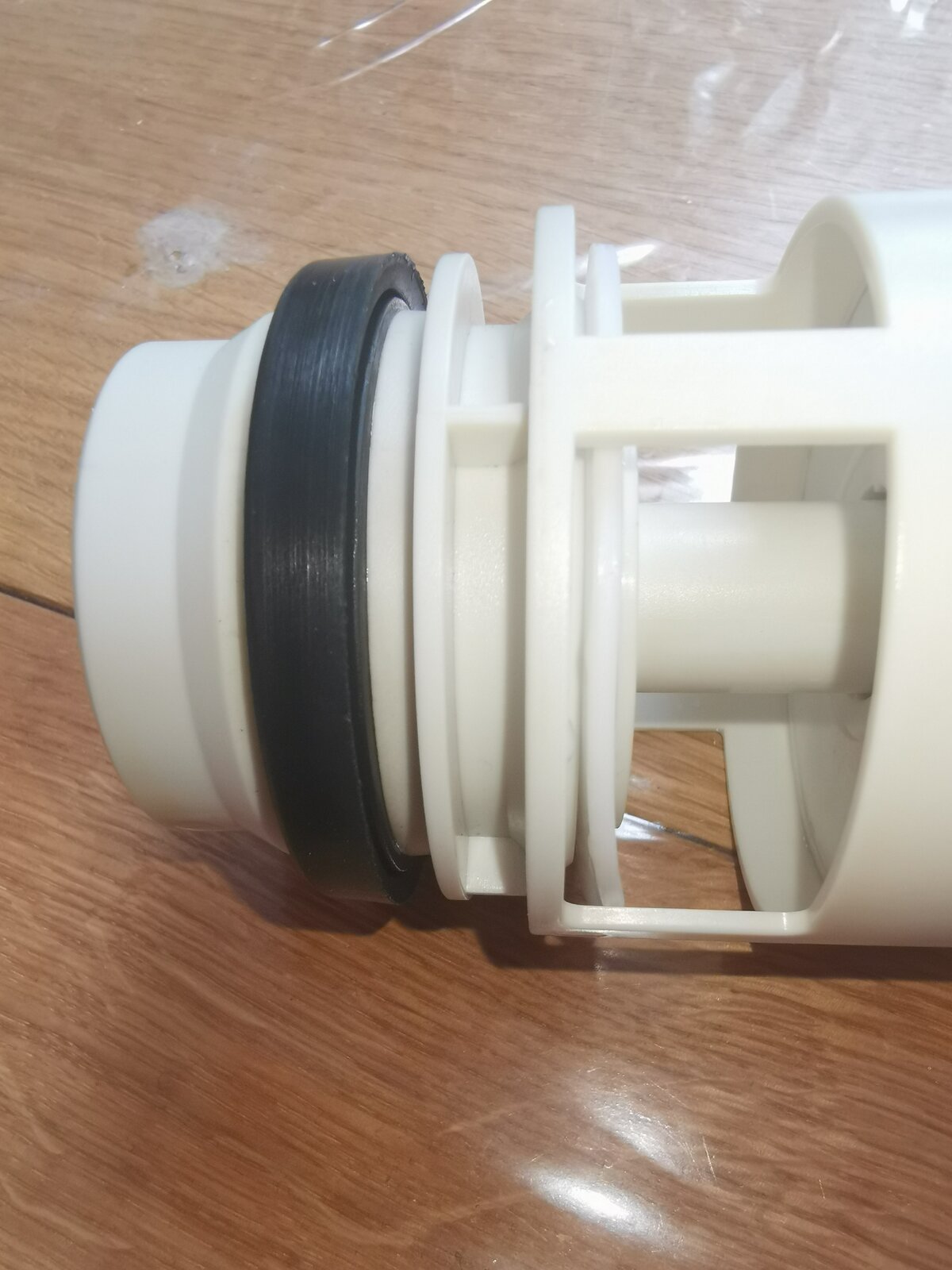

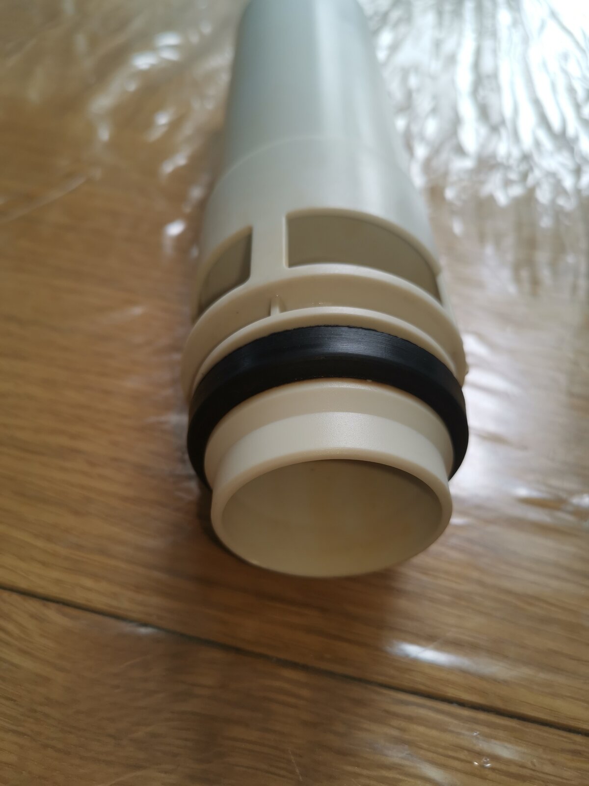

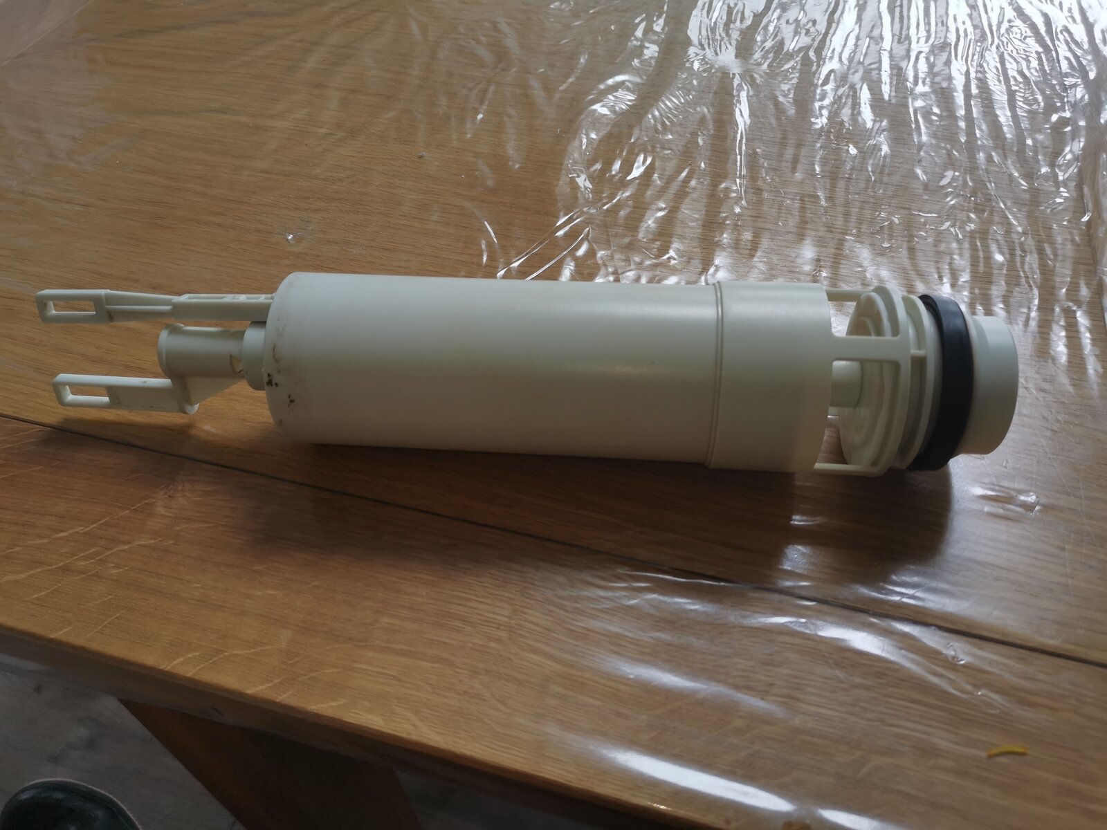

Hi Guys, the noise started again and I've found the problem. Ive removed the flush valve and what happens is, it's very intermittent, maybe once out of every ten flushes and the bottom seal goes like that in the photo, let's a small amount of water through, and then the cistern starts filling very slightly as the water level drops.
My question is this.

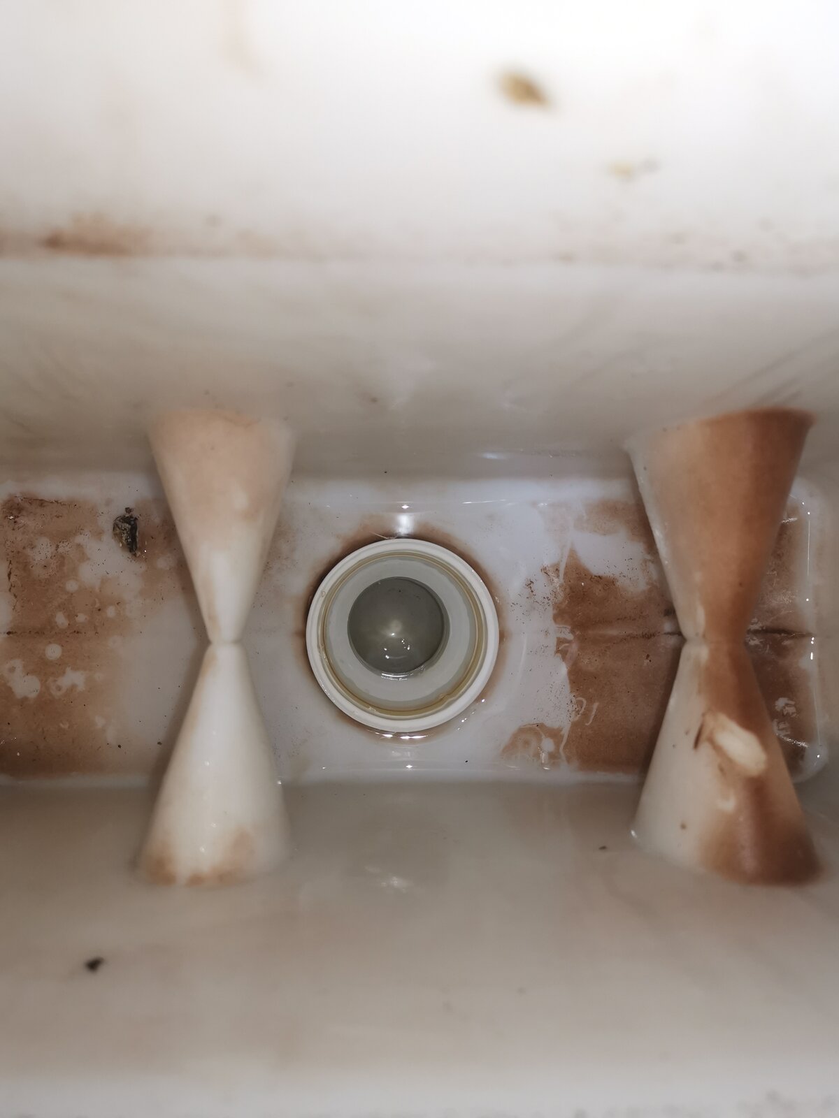

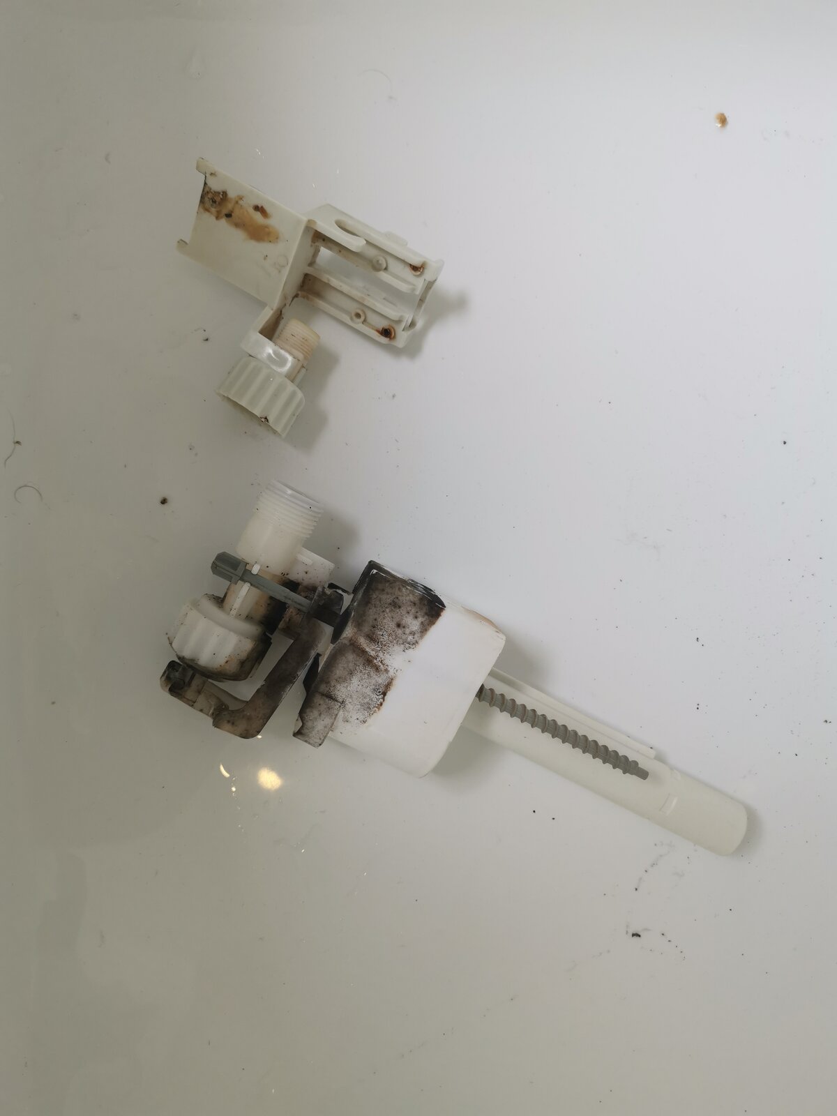

Are these flush valves inter changeable? Can I replace this Siamp flush valve with a different type/brand? Or am I stuck with Siamp? I've also attached a photo of the inside of the cistern.

Afaik, Siamp to Siamp, not Siamp to a n other.
