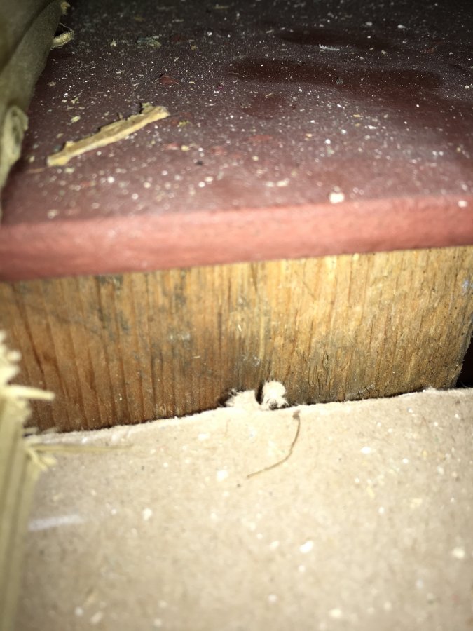

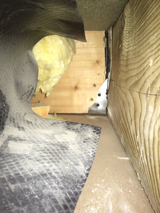

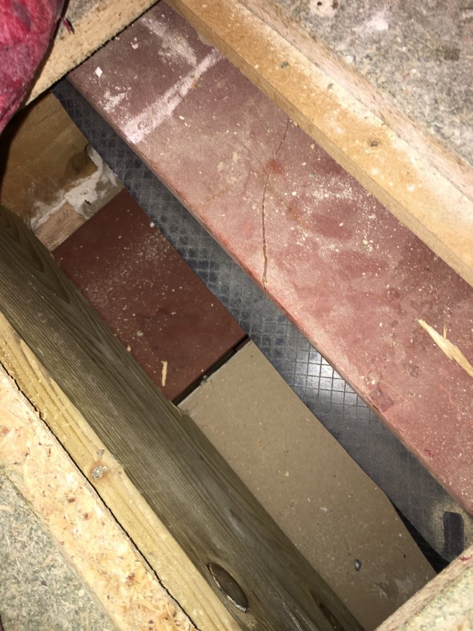

There is a floor board that's extremely creaky that I've just had a look at and there is a approx 20x30cm hole cut in it... I've had a look and took the following photos. Does this mean anything to anyone? I can see a crack along the beam that doesn't look good and where that metal part is doesn't look at a right angle...
If you need any more context to the photos let me know. Thanks again for all your help, definitely feel like I'm getting a better grasp of the different things that might be causing the problem

The joist in the first photo isn't tight enough in to the hanger, and is very likely allowing the movement; packing this out night help. I normally cut a channel in to the top of the beam, and take the joist hangers over the top to give a bit more support, but this is just personal preference.
The crack in picture 2 doesn't look to serious, and shouldn't cause any serious issues - I assume that this is the crack you're referring to.
Picture 3 doesn't seem to suggest anything. Is there double plasterboard around the RSJs, or at least fire rated plasterboard to give half hour fire rating.
The crack I was referring to was in the first photo, on the beam to the right of the image.
How serious is the joist not being tight enough and how difficult / expensive would something like this be to fix?

How long is the crack, and does it go through to the other side. Is this the beam that holds up the wall above it that's got the problems, because if it is, then you've got some upheaval to get to it, and then either strengthen or replace it, but I suspect you're going to have to lift the floor at some stage.
As to the loose joist, you may be able to set up a couple of wedges using a hard wood rather than pine, and then wack them into the gap with some glue to keep them in place.

The beam with the crack in it runs parallel to the wall that has the cracks from the corner of the door frame (it's about 40cm away) and perpendicular to the RSJ. It's also perpendicular to the wall with the door that sticks. It's about 30cm long that I can see and is much thicker by the joist.
By other side do you mean all the way through the beam, or the other side of the joist? It looks like it goes to the other side of the joist, but difficult to tell if it goes through the whole beam without lifting another floorboard.

The lower rsj will span the original wall that was removed, so work from there please. The rsjs in the second photo look okay, so the main question, is what is causing the deflection in the ceiling below, and are the walls in the room above, actually resting on anything solid.
