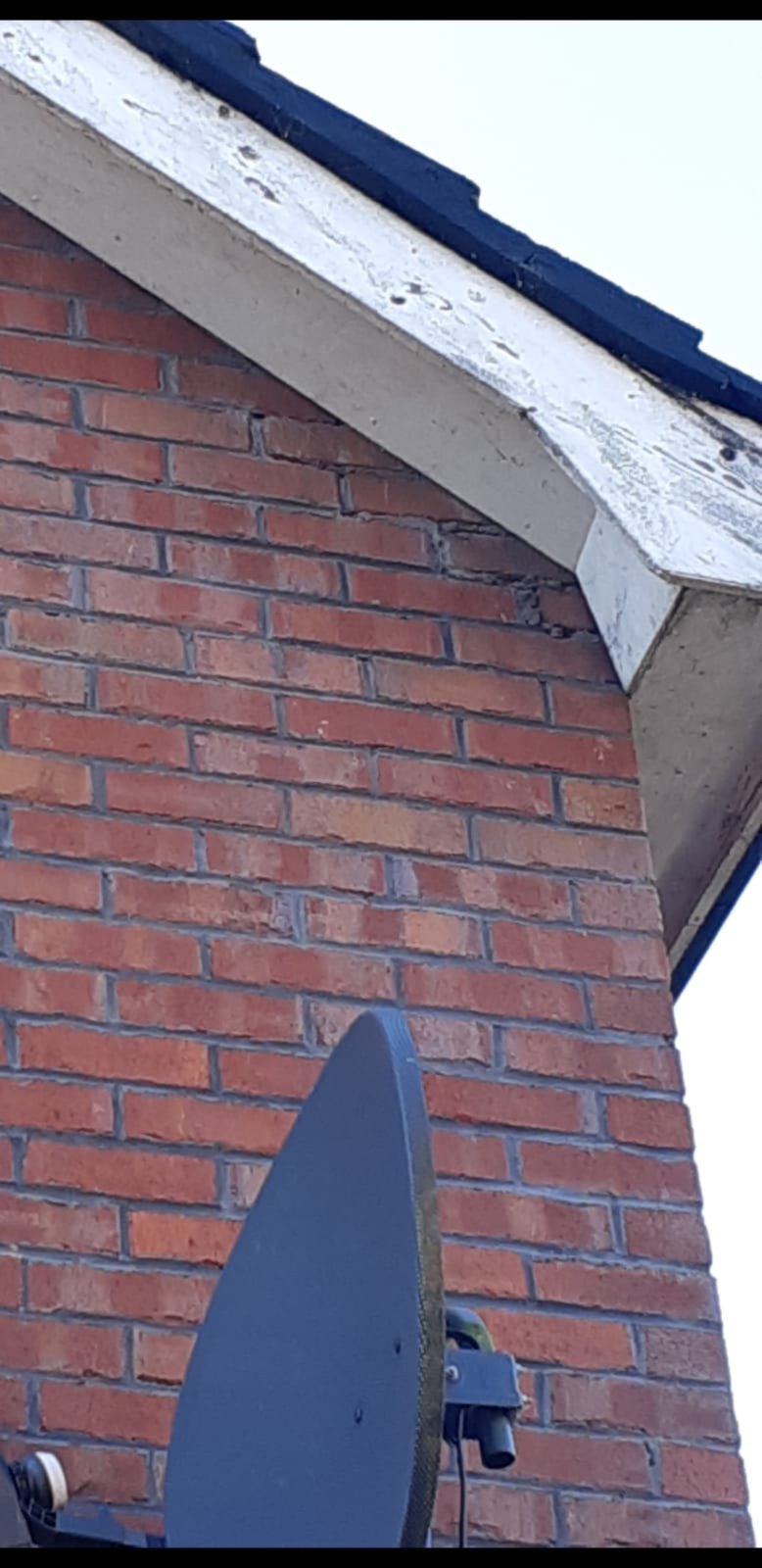

Hi all -
First post on here so please don't be too brutal. Just looking a few opinions/bit of insight from anyone more knowledgable.
Have recently noticed the below on an end terrace I own - worried it might be a stepped crack indicating a subsidence/structural issue? House was built 1997 & I've owned for 3 years.
Any thoughts before I go any further would be greatly appreciated!

Hi welcome to the forum.
No thats not subsidence, its just a minor fault in the brickwork up at roof level.
those bricks are the top course of the gable end so they are a bit vulnerable to coming loose -they may have been knocked when built etc.

Thanks for this. There are quite a few cracks around the interior of the house in different places as well. I'll maybe post them in here too just to double check - at the expense of rude comments like the first response on this no doubt.
Thanks for the reply though. To me it looked initially like a repointing issue. Then realised the possible stepped appearance and thought maybe it could be a stepped subsidence or structural crack in the mortar? Still not sure how them being knocked would have cracked the mortar that way but reassuring to hear it doesn't scream of subsidence!

Its more to do with the type of brick Woods and the method of pointing chosen. When you have a high suction/irregular arrissed brick, you have to think about the method of pointing that least shows off the irregularities.
Bar jointing those type always results in wavy joints. We usually go for flush pointing like on this job...
Would agree with that. They look like Tumbled bricks.
