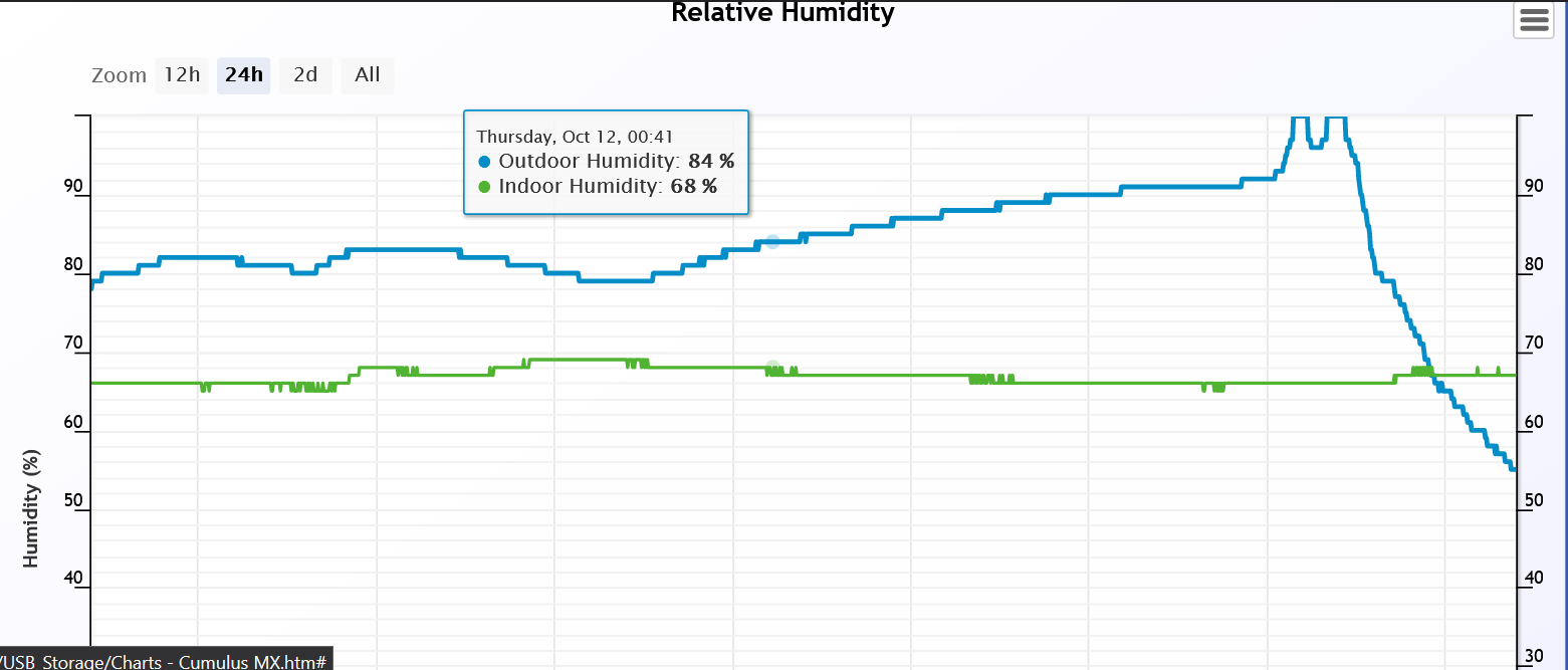

I consider my home normal, to good, for moisture, but last night and this morning there was a trace of condensation at the bottoms of my DG glass. I think it's unavoidable, with the warmth we have had recently, followed by last night's cold snap.
My indoor humidity was similar to yours. Below is my record, for the past 24 hours, blue outdoor, green indoor. Note the slight increase in indoor humidity, just before the second vertical line, which was at 6pm yesterday - that was when the cooking of dinner began. The second kick up, two hours later, was due to a bath being drawn, followed by a gradual reduction, until this morning's activity. I think it's unavoidable, that the humidity should sometimes increase.
We still not had any central heating on, since the summer, though we have turned the living room gas fire on a couple of evenings.
