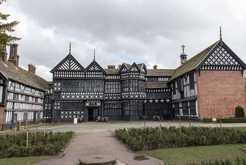

This is one down the road from us. Oldest parts are 14thC.
Surprisingly, it was to be demolished if no acceptable offers were received when put up for auction in 1925. The then neighbouring Stockport County Council made an offer but it was rejected.
No offers were received, but the president of Manchester United offered to buy it for £15K. In 1935 his widow sold it to the local council for £14K on the understanding that the house and remaining 70 acres of grounds be opened to the public.
