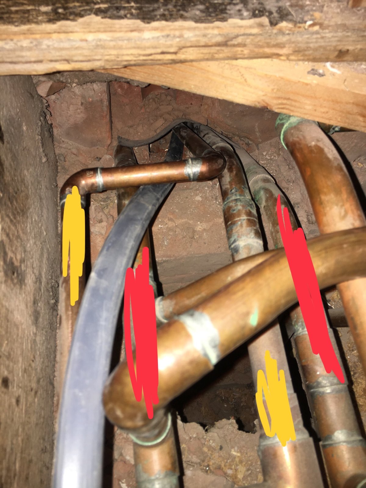

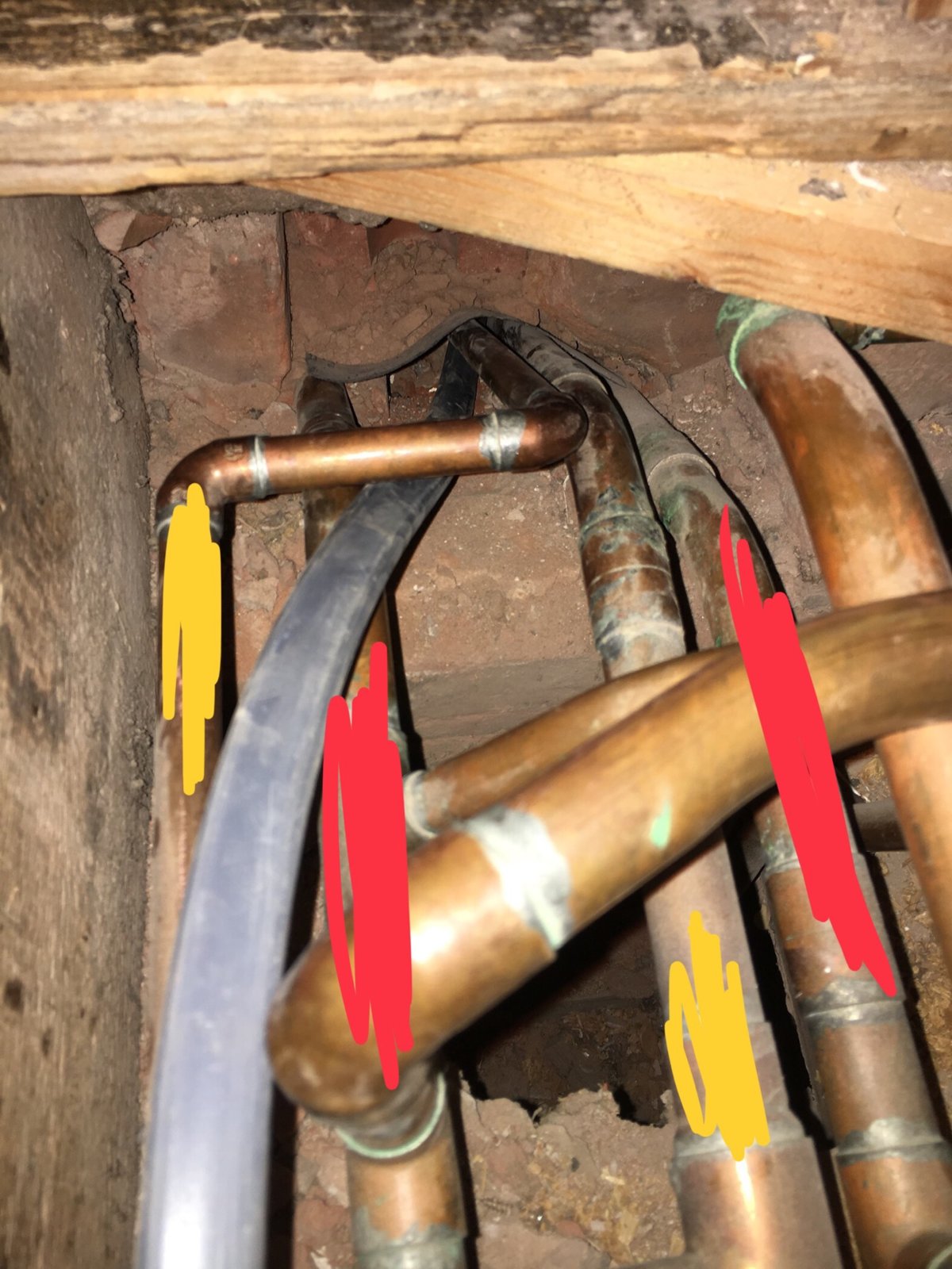

Soooo .... I headed the advice on here and just got the spark in to run the cables. I helped him get boards up etc but as directed let him design and choose the route for the 16mm cable.
It’s a 25m run but aboit half way he’s poked through a hole and run the cable aside some heating pipes. Looking at the run he didn’t have any other options short of taking a ceiling down.
So I’ve got a 6inch section touching / right next to the heating pipes.
Your thoughts please gents (and ladies if we have any).
Also, what temperature do you run the heating at ? Older systems regularly ran at 70˚C or higher - and that's the temperature rating of the cable IIRC :eek: If yours run at a lower temperature then that's better.
As to insulation, well it's a matter of what you can get in. Ideally some insulation foam, but it comes down to what you can get in there without putting a lot of pressure on the cable - just a couple of mm will help, especially if the cable is then against the joist through the hole (the joist will act as something of a heatsink for it).
I see many houses with standard PVC cables sharing/close to/wound round heating pipes without any issues. Not best practice, but sometimes there’s no option.
It crosses the flow pipe on the right as it turns the corner. In the next room
Unfortunately that’s right under a small staircase so I can’t get to it.
Looking in total it probably crosses about an inch...
Flow / return in red
Gaz in yellow
