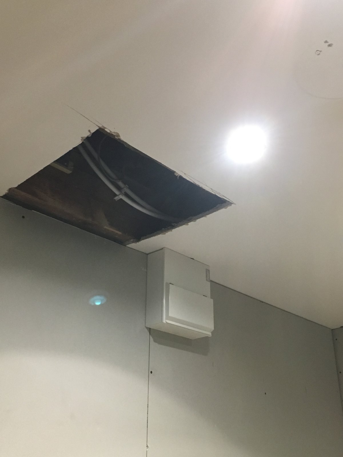

Ok one more question ... sorry for all the anxieties.
The hot / cold feed water pipes run very close to the subboard. I’m not so fussed about it leaking as it’s a continuous length. However the pipe runs pretty much over the top of the top cable feed into the board. I was thinking that condensation might form and drip into the box?
Maybe some lagging is in order?
Your thoughts?

I doubt if that's unusual. The hot pipe will not be a problem, in theory the cold pipe could form condensation and drip. For insulation to stop the condensation, it needs to be impervious to water vapour and be sealed all the way along and at it's ends - otherwise water vapour gets in, saturates the insulation, and eventually starts dripping.
We had that latter problem at a previous job because the contractors didn't install the (quite expensive) Armaflex on the chilled water pipes for the office air conditioning properly (basically never even looked at the instructions). They had to come and take some of it off and replace it - the stuff that came off was well saturated from the inside out.
But one thing that really surprises me is that the new board is installed on a wall which I assume is still the be skimmed. It's more normal to skim the wall before putting stuff on it - you'll have plaster all over the board, and if you ever have to change it, there'll be a hole in the skim with a non-flat border round it.
Thanks for the info ... I looked at some insulation today in B&Q but it said resitsance to fire was euro E which I understand isn’t very resistance at all so im not sure what to buy. I know fire resistance isn’t the intent but I didn’t want to solve one risk with another.
The sparky did say that he could take it off before plaster but I’ll tape it up if not, I’m not fussed about it being changed as I can skim it over if needed.
It’s the first risks I’m concerned about
