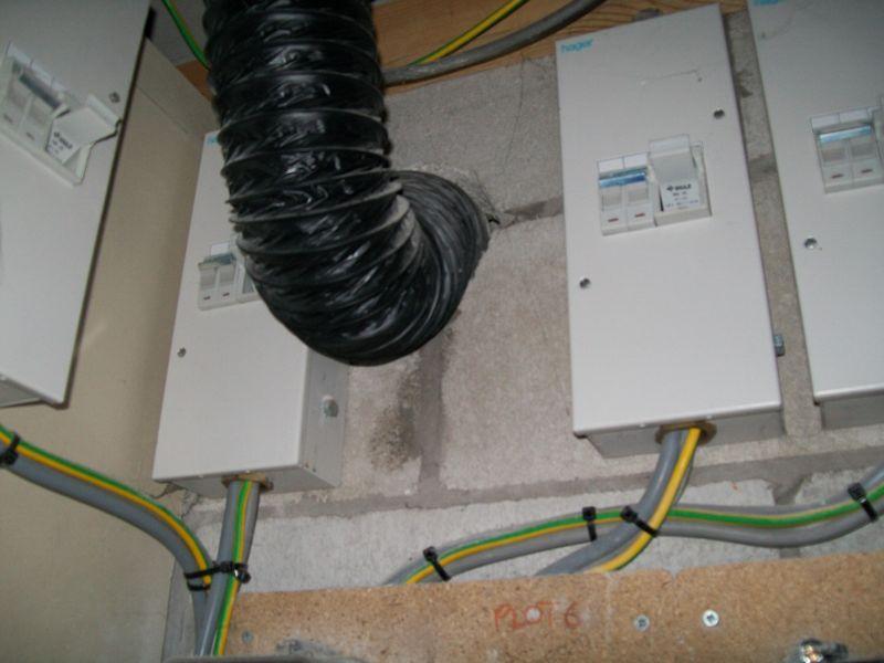

FWIW, I'd agree that it makes more sense to split the tails and use a separate switch fuse. Apart from the issues of taking another 16mm cable into the CU (space, the mechanical load it'll put on what can be quite flimsy internals, etc) - it means the garage supply can be turned off if needed (eg for maintenance) without affecting the "studio". Overall, it needn't look too bad - these are the supply ends of the submains to the flats of which I own one - these are done with 16mm T&E, but SWA could easily be terminated directly into the switch.
