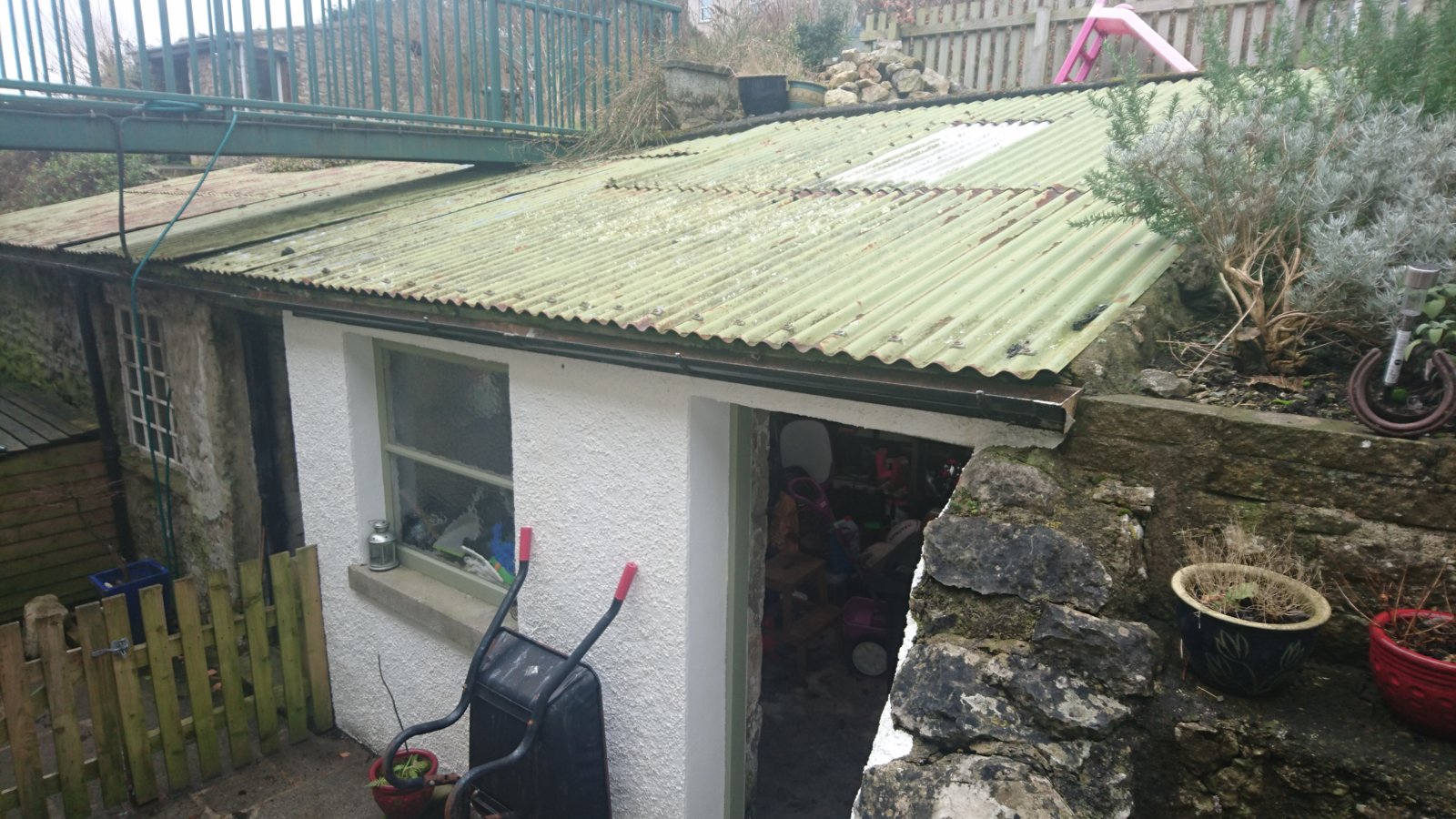

We have an outhouse which is below ground on two sides. The rear wall is effectively a retaining wall to the garden behind. Consequently it's very wet with ground water from the garden coming in through the wall. Construction is concrete floor, limestone rubble walls and a sheet metal roof.
It's used for storage and not a lot else. Given what it would cost to tank it or make it a permanently dry space we are currently thinking we replace the roof and generally clean up the inside.

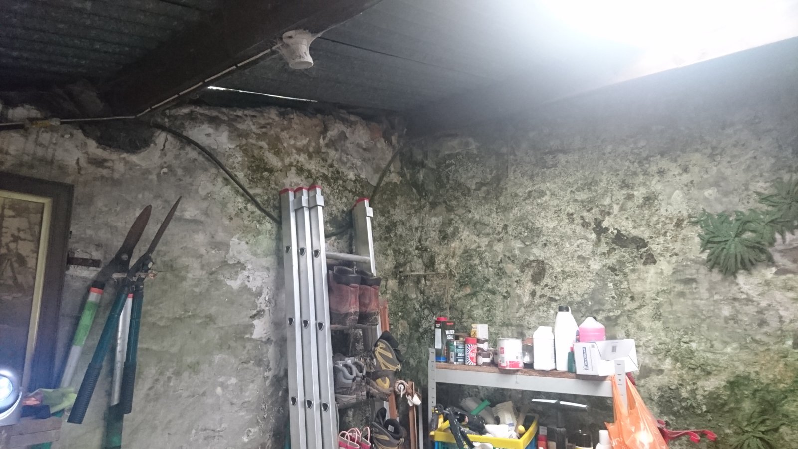

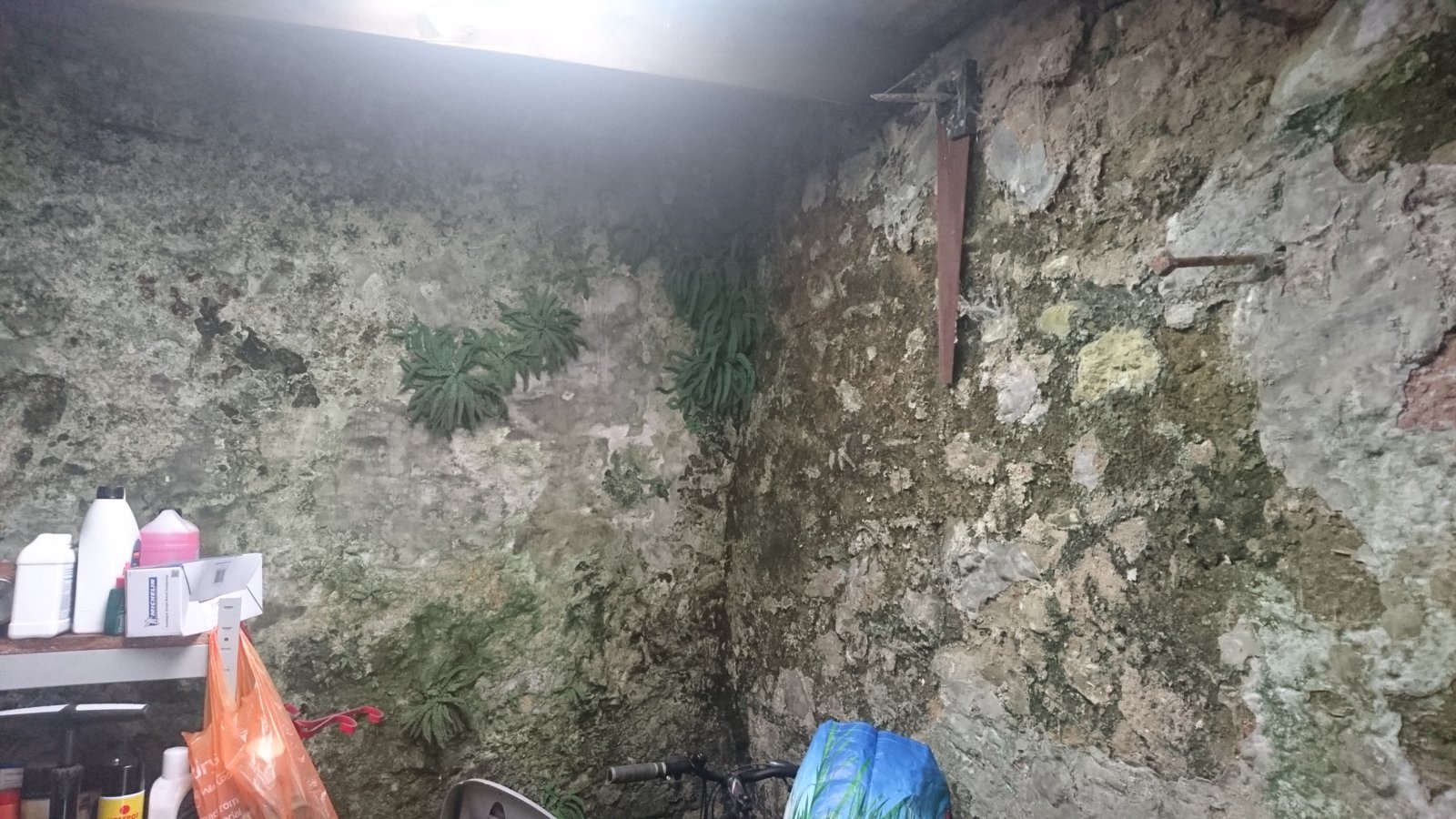

My question then is what suggestions there might be for finishing the internal walls and minimising, mould, algae growth etc on the rear retaining wall. There are the remains of an old coat of lime render which is slowly falling off. Behind this the stone work seems relatively sound.
We want to try to achieve a relatively clean space for storage whilst recognising the limitations of the building and that it's never going to be dry.
Thanks in advance for any suggestions.
I'd turn it into a fernery. Maybe with a transparent polycarbonate roof. Which way is it facing?
Trying to make it "clean" sounds doomed to me.
you could build a new wall inside, with the cavity drained and water running away. The new wall can be tanked on the cavity side, or clad in a waterproof membrane, and you can have a new, dry floor on top of the old one. If water is coming up through the floor you can get special paving slabs called (IIRC) drainage tiles which allows water to run away beneath them.
Why do you want to replace the roof? Doesn't look too bad in the photos?
