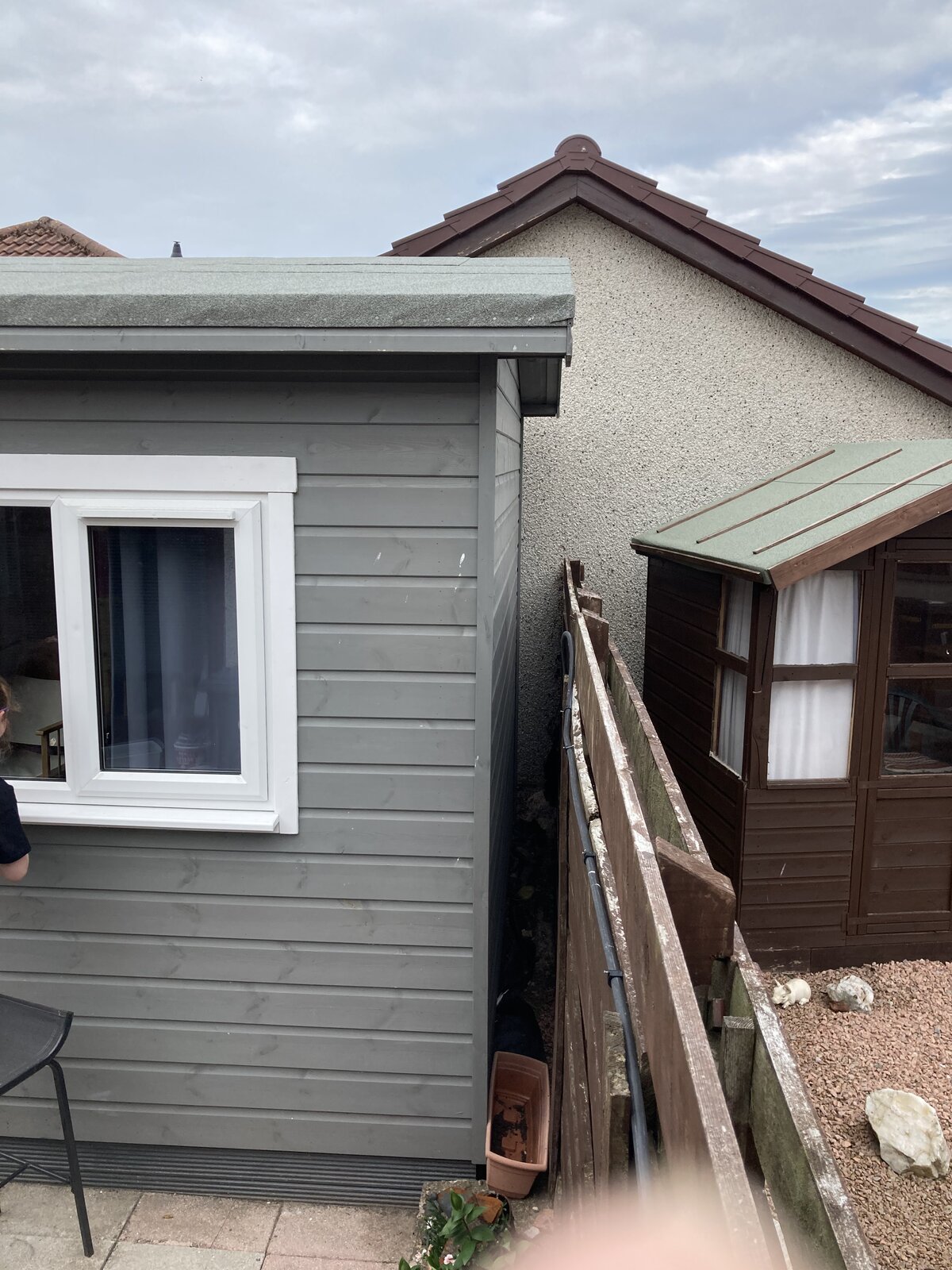

Anyone successfully received Retrospective Planning? We built a summerhouse within 1m of neighbours boundary (rookie error) this is outwith the 2.5m limit - our son is 6foot 9! Did not know of regulations. Within a year of it being built and despite being told we can access garden to paint, our neighbour has complained/reported us. We are in process of doing a pre application check but wondered if there any success stories. No view blocked, no overlooking their garden & no shadow caused.

You could post a sketch or picture of what has been built and ask for comments -there are architects on here who may give their opinion of your chances of success, based on their experience.

300mm over isnt much.
where have you measured the height from? - have you taken it from the highest point of natural ground level?
It’s slightly less from natural ground as ground at fence of boundary slightly higher hence the decking but this was my measurements for enforcement I’ll do accurate ones for application. Enforcement said 2/3cms over they’d process. The recommendation is to move within the 1m which would negate need for planning.
